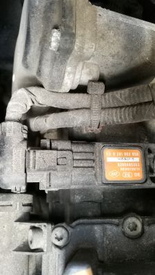

    in my Vivaro suddenly lost power while driving. I plugged in the CLIP and the error DF569 - DEF2 came out, which means that the boost pressure is too low.
    Although the car regained power twice more for several seconds, but now permanently does not turn above 3 thousand revolutions (even at a standstill).
    In the CLIP while driving, unfortunately, the boost pressure is almost identical to the atmospheric pressure despite the fact that the recommended (set) boost pressure is much higher. So the conclusion that there is no boost completely.
    The suspect is the boost pressure sensor - the question is whether a faulty boost pressure sensor can cause such an effect ?
    I second question, is the boost pressure sensor on the M9R 630/692 engine located at the front on the intake manifold (not on the pipe) as in the attached photo ?
    Opel Vivaro 2013 2.0 TDCI 115 - Power drop - pressure sensor and turbo OK Opel Vivaro 2013 2.0 TDCI 115 - Power drop - pressure sensor and turbo OK Opel Vivaro 2013 2.0 TDCI 115 - Power drop - pressure sensor and turbo OK
    In the third photo I marked the pressure regulator, which I checked with the other car where it is also the same and it is working.

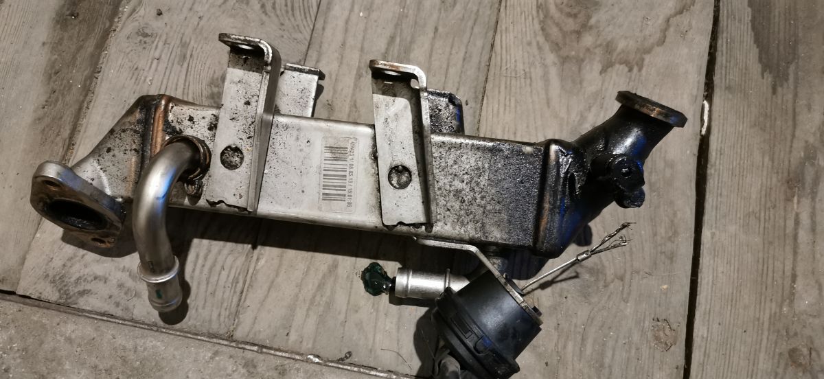

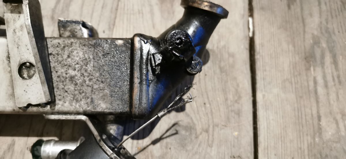

    I think I found the cause of the power drop, "pipe sucking" etc. !!!
    As I wrote replacing the turbo didn't help anything and the pipes didn't hiss anywhere, showed no leaks. Finally I decided to look into the car myself and starting with checking the throttle. As I took off the throttle I noticed that the EGR cooler and more precisely the control of it (steel cable) is broken off (I attach photos). I suppose that this is the problem!
    Now I have a question, because there are two types of EGR sidewalks, optically they differ only in the exit of one pipe of coolant circulation (I attach a photo) are they different in anything else ? I am thinking about welding this pipe from my old radiator.
    Opel Vivaro 2013 2.0 TDCI 115 - Power drop - pressure sensor and turbo OK .

    Well yes, I solved the problem as I wrote in post #28 !
