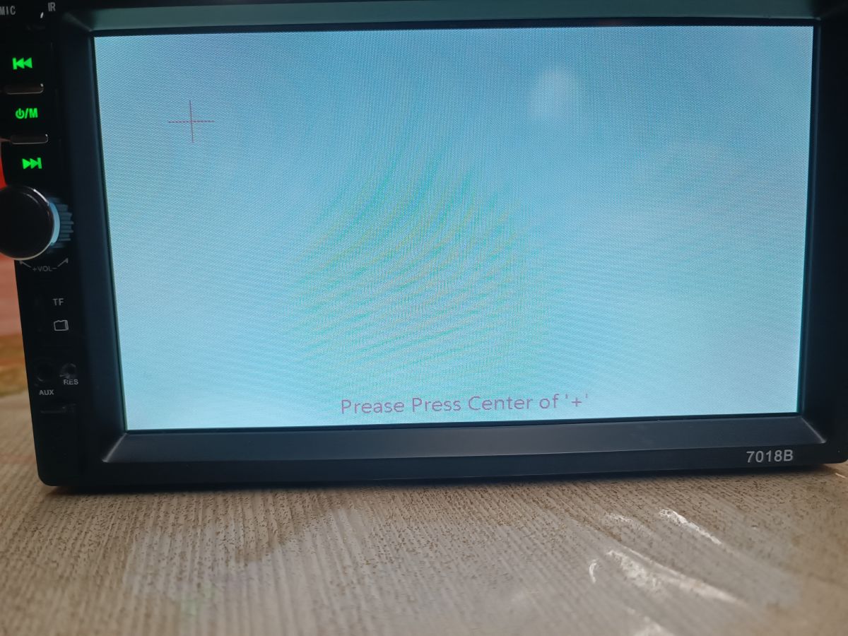

    I bought it brand new and ever since I pulled it out of the package the touch screen hasn't worked. Everything else works just fine. Any ideas or tips on how to fix this issue?

    Car radio 7018B screen with a message asking to press the center of the plus sign. Hi, I have a 7018B car radio. Since I did the update, I couldn't understand anything after the update. I turn it on and it shows me a screen where it says to press the print center + I press it but it doesn't work. If someone could help me and send me a file to fix it

    Check whether the digitizer ribbon (4 pin) is properly seated in the socket, whether it is damaged or crushed and therefore shorted to GND of the radio.
