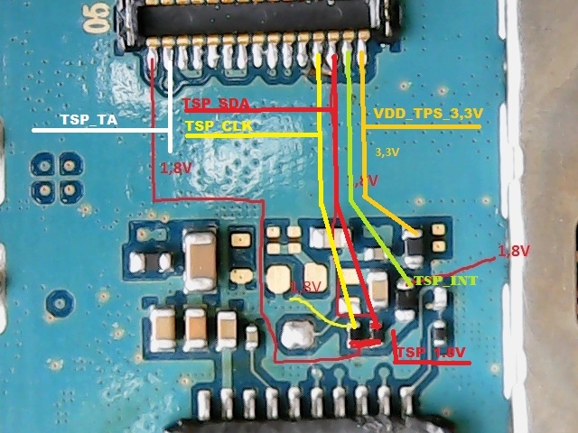

    Hello, how the topic does not work on the Samsung Xcover 3 G388F.
    The touch is functional because after switching to another phone, everything works as it should. The telephone after the fall, was not flooded, no traces of liquid.
    Maybe some of your colleagues have a diagram for this model.

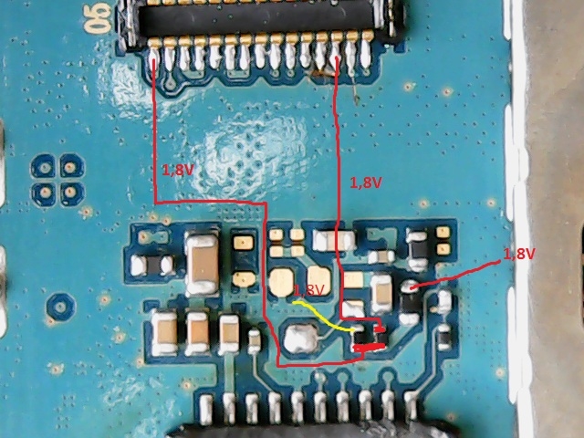

  • #10 16742438
    max_gsm
    Posts: 429
    Rate: 42
    At the request of "marrt" and for everyone who has a similar problem with touch I made a small description. In the photo there are three very important resistors, each of them should have a value of 2.2 KoHm, if one does not, or its resistance changes, then the touch will not move and as I described in the photo on each of them must be 1.8V .
    If there is no such voltage on one of them, then the touch will not move, and umnie is so that everywhere I have a voltage of 1.8 V except in the one where it is marked with a yellow line, for me on the other side of the resistor is only 0.7 V and therefore touch doesn't work. I can't trace where this resistor is going because it looks as if something is occupied and this 1V is lost. If it turns out that there is no voltage at all on any of these resistors then you need to replace one more element that is on the other side of the board. I hope that this description helps someone put a problem with touch, and maybe someone comes to where this resistor is marked in yellow. Samsung Xcover 3 G388F Touch Issue - Non-Working Touchscreen After Fall, Need Diagram
  • #11 16745540
    Glemark1
    GSM specialist
    Posts: 1204
    Help: 190
    Rate: 111
    In the picture I have marked all the lines responsible for touch.
    Resistors are resistors that pull up data lines, clock etc. to power 1.8 in accordance with the I2C bus specification.

    Many thanks to "Glemark1" for the schematic, everything is fine with me and the touch still does not work because the TSP_CLK line voltage on the resistor disappears, instead of 1.8 V I have only 0.7V, I do not know where this line goes because that is the whole problem.

    On the other side of the resistor you will not have 1.8V because there is a generated waveform. Connect the oscilloscope and you'll see. This signal is generated directly by the processor.

    I checked on the second board which is fully functional and is 1.8V on both sides of the resistor and on both.
