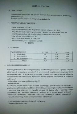

    Hello everyone,
    As in the subject, we have a connection power of 25kW (the house is to be entirely on electricity, i.e. heating, cooking, etc. and 10kW photovoltaics in the spring). The distance from the Enea box to the place where the home switchgear will be is about 95m. Which cable is best to use? I.e. aluminum or copper? And what cut?
    Thank you in advance for your help :)

    Connection 25kW, distance from the box to the house 95m. What cable to use?
    Unfortunately, in the project I did not find information about the layout of the power supply network or about the impedance. Generally, from what I can see in the project, electric heating was not even included. :/
  • #7 18151657
    elpapiotr
    Electrician specialist
    Posts: 12210
    Help: 1015
    Rate: 3530
    Because it clearly says:
    "this study does not contain connections to the building"
    and the WLZ from the cable connector to the building's switchgear is such a connection.
