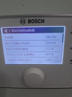

    I wonder what the power limit in the boiler is. It is often read that someone reduced from 24kW to 12kW,
    What does it do? I look at my Junkers Cerapur Smart 5C 24kW boiler with underfloor heating in the CW400 controller and it shows that the minimum power is 12% and usually it works at about 12-20% with this power. What does reducing power to 12kW mean? After all, the minimum boiler power, i.e. the 12%, will not be counted by the controller from 12kW because the boiler modulation is probably 3.4kW and in other boilers of such power usually more.
    What is this all about ?

    What this means is that the boiler starts at the moment of ignition with maximum power, then modulates to low power and increases the power to meet the demand. Now it may be different in new boilers. There is no need for the boiler to run at full capacity every time it is started.
    The maximum boiler power will be 12kW. If the boiler is oversized and too large, it will not work with as much power anyway. However, reducing the boiler power will have a negative impact on domestic hot water heating. If we lower the maximum power for domestic hot water.

    Limitation of max power for CO (because it makes some sense here):
    a) the boiler is quieter (at max power, a condensing boiler is louder than, for example, at half the available power), it matters if you have the boiler, e.g. in the kitchen
    b) slower heating of the central heating system - so that the heating cycles are longer, and thus the comfort and durability of the boiler (smaller cycle times), e.g. in the case of radiators (especially if they are a bit small)
    c) boiler efficiency is best at minimum power, the closer to maximum power, the lower the efficiency - for some time after firing, a throttled boiler operates with better efficiency than if it were running at 100%.
    I also have it throttled to 10KW (from 20KW to central heating)

    If someone has, for example, a domestic hot water tank whose coil has a lower power than the maximum power of the boiler, this power should be adjusted to the power of the coil. If necessary, we lower the maximum power.
    In this case, limiting the maximum power may affect the boiler`s operating characteristics.
    If someone has an ON/OFF room regulator, the regulator does not communicate with the boiler and does not control its power, but only gives a heating signal or turns it off, and the heating process is carried out according to the algorithm that is installed in the built-in electronics that controls the operation of the boiler.
    Currently, boilers have a set start power, i.e. the boiler can start with a defined power but then goes to maximum power and starts modulating if necessary.
    Too high a maximum power may result in the burner not heating smoothly, but sometimes it will heat more strongly, and in a moment it will reduce the power and there will be a sine wave in the boiler`s heating power.
    In my opinion, there is no point in setting the maximum for more than the power needed for frost -20, but ultimately, everyone sets the boiler according to their own needs.
    The practice is that most people leave it as set by the installer and do not change anything because they are afraid and do not know what to set and how to set it.
    And in my opinion, each case should be considered individually, because the maximum power is one thing, but the minimum power of the boiler is important.
    Anyway, everyone has a different sense of what is good and what is bad.
    For example, I was at home where the radiators were clearly humming, which indicated that the pump capacity was too high, but the owner claimed that it was OK and saw no need to change anything. I would immediately change the settings and look for the optimal settings, while someone else doesn`t care and doesn`t care.

    I checked, I set the set temperature in the house at 22` to 23`, after a while the boiler started up with 47% power and immediately it started to drop to 13%. Does it make sense to limit it in my case? What is the power limit in the Junkers Cerapur Smart 5C 24kW boiler?

    Bumble, I see you know less about yourself than I do. So I don`t know if there`s any point in having discussions with you.
    Are you seriously asking how I know how fast the boiler started? Since I posted a photo, you can probably see for yourself. I was standing at the controller, the boiler was not heating, I increased the room temperature and immediately entered the cw400 service mode, there was no flame, the fuel valve was closed, the actual burner power was 0%. After a while, the boiler started, the burner started and the burner power started to increase, it reached 47% and after a while it started to decrease. The boiler has a power of 24 kW. So 47%, let it be about 12kW, with this power it started. Then you ask how I know what time it started?
    Bucks is probably, as you say, zd cw400 controls the power of the boiler, which can be seen during its operation, when the burner turns on if there is a demand for heat.

    CW400 shows what can be read from the boiler, so it is reliable data.
    24kW is the nominal power, i.e. the maximum power of this boiler.
    The minimum is 12%, but you have to approach these percentages with caution, because 12% of 24 is 2.88, and the ZSB24-5C model has a minimum of 3.0kW for 80/60 boiler water, so this 12% is not entirely clear what it comes from is counted.
    This 47% is the actual power of the burner at a given moment, but looking at the discrepancies for 12%, it is difficult to say exactly how much 47% is. I estimate that it is over 12kW.
    Although mathematically 47% of 24 is 11.28.
    Starting power is another parameter, which, as I recall, was most often around 6kW, so the 47% does not have to be starting power.
    These parameters can be set and read on the boiler, but I do not know if the service menu is fully available if we have a CW400 regulator connected.
    If the boiler starts operating at a level of approximately 12kW and then modulates down, then if we limit the power to 10kW, the boiler will start at a maximum of 10kW and then modulate down, unless the regulator settings have a higher priority than the boiler settings.

    Someone put a nonsense sticker saying the burner power was 47%, which had nothing to do with anything. Cw has priority not in all parameters. Although I don`t know because I have fw100. You started a topic wanting an answer and you got it. Most boilers ignite at max power. If you limit it, you will save. But I have no idea. Probably not. But I didn`t buy the oversized cauldron for myself. When it comes to savings, read the topic from the link I provided, maybe you will like it. Besides, I don`t know anything. I just wanted to know what this 47% is. Because if the burner in the boiler has 12 kW, how does the boiler have 24 kW? Bucks didn`t explain this. Have you read the pdf? Parameters. There is no word there. Anyway, it`s not important now.

    rustin wrote:
    Man, I have floor mats, it says in the first post. so there was something wrong with 80/60 degrees Celsius.
    I`m ending discussions with you because it makes no sense
    Read with understanding. The 80/60 parameter is for a boiler power of 24kW. For 50/30, the boiler power is 25kW. 80/60 doesn`t bother the floor fan because you probably have a mixer with a pump and a valve, or maybe it`s a fluke.
    I claim that for a boiler power of 24kW, the maximum burner power is 24kW, full stop, and it cannot be otherwise. The burner is modulated, so power ranges from 4 to 24 kW. Physics. 24kW does not come from the moon. I`m also finishing the discussions and to understand it you have to go back to primary school. The burner power must be greater than the boiler power because there are still losses. I suggest reading, in your case, man, a long read.
    Answer my question: if the burner in the boiler has 12 kW, where does the boiler have 24 kW???

    rustin wrote:
    Who told you that the boiler has a 12kW burner? Who told you the wisdom that you need a mixer just for the floor? Get over yourself and don`t get carried away anymore
    You, my friend, are probably making fun of yourself here.
    Added after 33 [seconds]:
    Added after 50 [seconds]:

  • #30 18217384
    Wojewoda82
    Posts: 968
    Help: 118
    Rate: 392
    The percentage given by the display regarding the current burner power varies from manufacturer to manufacturer. I have a 24KW boiler for hot water and a 20kW for central heating, turned to 10kW for central heating and, for example, for central heating it shows 70% a moment after starting, although it is turned to half of the nominal power. When it goes down to minimum power (5.2KW), it shows 0%. So in my case it shows a little differently. MCR HOME 20/24.. With a maximum power of 10KW it has 100%. I haven`t checked the DHW, but it probably calculates differently there because it has a larger operating range (it`s hard to get more than 30% with the battery open at full capacity and the water at 38 degrees).
    So either the % on the display (of the boiler or the controller) means % of the nominal power (then it will not go to zero when the burner is on) or % of the available burner modulation (it will go to zero). I guess that`s how you have to explain it.
    Now I turned it on specifically for central heating, the boiler fired up at about 70% of the available modulation, i.e. somewhere around 8KW, dropped down to 10% for a moment (i.e. somewhere around 5.5KW) and then spun up to 100%, i.e. 10KW. It took him a total of 20 seconds. So @bumble, your theory that the boiler always starts with max power is a bit off... In many boilers, the max power is limited and the starting power automatically drops to the limited max power (if it was higher). In others, there is a separate regulation of the starting power.
    In my instructions for the installer there is a Fan RPM start parameter (i.e. fan speed, and therefore starting power), which can be changed, page 33:
