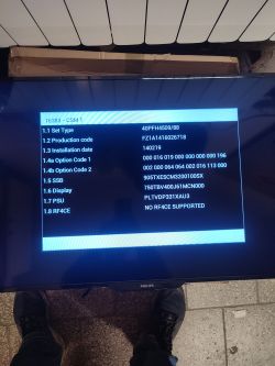

    I have Philips turn ups with logo and stays like that. Tried to put software with usb stick but nothing.
    Does anyone have nand file?
    Model : 40PFH4509/88
    Chassis : TPM 14.1E LA
    Mainboard ; 715G6165-M01-000-005X
    EMMC : THGBMAG5A1JBAIR
    Thanx :)

    Hello. I have the same problem on the Philips 40PFH4509 / 88 TV. Unfortunately, after uploading the file to a pendrive formatted to FAT32, nothing starts. Even after an hour's time. I also tried the option that when the TV is on, I insert a pendrive, the message "reading USB files" pops up and then a black screen remains and still nothing starts. I also tried softy from other electrode threads and nothing works. Am I doing something wrong? After plugging in the power cord, my TV shows the Philips logo and then displays the message "Channel not installed". Can't even turn on the TV with the remote. Only the command to enter 123654 works.
