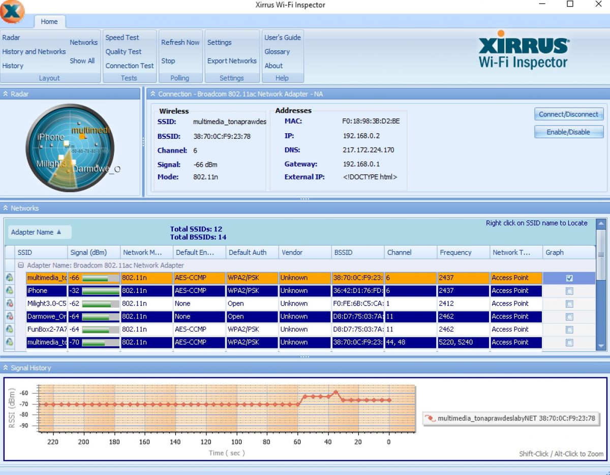

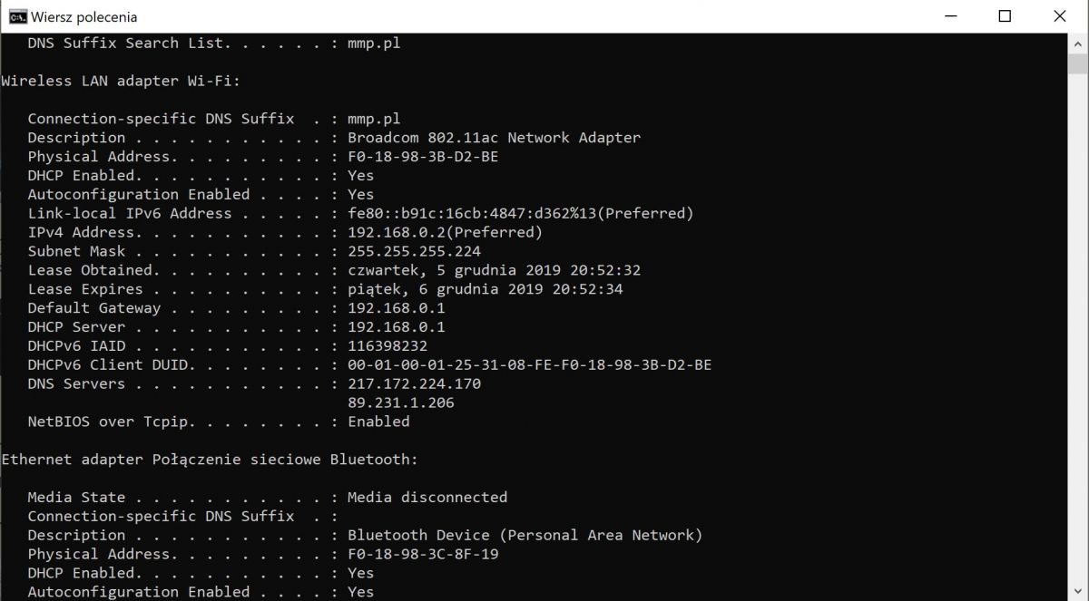

    Wi-Fi
    Best Router for 60Mbps Multimedia Internet: ARRIS-237A Alternatives & Cable Options
    Hands are dropping, even now I had to switch to internet from my phone to reply to the post.

    @loginiarz
    The network works on channel 6 - avoid channels 1, 6 and 11.
    Switch the wifi modem to a different channel.

    And only now I noticed another issue when I move my laptop to the room where the internet modem is starting to work properly.
  • #13 18324163
    tobiaszliszka
    Posts: 22
    Rate: 8
    Here you have the answer, either you live in a block of flats and there is huge interference at 2.4 GHz, or you live in a house and the walls are made of slag, and the slag can suppress the WiFi signal and the cellular signal.
    If you are further from the router, check on the laptop how many lines of range you have, if it drops from 5 to 2 it is a range problem, while if you have 5 or 4 everywhere, it is a problem with interference, and it's a matter of agreeing with the operator to replace the router with a router with two frequency ranges: 2.4GHz and 5GHz. What company do you have your router?

    I live exactly in a block of flats.
    Most often it is 5 dashes, but there are moments when it can drop to two.
    The router is the one for multimedia, i.e. ARRIS-237A broadcasts in both 2.4 and 5 GHz, in my opinion, weak equipment, zero configuration options (only the channel and the name of the network through the mm side).
