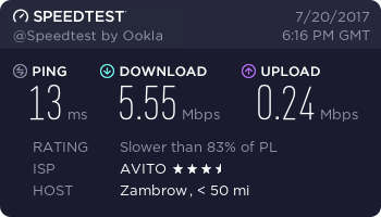

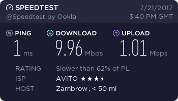

    I checked the speedtest application on the phone and on every floor and even a meter next to the router shows ping 172-175 is probably bad, and the download speed increased from 3.5 to 5 and sending is about 1 everywhere. What the problem is, on the computer it shows ping 12 and download speed 8.9 and upload speed 0.91
  • #11 16571629
    hermes-80
    Posts: 12014
    Help: 1177
    Rate: 741
    The problem is in the interference and retransmission of packets, therefore the ping increases, and such a standard should be up to 20 by obstacles - without up to 10ms. As I already wrote, wifi is two-way communication - so what if you burn a hole in 3 walls with a router, as a laptop will not even break through the wall.

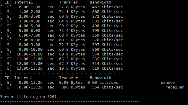

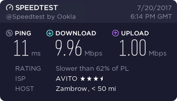

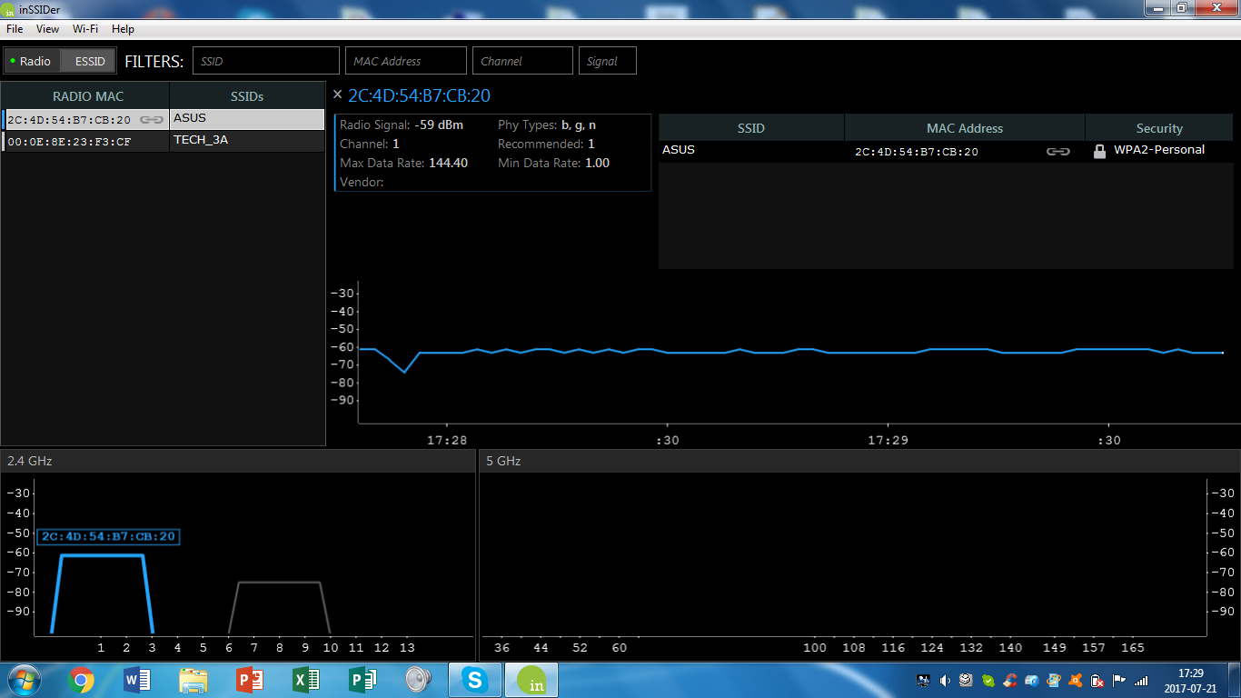

    I bought an Asus RT-AC1200G +, I put it on the 1st floor next to the stairs and the range is good on the 1st floor and the ground floor, there is only a strange stability problem, the laptop is 5m from the router and has quite significant speed drops, here the speed within a minute on the cable:
    Router Recommendations for Large House: TP-LINK AC1750 Archer C7 vs TP-LINK Archer C1200?
    and on wifi:
    I have 14 days to return the router, it is quite expensive, so I would like to evaluate it, because it is rather a problem with the router than with the provider, since the speed is constant and there are no drops after the kalbu. So what other / better router do you recommend?
  • #19 16600188
    bogiebog
    Posts: 24793
    Help: 2569
    Rate: 1528

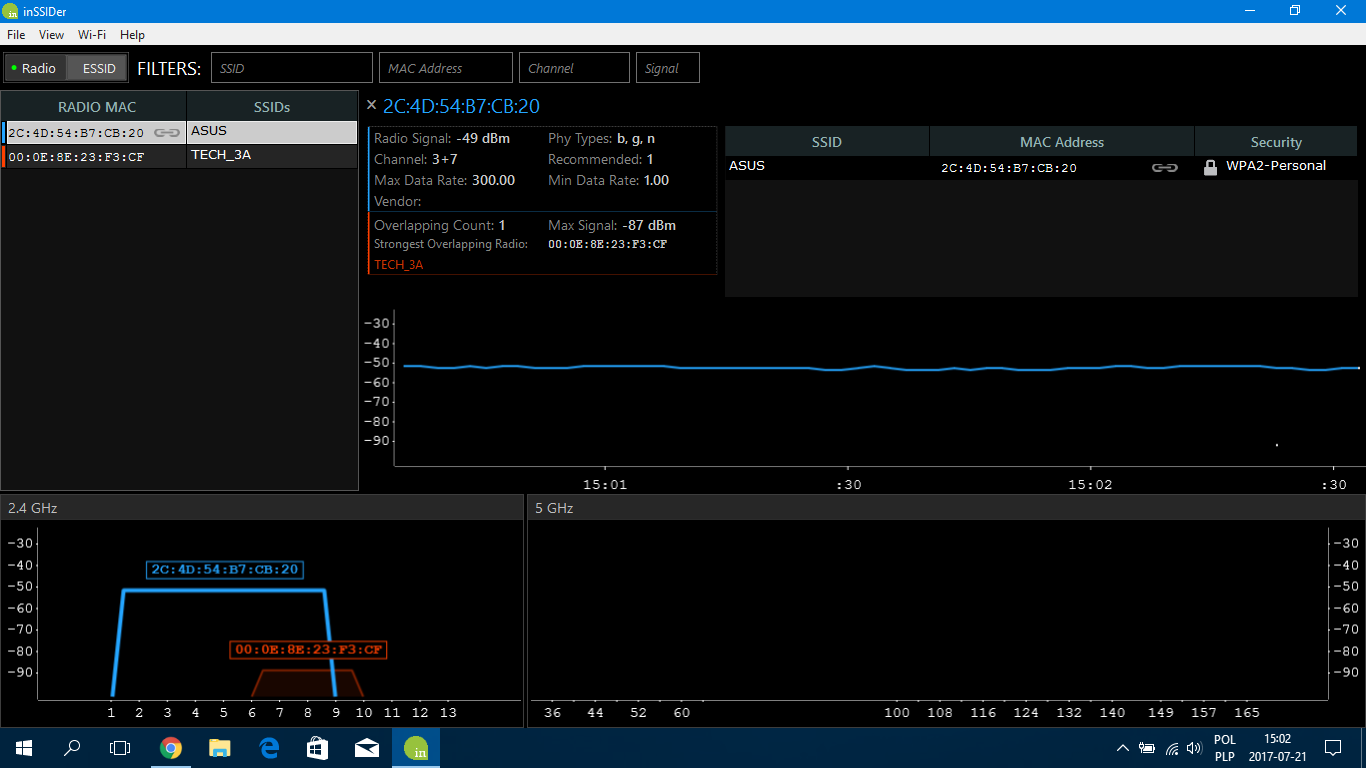

    Show inssider scan 2.x.
    Use iperf.exe for wifi speed test,
    - comp1 connect with a cable, turn off the firewall, run iperf.exe -s
    - comp2 connect via WIFI, run iperf.exe -c ip-address-comp1

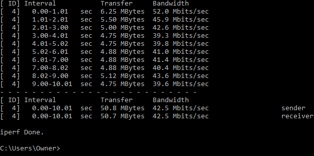

    computer1:
    computer2:
  • #21 16600447
    sebap
    Posts: 7139
    Help: 538
    Rate: 1078
    Since you have a cable speed of around 10Mb / s, change the channel width to 20MHz, you don't need 40MHz.
  • #22 16600460
    bogiebog
    Posts: 24793
    Help: 2569
    Rate: 1528
    no obstructions / walls / ceilings? no ? try with a laptop in the optical visibility of the router. Show iperf stats.
  • #23 16600478
    sebonieb
    Posts: 28
    Rate: 17
    I did the test when two laptops stood 50cm from the router
  • #24 16600504
    bogiebog
    Posts: 24793
    Help: 2569
    Rate: 1528
    Try to swap laptops, let the one with the cable do wifi and vice versa.
  • #25 16600506
    sebonieb

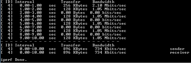

    I swapped computers
  • #28 16600564
    bogiebog
    Posts: 24793
    Help: 2569
    Rate: 1528
    Conclusions dear Watson, conclusions?
    What WIFI card in the wrong laptop?
    Added after 42 [seconds]:
    Get the insider scan from the second laptop.

    This is from the toshiba satellite L755-S5214 computer (here I did a test after replacing computers)
    This is a network card from a toshiba satellite P755-S5215 computer (here I did the test first, it was a server)
    I measured the speeds on wifi at the same time on both computers, as if what has this problem with the network card is ok, on the other, weaker speed. A strange thing, because sometimes it is good, sometimes poorly with speed ...
