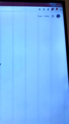

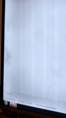

    Hello, I'm going to call the TV service tomorrow, but I don't know if it makes sense. I want to call because on my samsung TV there were stains on the right and left sides of the screen and from the bottom and top in the center of the screen there is a small, poorly lit space and it looks different than the stains that appeared. Give this TV to the service? How much would a possible repair cost?
    I am attaching photos which, however, do not fully reflect the actual condition of the TV because these stripes and rainbow on the screen are not present. I took pictures with my phone and camera and these stripes always appear when taking a picture. I mean whether these stains can be cleaned because I read that it could be dust collecting on the TV. The TV is no longer under warranty. I cleaned the screen and it cannot be cleaned from the outside.

    Stains can be the result of dust. Unfortunately, today's dies are not tight. Unfortunately, these may be so-called "pressure marks", which come from external pressure or internal stresses in the housing. In the second case, I do not see a chance for repair (unless by replacing the matrix), in the first I dare to doubt whether a service will undertake this cleaning. This dust is very difficult to remove from certain layers of the matrix unit.

    The screen is dusty on the inside, but that's not all. The backlight is already worn out, which is manifested by blue spots.
    As for the costs, it depends on what price the service will get a complete LED backlight. I know from my own experience that the original set from the official source is ridiculously expensive.

    There are no blue spots, this TV set is just like that in the pictures. Only in the upper right corner almost invisible purple color.
    I will call you tomorrow, I will ask if the repair of all this does not cost me more than PLN 200-300, I think it is worth fixing.
    I was going to turn this TV on myself and try to clean it, but I'd rather have it serviced than break it even more.

    I gave the TV to the service and I was told that 3 LEDs are burnt and the others are in bad condition, which is why these stains are present. For cleaning and replacing all the LEDs, they asked for PLN 200 along with the labor.

    I picked up the TV and it turns out that only 1 stain was from dust in the lower left corner and the rest appeared through burnt LEDs. The LEDs have all been replaced and the dust stain has been cleaned. I paid 200 zlotys and after connecting the TV I find it was worth it because there is no trace of the stains. Regards and thanks for your help.
