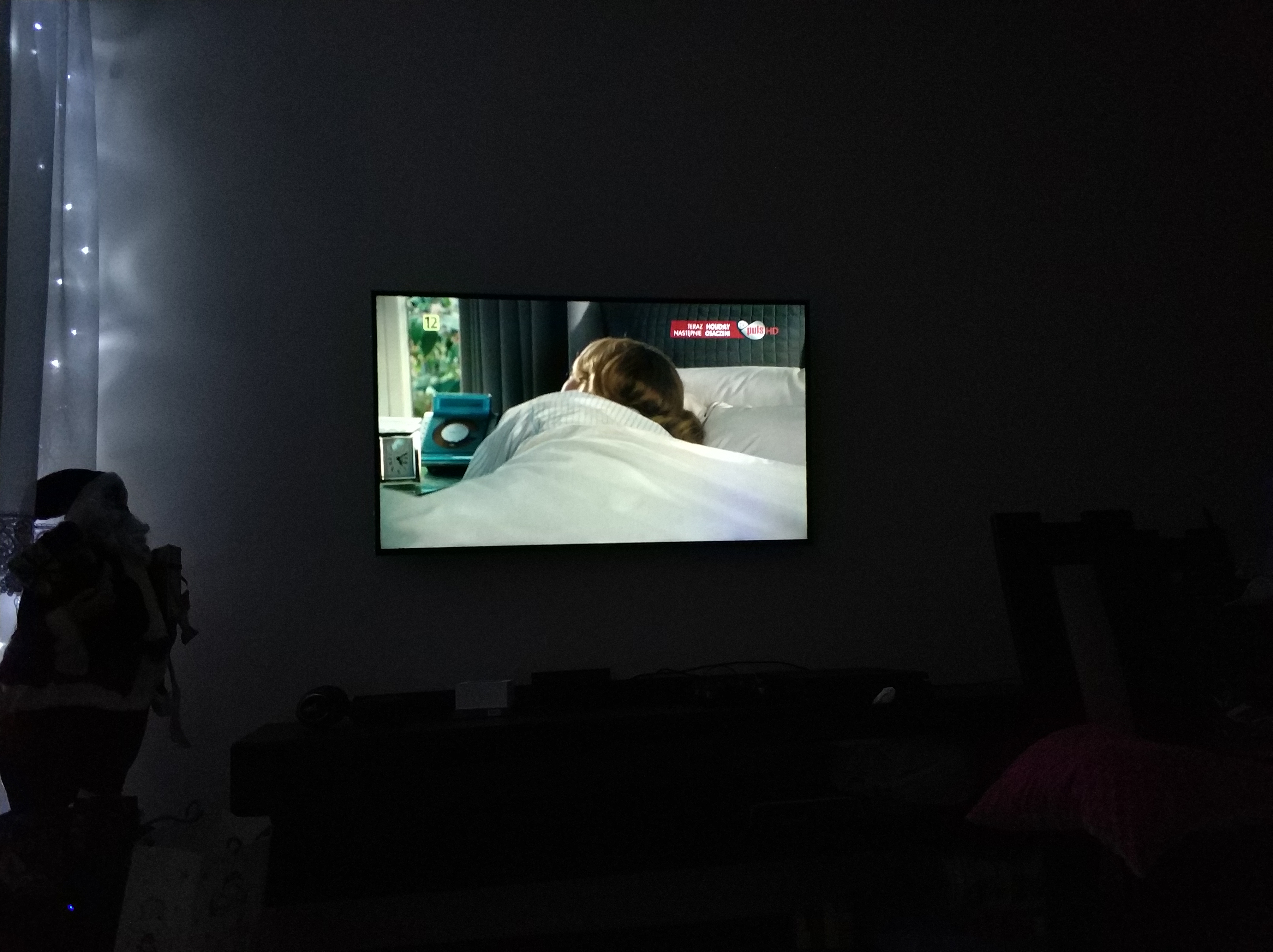

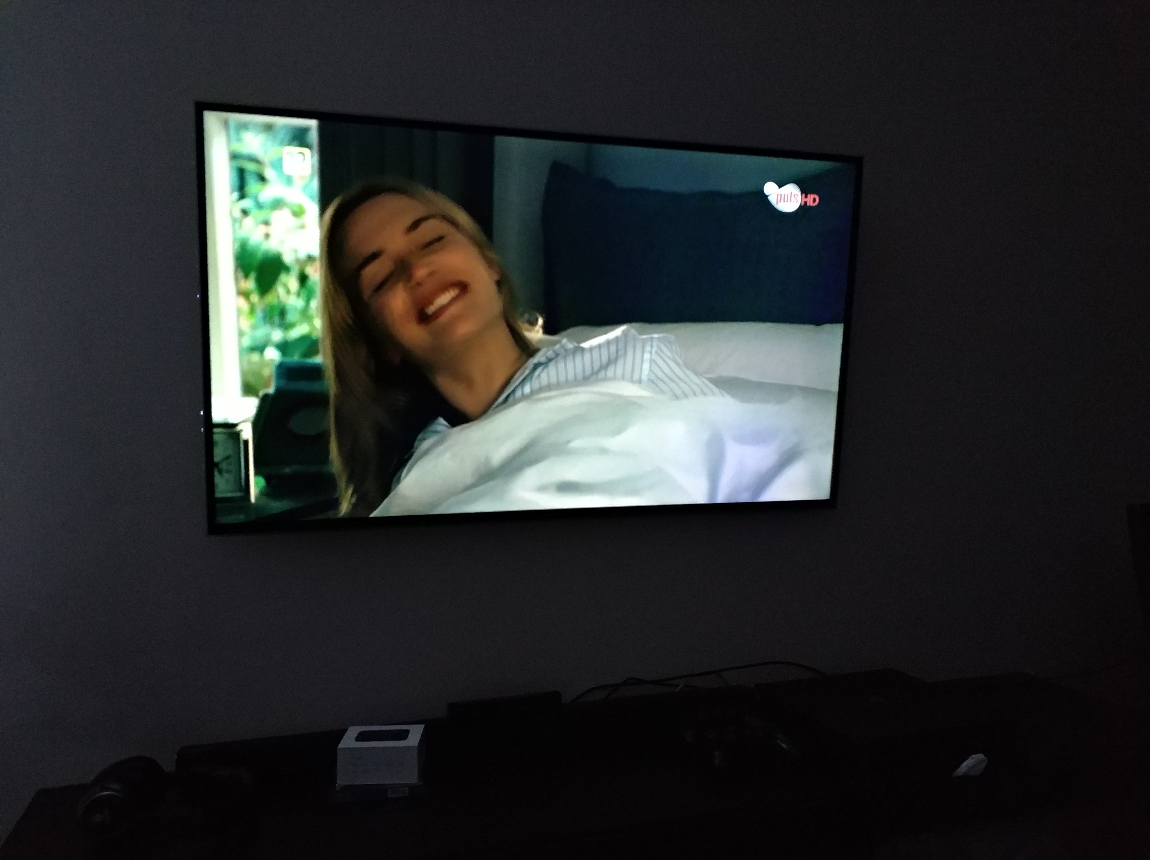

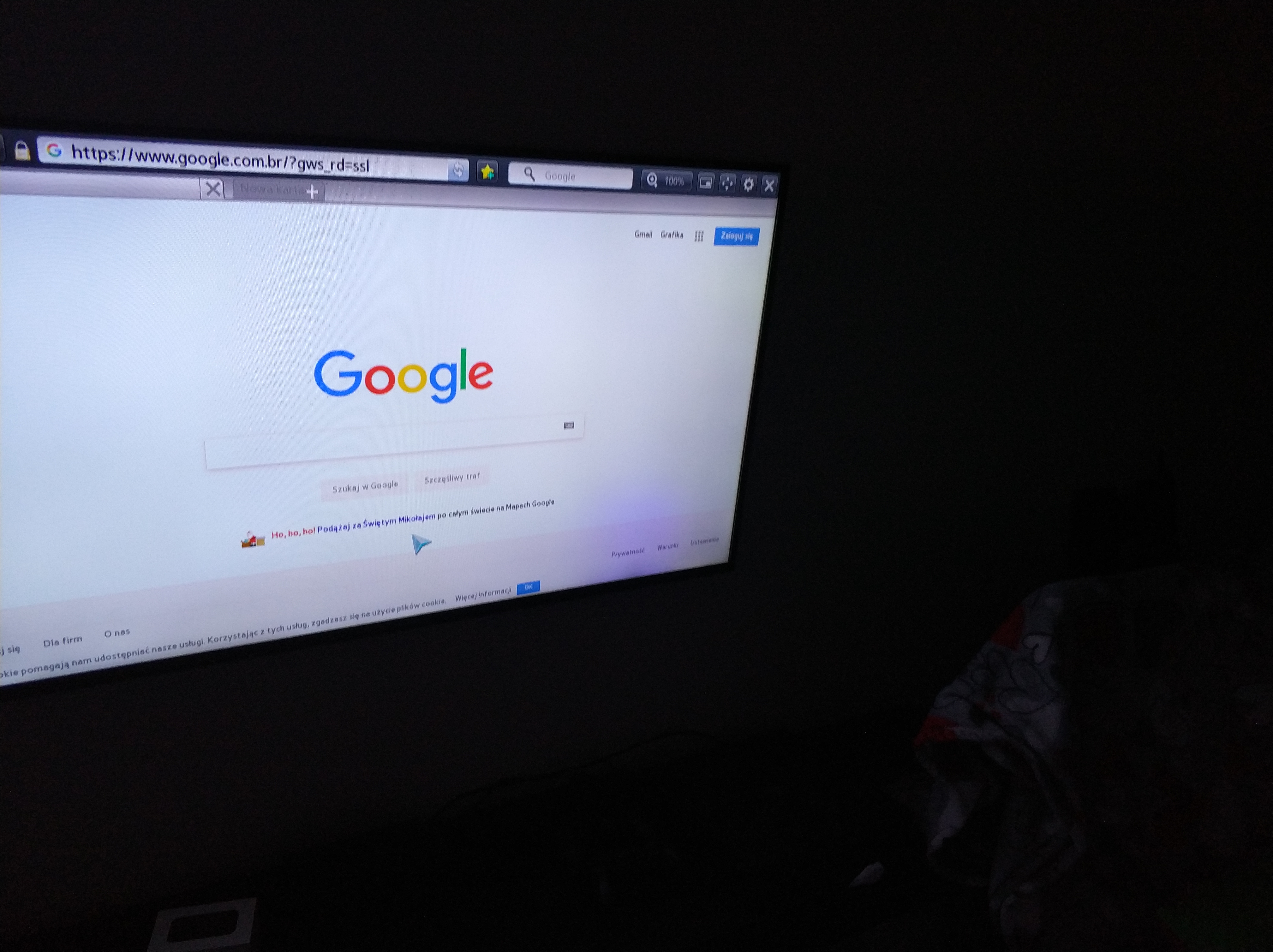

    Hello, today I have a purple spot (glow) in one place. Can you fix it yourself?
    Is this backlight? Some dust? Is the whole matrix to be replaced?
    Moderated By Mirek Z.:
    We do not give unnecessary / incorrect spaces before punctuation marks, such as question marks - I corrected. https://www.elektroda.pl/rtvforum/faq.php - p. 3.1.13.
    • Samsung 48H6400 - Purple Spot Issue: DIY Fixes, Backlight, Dust, or Matrix Replacement? IMG_20171224_203524.jpg (3.79 MB) You must be logged in to download this attachment.
    • Samsung 48H6400 - Purple Spot Issue: DIY Fixes, Backlight, Dust, or Matrix Replacement? IMG_20171224_204509_HHT.jpg (3.76 MB) You must be logged in to download this attachment.
    • Samsung 48H6400 - Purple Spot Issue: DIY Fixes, Backlight, Dust, or Matrix Replacement? IMG_20171224_204500.jpg (3.85 MB) You must be logged in to download this attachment.
  • Assembly stress likely caused the purple spot

    Unfortunately, today everything is done quickly and cheaply.
    And here they let me know about assembly errors, inaccuracies, etc. negligence in production.
    I don't think it was the backlight fault or similar electronics damage.
    They probably let themselves be known about the stresses and inaccuracies of the assembly. Rather irreparable on its own.
    If the TV is under warranty, I would fight for it. If not, I would learn to live with it.

    In my 3-year-old Samsung, there was also a fillet stain in the upper left corner (which can be seen). Well-maintained TV, not struck. Recently I approached the speaker about 60 cm. But the LCD probably is resistant to it.
    So nothing will be done about it?
    I contrasted the photo slightly
    Regards Grzesiek

    I gave the TV to my mother, she does not see this stain, but recently, when I had a Samsung service technician, I told him about this problem, he said that it could be a filter on the backlight diode.
