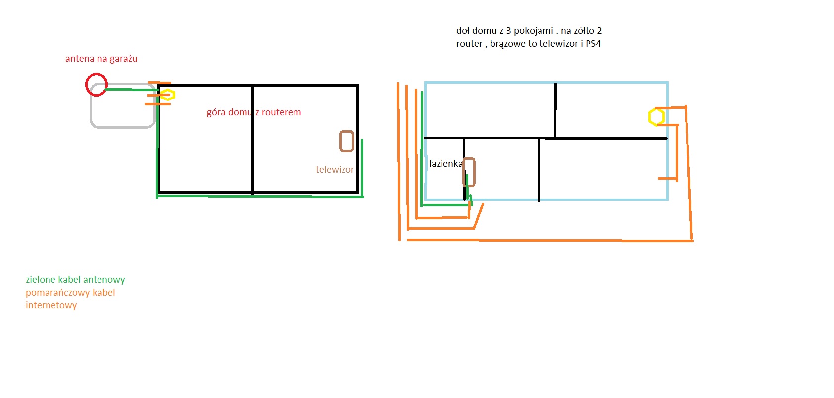

    Wanted to ask for advice - maybe someone has already done this.
    Namely, I have a house with a ground floor and a first floor on which there is styrofoam with glue and mesh.
    On the first floor there is an internet router with an antenna.
    I also have a router at the bottom - for now it is connected with a cable that goes from the upper router to the bottom. Laid on the floor and slats but on the wall from top to bottom is visible.
    In the spring I will have a façade foreman (he is to rebuild the cavities and paint) and I wanted to lay the internet and antenna cables in styrofoam to the rooms before he comes. In the rooms you want to drill through the floorboards and in the right place behind the medd to go out with the cable.
    Attached is a picture of the house and cables :)
    how best to run such cables - the least invasive.
    Can polystyrene be cut with a knife and insert a cable and the foreman will seal it. It's not supposed to be visible

    I thought so too with this conduit, only it would have to be quite large skin, 5 cables plus a supply for 2 should go there :)
    and will i get the connectors? Because, for example, 2 cables will go to the first room downstairs from the upper router, and the next one will go further, so you have to divide it somehow :)

    Styrofoam wires are a bad idea at all, and without additional insulation of a corrugated pipe, these wires - especially the antenna ones - will last you there for 2-3 years and then crumble to dust (poor quality screen).

    Wires can be run outside and polystyrene. Structurally, the Styrofoam itself will not be damaged. The cables MUST be external (black coating, gel inside the cable), otherwise, after a few years, the transmission parameters will deteriorate significantly and the cables will need to be replaced. Of course, cables from the top shelf.
    Pipes should not be run under the façade (or anywhere else in changing environmental conditions), because water will begin to condense in them (especially that the dew point with properly made insulation should occur somewhere in the polystyrene foam. Water will constantly drip from such pipes, destroying the wires and facade.
    Now the most important thing - the wires are laid in front of the polystyrene. If you cut styrofoam and mesh now, it's 100% impossible to repair such damage. After a few years, the putz will crack in this place. Even if the styrofoam master denied that something like this would not happen, you can always see the scars on the wall after a few years. If you want to run these wires, you need to make two holes in the polystyrene (top and bottom of the wall) and push a flexible rod between them, so as to crumble some polystyrene near the wall, but without destroying the mesh. Then, through such a puncture, the wires are pulled behind the rod.

    It should be a gel twisted pair.
    The TV wires are also gelled.
    The wires are placed in front of the polystyrene, but if you don't take at least a sketch, photos of where the cable goes on the wall, I'm pretty sure that the wires will be damaged somewhere when anchoring the polystyrene.

    And if I wanted to run the wires in the conduit, but let's say outside, do you have any solution to attach it?
    Rather, it will not stick to the mesh itself, and if it moves, it will crumble.

    dorsz0591 wrote:
    let go in the conduit but let's say outside, do you have any solution to attach it?
    I do not recommend. Since they are still unpainted, cut the mesh, cut out the furrows in the polystyrene and let the cables run in the conduit. Furrows foam, fill, and the foreman will paint.

    But you're thinking, outside the furrows, lay cables, foam, align, cover with a 10 cm mesh for joints and the rest will be done by a facade specialist.
