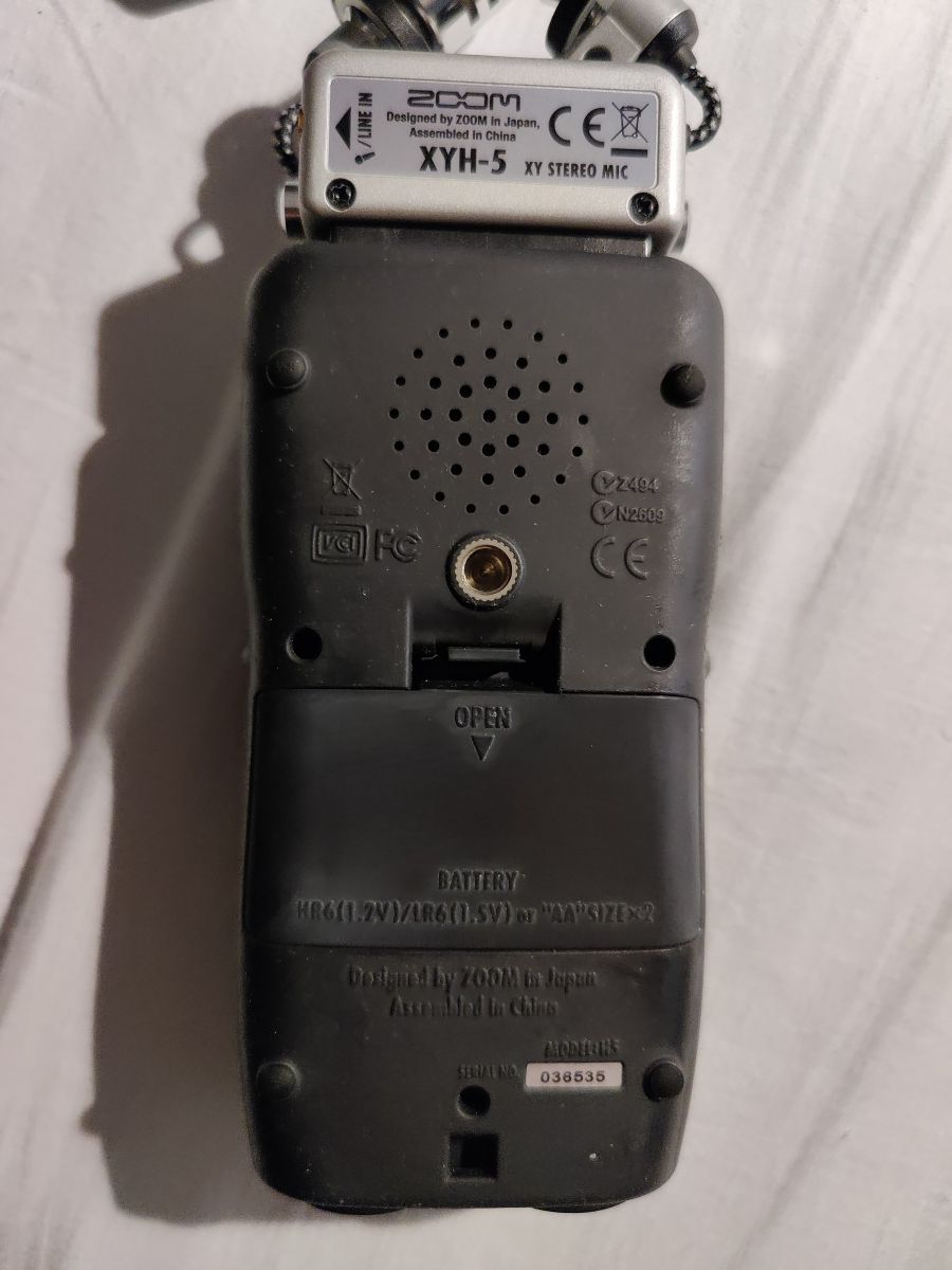

    Good evening everyone,
    I, in turn, have the same problem with the Zoom H5 recorder. The first one gave up with the battery flap, followed by the entire rear housing. The front one is also degenerating (sticky).
    So I would like to thank everyone here for valuable advice, and I will treat the recorder with a cloth soaked in isopropyl alcohol. Some of the subtitles will disappear, but it's hard, something for something. Efficient Methods for Cleaning a Laptop's Rubber Casing - All Suggestions Welcome!
