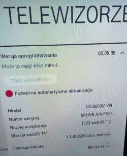

    So the problem is that on my SMART TV LG 47LB650V-ZN suddenly something happened to the YouTube application - the image disappeared. Yesterday everything was ok and today my daughter wanted to watch cartoons and while starting the application a black screen appeared, after a while I pressed "blindly" OK and only the sound appeared.
    In general, when starting the application, the word YouTube with the logo should appear for a short time and this sometimes appears (and then disappears and there is a black screen) and sometimes not. If it appears, it is displayed about 2-3 times longer than usual as if it had some problems with starting.
    The patent with the phone did not even help, i.e. turning on the YouTube video on the phone and clicking the button in the upper right corner and launching the film on the TV application - the effect is the same, the sound is there, the image is missing.
    I deleted cookies in the TV settings.
    I removed the YouTube application itself and reinstalled it, but to no avail.
    TV software version 05.05.35 (I checked on the internet that there is a new version 05.05.70 and my tv model is on the list, but the tv itself is not updated)
    The version of the YouTube application that has been installed is 1.0.70
    I will add that I checked on the second JVC smart TV (bought in 2018) and it works without a problem there.
    Has anyone encountered this type of problem and can share the solution? Any suggestions or hints are welcome.
    Thank you in advance for your help!!

    I am still thinking, maybe try to update the TV soft via a USB flash drive ?? Maybe updating to a higher software will help? Since there is information on the LG website that the latest version 05.05.70 is compatible with my TV model? But why the tv itself does not find an update? On the other hand, are such operations (updating via pendrive) safe? Are there any risks associated with this?

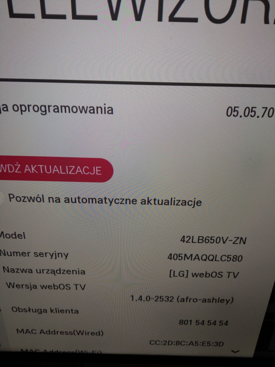

    I have exactly the same symptoms. I haven't found a solution, but I'm working on it as far as the time available. LG Polska Support is not responding.
    It follows that upgrading to 5/5.70 is unlikely to help.

    And you see, you have 05.05.70 and the same problem, so one thing has already been clarified - software update will not help.

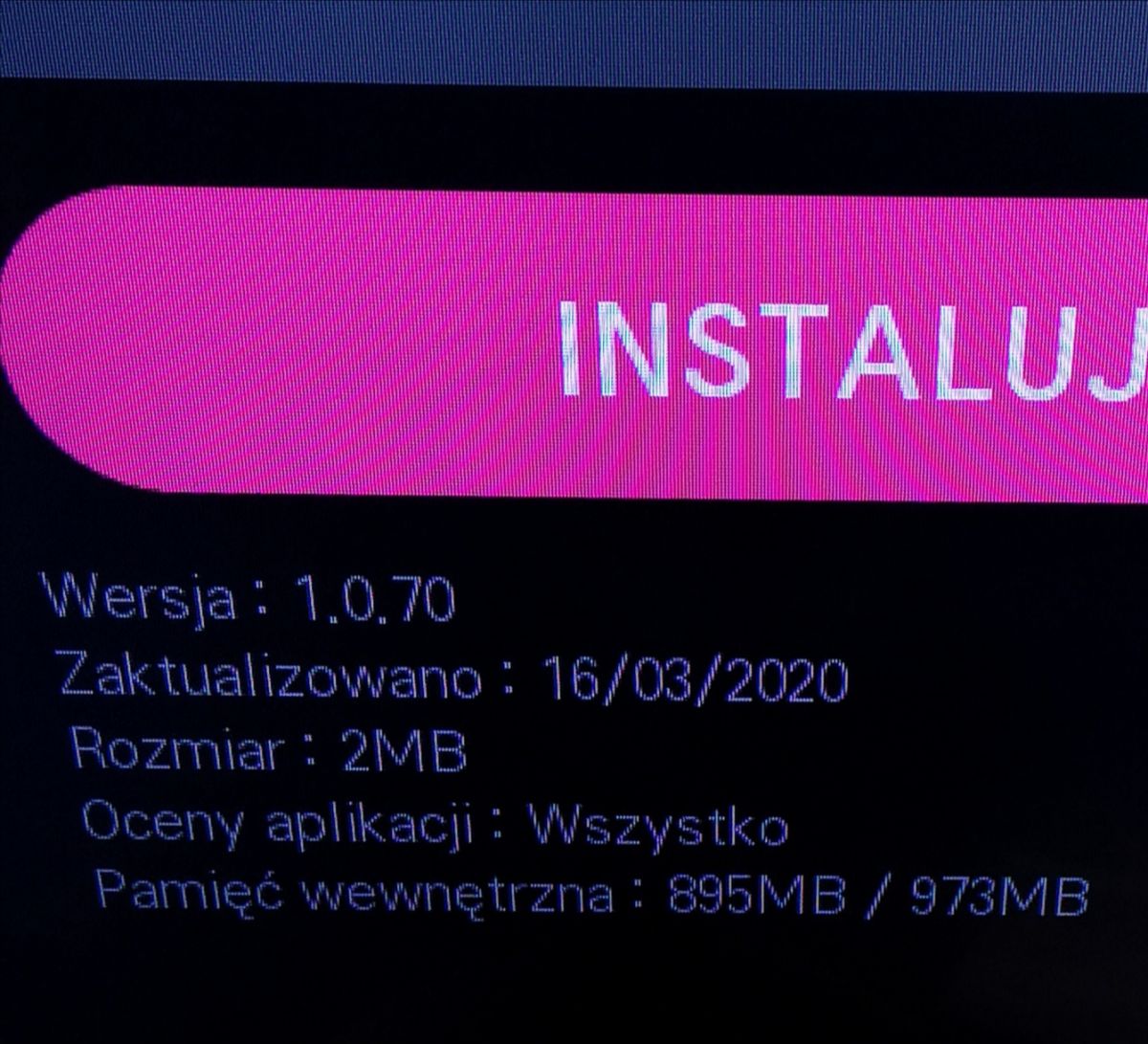

    It was a self-updating of Jutub, no question, at least in my father's case. Go to LG custom support on tv and see when you have YT updates. In the father's case it is update 1.0.70 on March 16.

    update 1.0.70 from March 16.
    in fact for me it is exactly the same. I will try the factory settings tomorrow.
