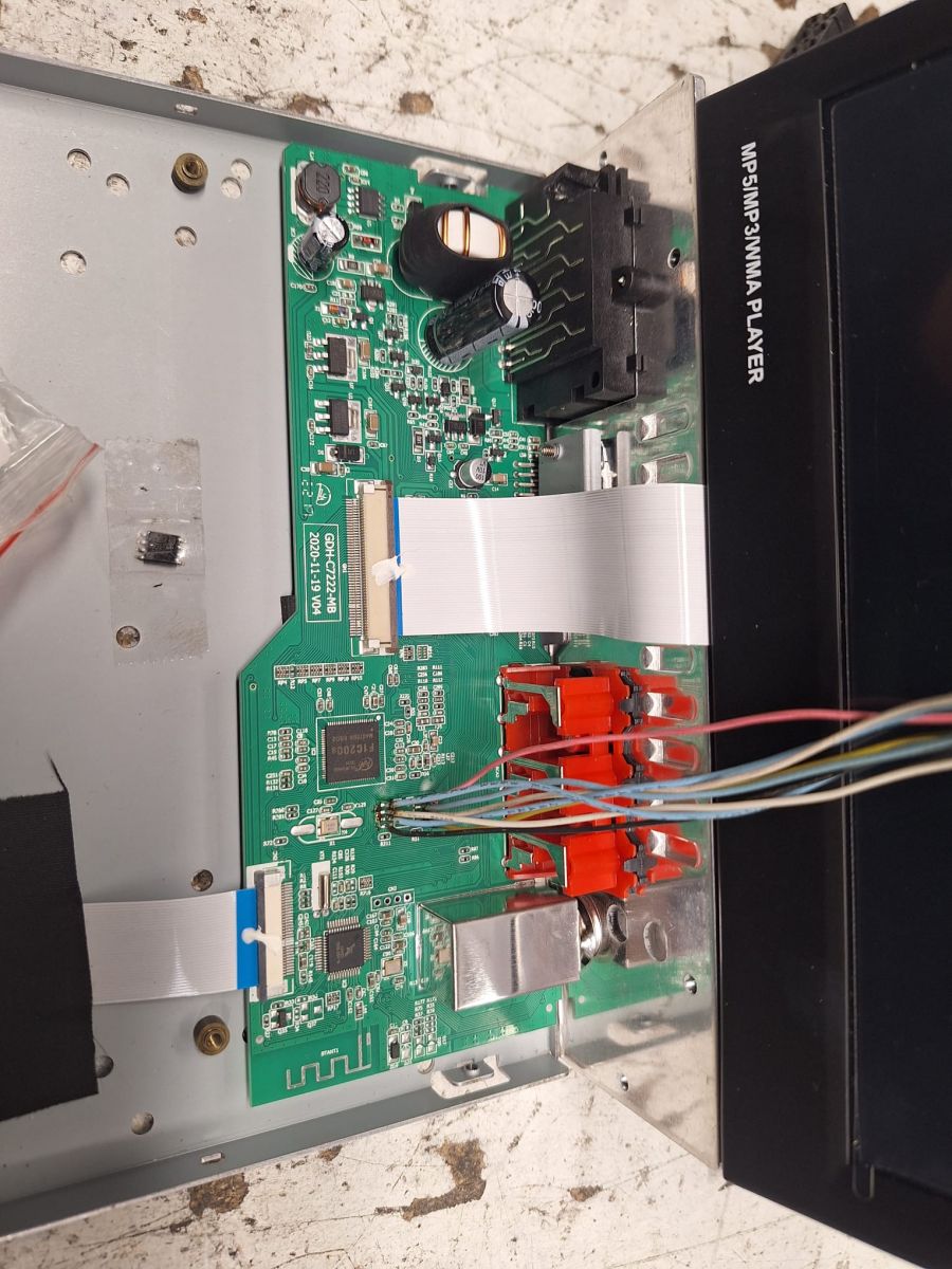

  • #18 21317566
    memish
    Posts: 8
    hello friends,
    I need software for MP5 Player.
    Main board: GDH-C7222-MB.
    Flash: 25L6436 MP5 player motherboard labeled GDH-C7222-MB.
