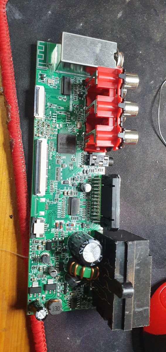

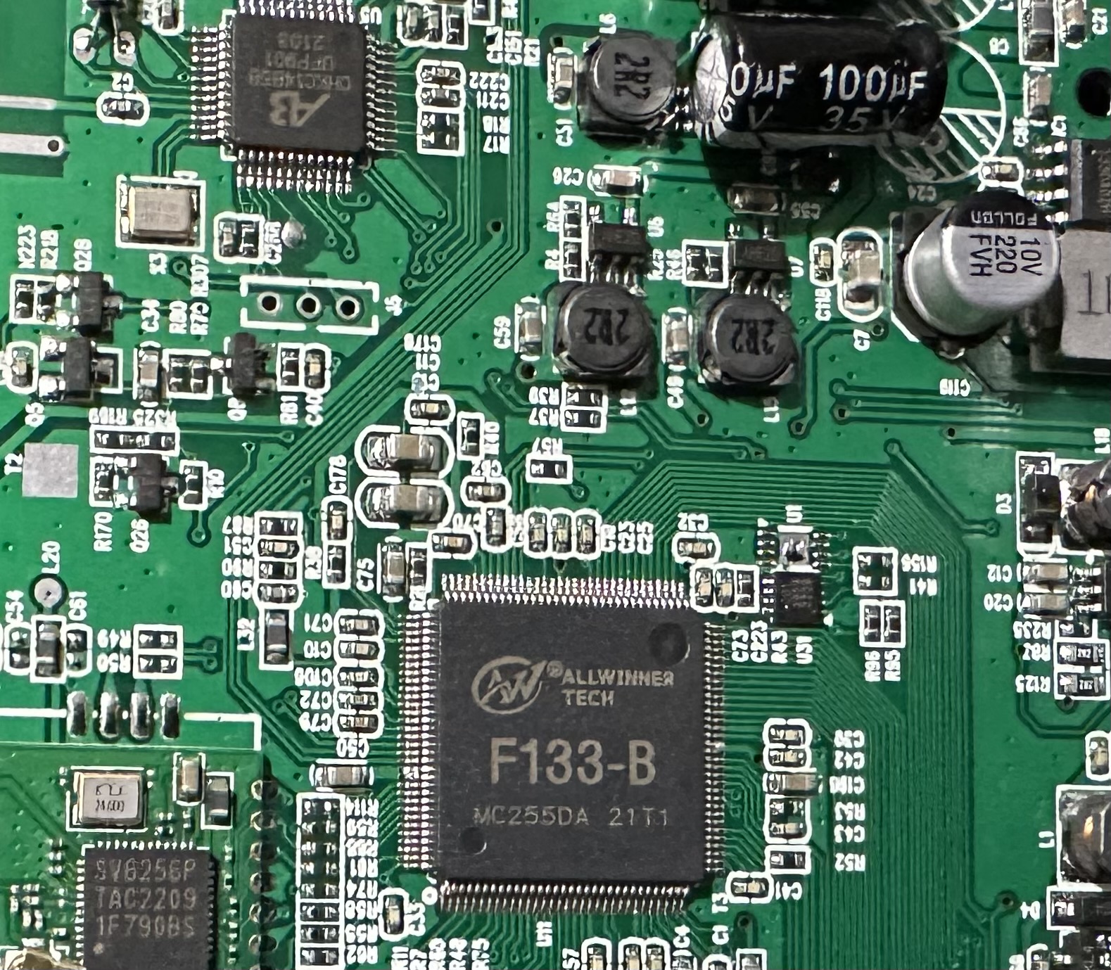

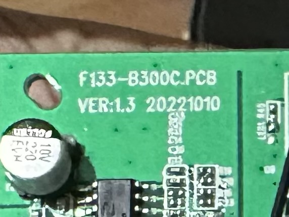

    #9 19927531
    m_damir
    Level 4  
    Try flashing the SPI EEPROM with this bin dump, from working 7010B with F1c2100s chip. Included in the rar is the CRC32 hash value, so be sure to check the bin file hash with Hash My Files, after extraction, just to be sure that the content was not changed in the process of downloading the file.
    Notice: It is a bin dump, not intended to be uploaded to USB stick.
    The board has no part number printed (Notice: EEPROM is removed for flashing, it is a 25L6436F):

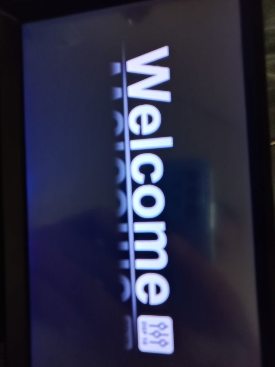

  • #10 20293359
    ychokri7
    hello guys,
    someone help me! I updated my mp5 car player 7010B after finish he performed a reboot the welcome screen after that changed to grey color full screen without any touch screen or button working! how can I do another update or flash if nothing is working on it... does someone have the same problem and solve it...
    heeeelp!!!! heeeelp!!!

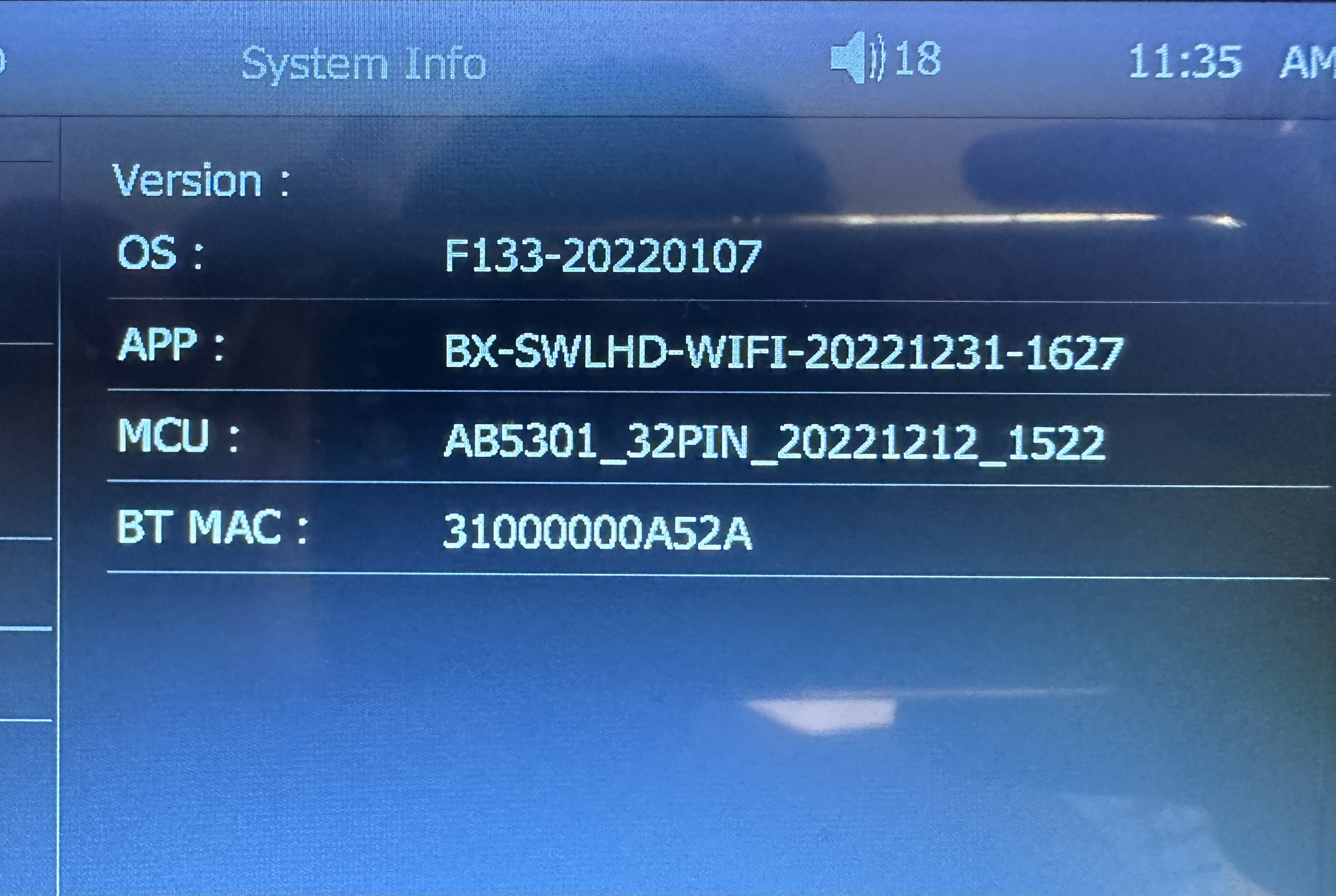

    THIS IS MINE
    7010B
    V7.52BT-FK-TP-P
    MCU V 4.26
    TIME 2019.03-13 115300
    INFO ZCD-7089-6905-P

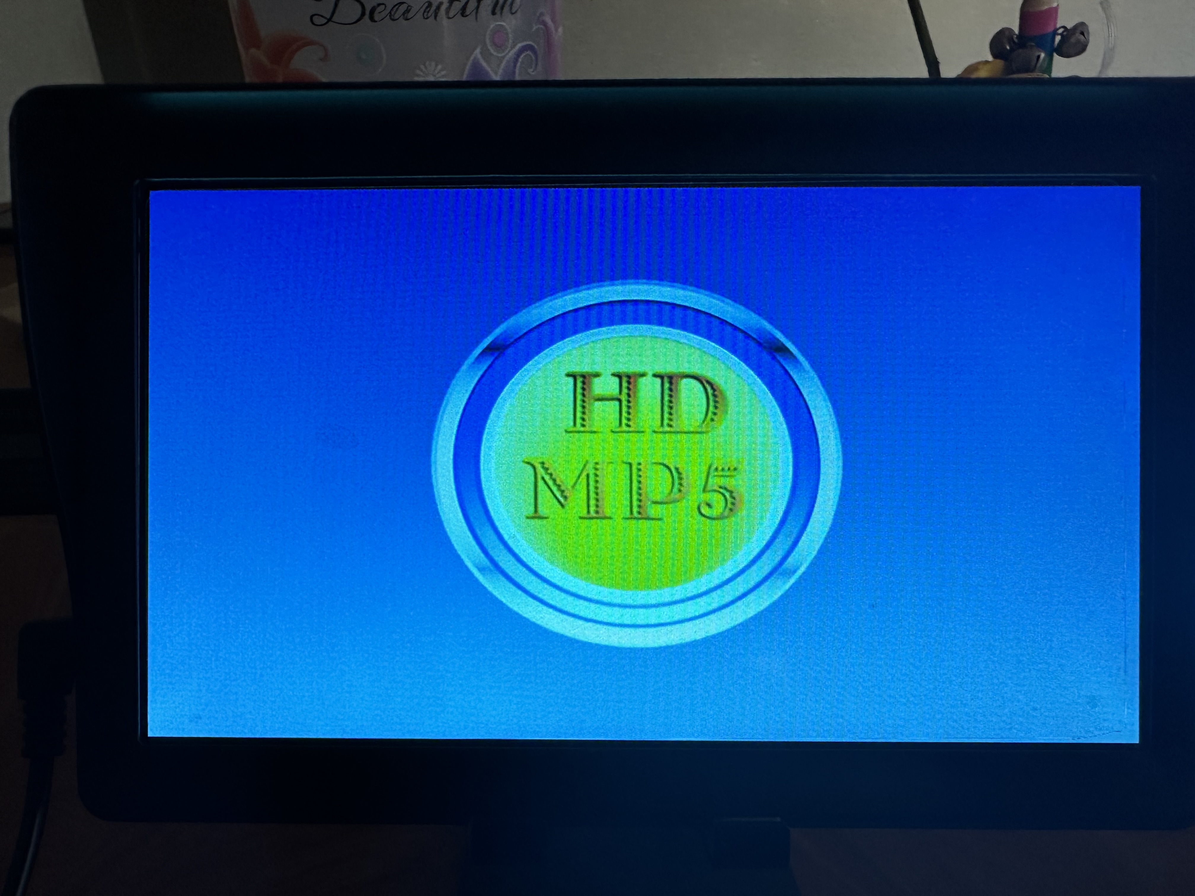

  • #14 20595610
    look4jithesh
    >>19503928
    Can you help me to update or get the firmware for below attached model. I am new to this community and am searching for the firmware. My device working fine. But I wish to add my vehicle boot logo (FORD).
    • mp5 car 7010b - after install new firmware, the device turn on but dont have dis IMG_1027.jpeg (1.76 MB) You must be logged in to download this attachment.
    • mp5 car 7010b - after install new firmware, the device turn on but dont have dis IMG_1026.jpeg (1.29 MB) You must be logged in to download this attachment.
    • mp5 car 7010b - after install new firmware, the device turn on but dont have dis IMG_1114.jpeg (77.13 KB) You must be logged in to download this attachment.
    • mp5 car 7010b - after install new firmware, the device turn on but dont have dis IMG_1116.jpeg (876 KB) You must be logged in to download this attachment.

  • #19 20885388
    xmyrtja9
    7010B
    BT NAME CAR-KIT
    MCU V00.00
    TIME 2020.06.28
    SOFT VERSION: ZCD-7089-6905-APK-11-02
    CAN SOMEONE HELP ME, AFTER INSTALLATION OF THIS SOFTWARE, THERE IS NO SOUND AND THE ON AND OFF BUTTON DOESN'T WORK. CAN SOMEONE HELP. THANKS
