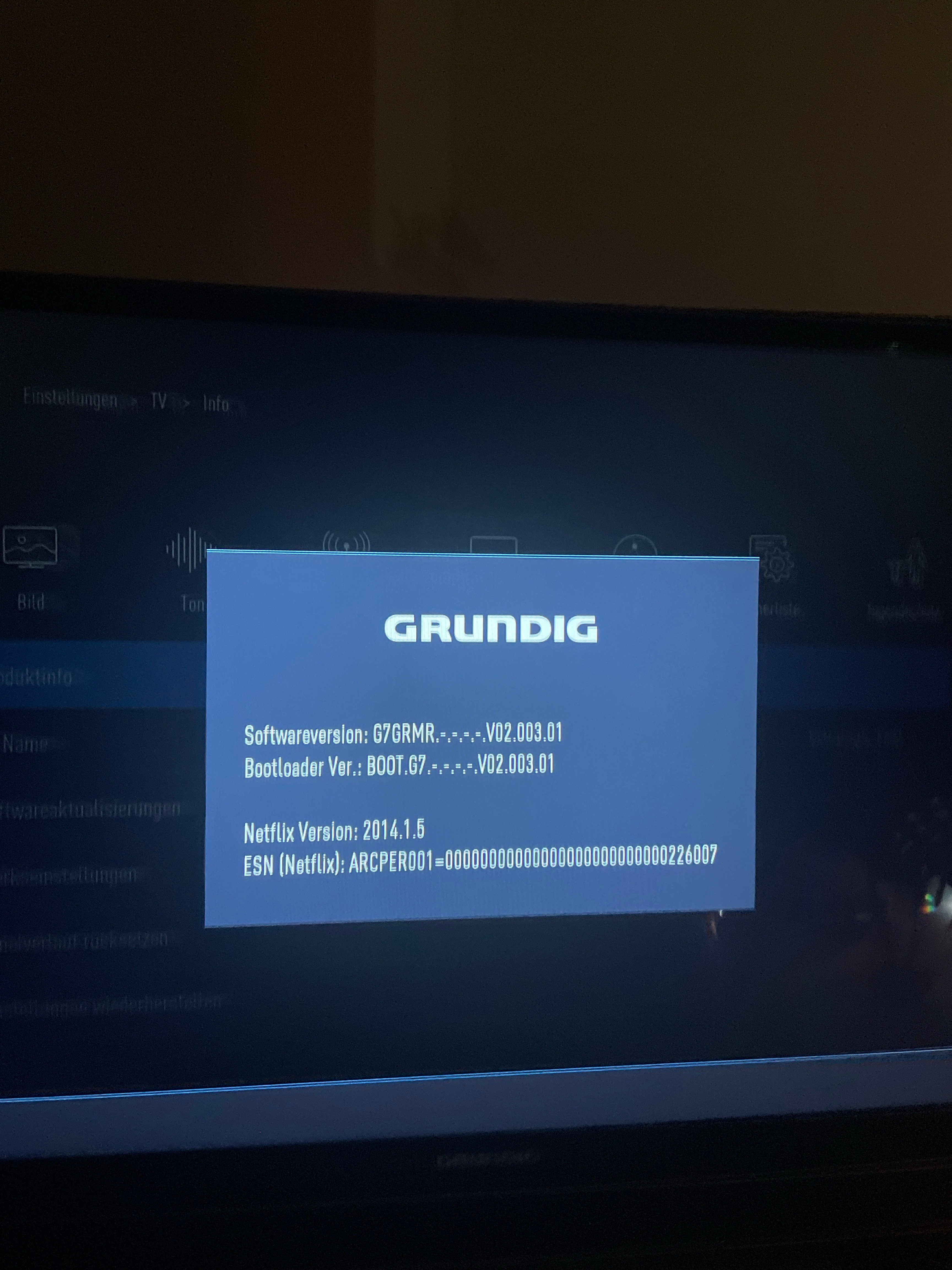

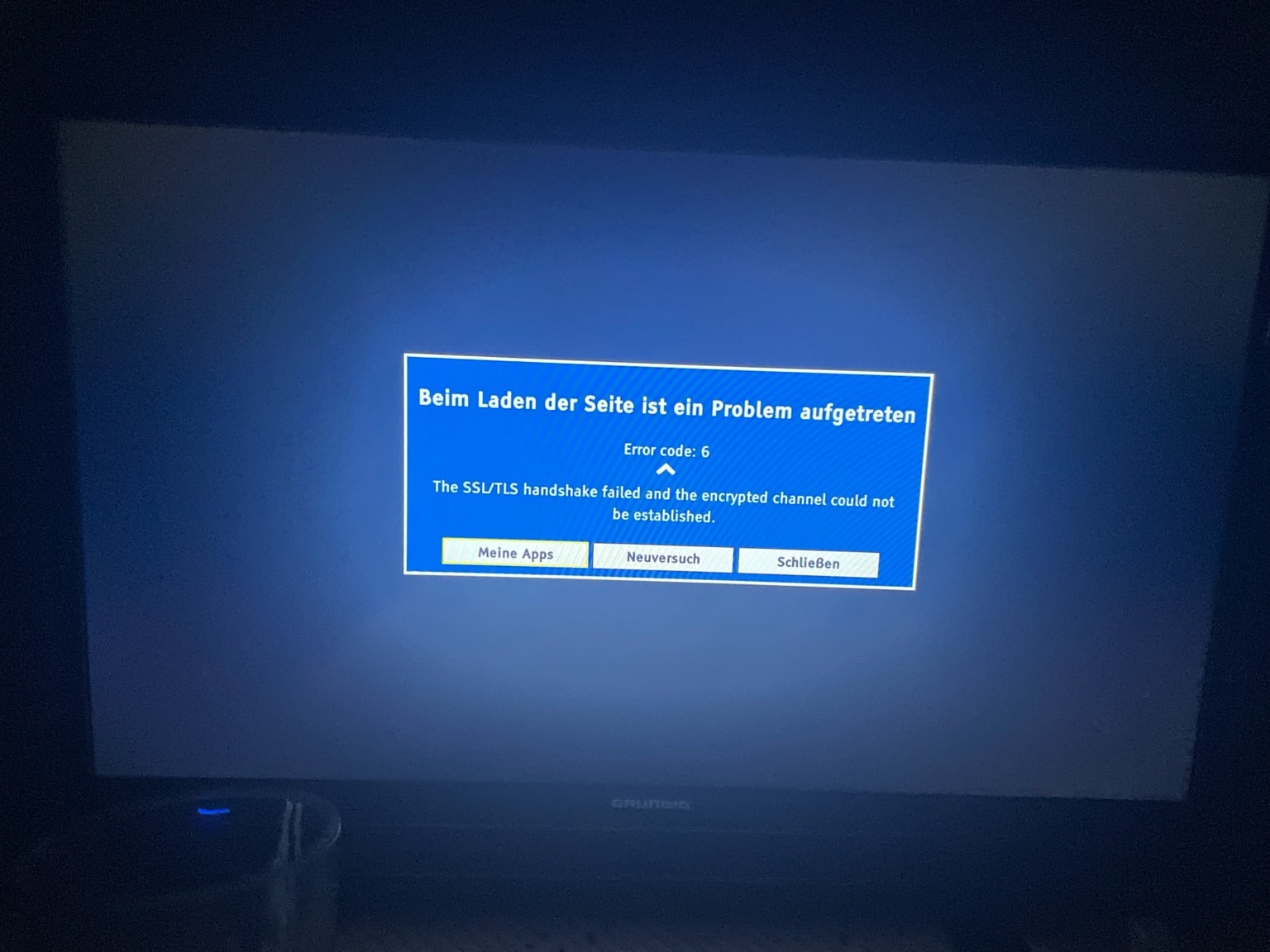

  • #14 21383054
    angelinabrittany19
    >>18890493 I hope this will work for my Grundig
  • #15 21549186
    mariostodge
    >>19611529 Sorry, could you help explain how you got your software updated? I'm trying to get mine updated but it's not working via internet. How did you update yours with the files you downloaded?
  • #16 21718359
    dprutovykh122
    Dear @ssss,
    I recently purchased a second-hand Grundig 32 GFB 6621 TV, and the Smart TV functionality is not working. Could you please provide me with the firmware file for this model so I can update it?
    Thank you very much for your assistance.
    Best regards,
    Daniel
