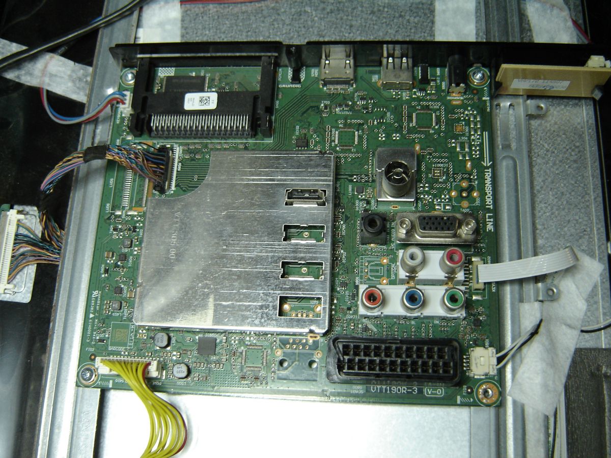

    model 22 vle 6320 bp
    main VTT190R-3 V-0

    Posts: 11
    With this firmware it turns on but the image and the sound fail me, I do not know if it has another fault

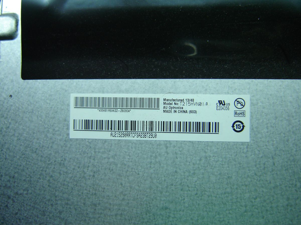

    pantalla T215HVN0 1.0
    Lo he probado y no me funciona.
    Después he instalado el bin directo a la memoria pero no enciende, se queda el led encendido fijo.
    Con su bin parpadea el led azul encendiendo hasta que se queda fijo y no se ve ni se oye nada.

  • #8 19640905
    IMAXA
    Posts: 11
    I am looking for firmware tv grundig 22 vle 6320 bf does not light blue led I am looking for firmware tv grundig 22 vle 6320 bf does not light blue led
    Con este firmware parpadea el led azul y se queda fijo y no enciende ni tiene sonido.

  • #10 19876358
    IMAXA
    Posts: 11
    ok este funciona

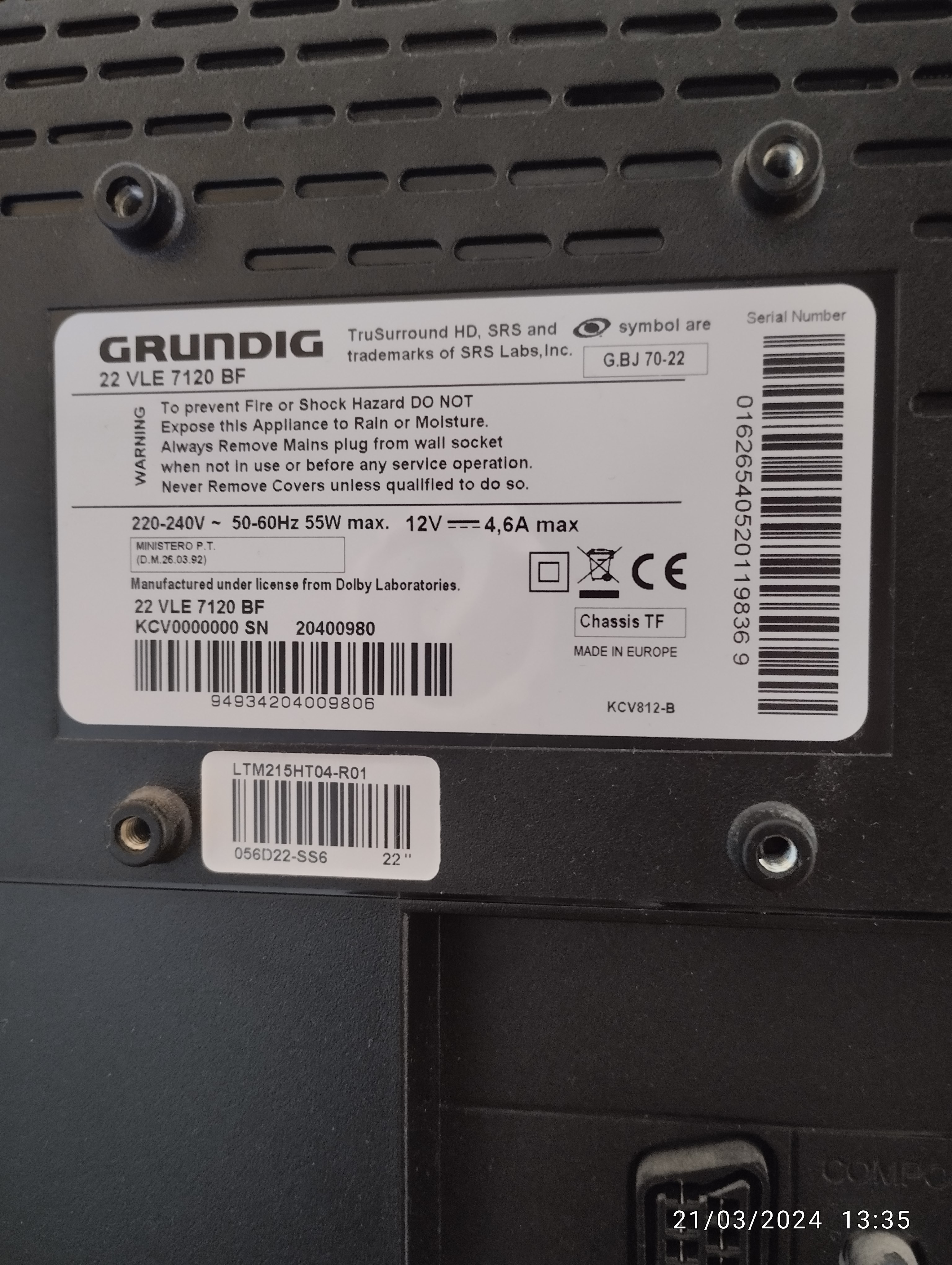

    albertscode
    Hi i need firmware for 22 VLE 7120 BF.
    electrónicacalle@gmail.com.
    I working in a hotel maintaining person. The boss put a Code pin not generic and forget pin. I think if reprogrammed can solved or say me what can i do. Have between 25 & Photo of the label on the Grundig 22 VLE 7120 BF television. 30 TV
    Thanks

  • #12 21013540
    yokoono51
    Posts: 815
    Help: 172
    Rate: 316
    You have software from the manufacturer for the TF chassis. Unzip and put on a stick formatted with FAT32. Insert the USB stick. Press and hold the P+ key on the TV. Plug in the TV. When the update bar appears, release the key.
