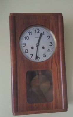

    The clock strikes the hours incorrectly. For example, at 23 o'clock it strikes once. At 15 o'clock it will strike 13 times. He'll be able to adjust it himself. I will add that it strikes every other hour, it strikes only odd numbers. Thank you in advance

    In my opinion, the hands were removed and put on incorrectly, which is why a "time shift" was created. The simplest way is when the clock strikes the wrong time - identify what time it struck. Then stop the clock (pendulum), remove the hands and set them to what time it struck. Then start the clock and set the correct time, that's roughly it.

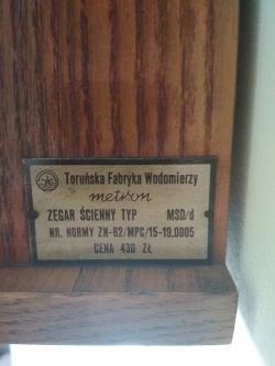

    If possible, take the mechanism out of the housing, take photos of the back and two sides (as accurate as possible) and maybe something will be able to suggest (I also have a Metron and not only). Metro Clock Striking Incorrect Full Hours: Strikes Once at 23 & 13 Times at 15 - DIY Adjustment?

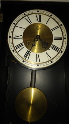

    These clocks became out of sync even when the clock was running without winding the strike spring. I think it's enough to stop the beating spring and set the correct time.
    Dude, don't overdo it. Nothing in the mechanics will synchronize itself. In clocks, depending on the mechanism for selecting the amount of beating, there are levers to set the amount of beating. This is the one on my Metron on the right side. It is a lever Metro Clock Striking Incorrect Full Hours: Strikes Once at 23 & 13 Times at 15 - DIY Adjustment? to trigger a beating without moving the hands.
  • #10 18894355
    wojtek18p
    Posts: 19
    Rate: 12
    Following the instructions above solved the problem.
