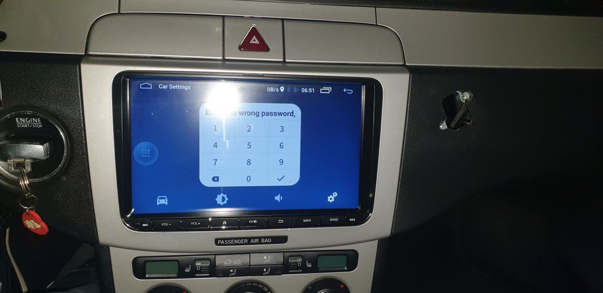

    Chinese android 9.1 - Service code
    How to get service code for Chinese Android 9.1?

    in version 8.1 the default code is 8888, try it.
    When it comes to these Chinese radios, they usually have codes like 1111, 2222, 1234, etc.

    I entered different ones and nothing works, I wanted to change the logo, so I prefer the code

    [quote="76slawek"] [url=https://obrazki.elektroda.pl/7339212600_1602650788.jpg] How to get service code for Chinese Android 9.1? [/
    And I guess we won`t find out what code to change the logo in this radio bought from Aliexpers, the Chinese guy also didn`t talk, what should we do now?

    check:
    5678
    7890

    Thanks tesz doesn`t work

    Try it, downloaded from a foreign forum:

    What a disaster, ladies and gentlemen, none of the codes match

    Somewhere I saw three more digital 888s at someone`s place, maybe the seller can help with this?

    Try entering 000000 and ok

    Dziki was right, the code 000000 helped, thank you all
