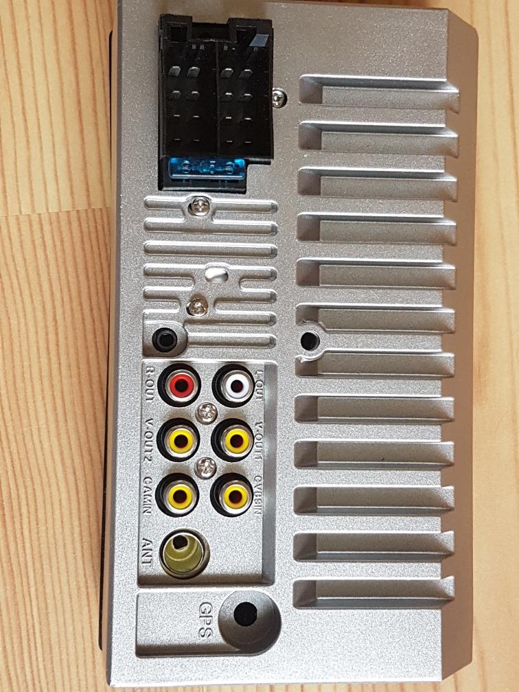

    I bought a similar radio and wonder if the GPS module can be soldered to it? The board looks identical to the post 1. Does anyone know where such a module could be located, i.e. where it is soldered by factory, and what model is it?
  • #8 16767048
    Davvvi
    Posts: 2649
    Help: 6
    Rate: 184
    @cerbik Why do you need a GPS module on this radio? If the radio is on a different software than Windows CE or Android, then the module will not give you anything, because you will not upload any map. And at such a price of the radio it is probably a dedicated soft.

    I have Windows CE in it and I thought about uploading TomTom to WinCE and running it as an application, but probably without a GPS module it probably won't go. I wonder if, for example, external Bluetooth GPS modules can do it here? I saw a few on the allegro and I wonder if it will play and will it bite with the speakerphone (phone on bluetooth)? Will the radio connect to two devices and work?
    I bought this radio: https://www.aliexpress.com/item/hot-2-DIN-7-I...dio-MP4-MP5-Player-In-Dash-Stereo/32664732037. html

    And how do you know that it has Windows CE? After description? The description may differ from reality. Unless you have some real info? I am asking because I have a GPS module and I had a desire for such a radio. Besides, to upload the map, from what I remember, you had to unlock Windows.
  • GPS module may be absent on this 7010B radio
    #11 16767575
    cerbik
    I do not know if I have winCE, I have seen such radios with GPS modules and I thought that someone would have here and be able to look in where it is soldered and what module model. I stared and did not notice that there is only a hole on the GPS and there is no way out for the antenna. In the near future I will test and check, because maybe some USB module will work, then I will connect the hub and somehow connect it all under the dashboard so that it is not on top. Then my doubts about biting Bluetooth (1 for the module and one for the phone) will fall away. In the near future I will be over the radio, if I don't forget, I will write.

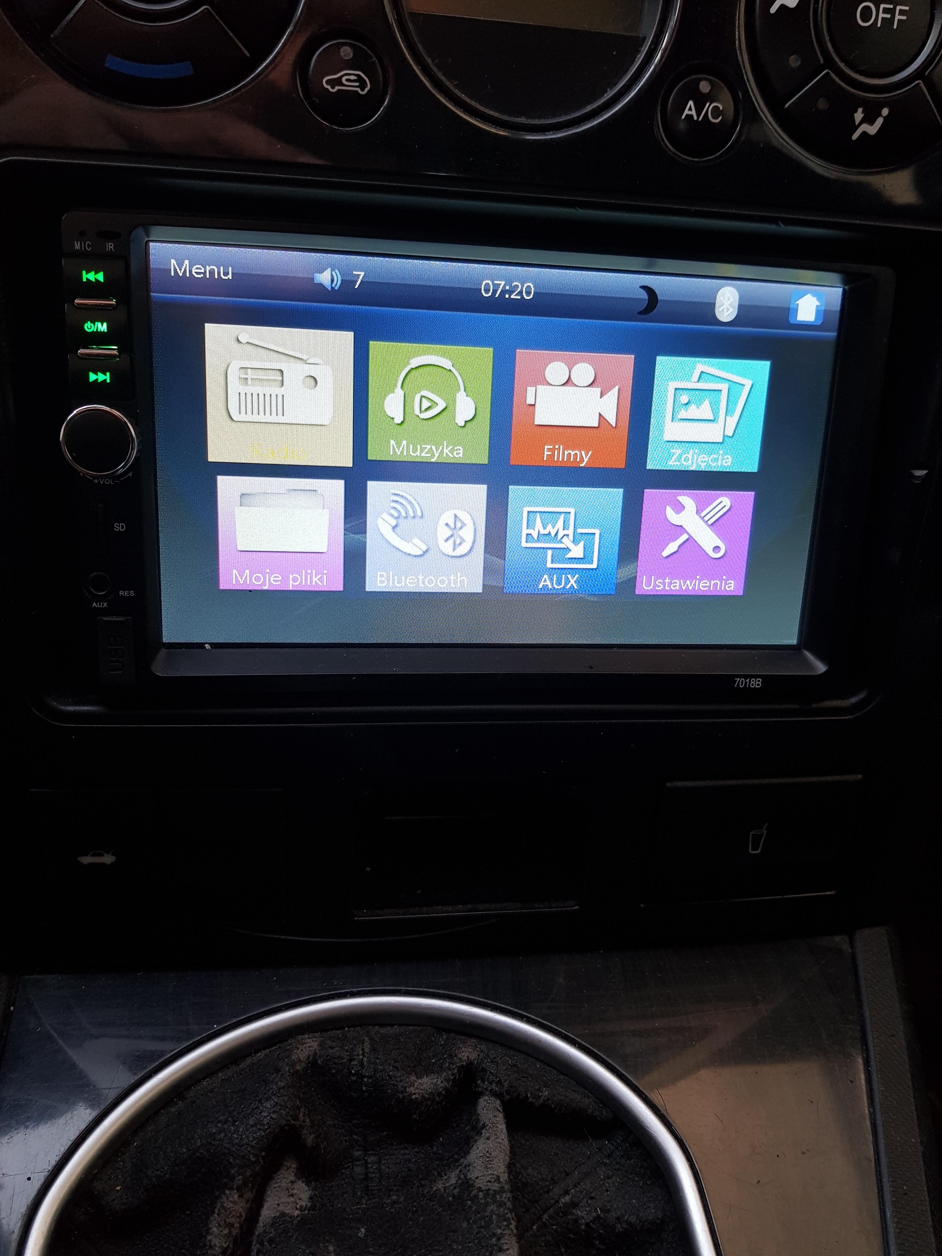

    I have a similar radio 7018b, I bought it used from someone, everything works.
    I had a problem with the password to change the logo because I was given 1983 and it turned out that I have 1234.
    I have 2 questions:
    1. Is it possible to upload a program to the radio to copy a picture from the phone? How so, how and what program?
    2. The screen flashes on the engine when it is running, what could be the reason?

    I have a Chinese 7018B radio and I missed the startup logo, so I decided to look for another firmware.
    I downloaded the firmware from the Internet (I can not add a link on the forum) like the same model and here suddenly a surprise.
    After uploading the radio turns on but there is no sound, it does not respond to the keys and the screen is faded.
    Everything else works, touch works, you can move around the menu.
    Please, help me find the right software.
