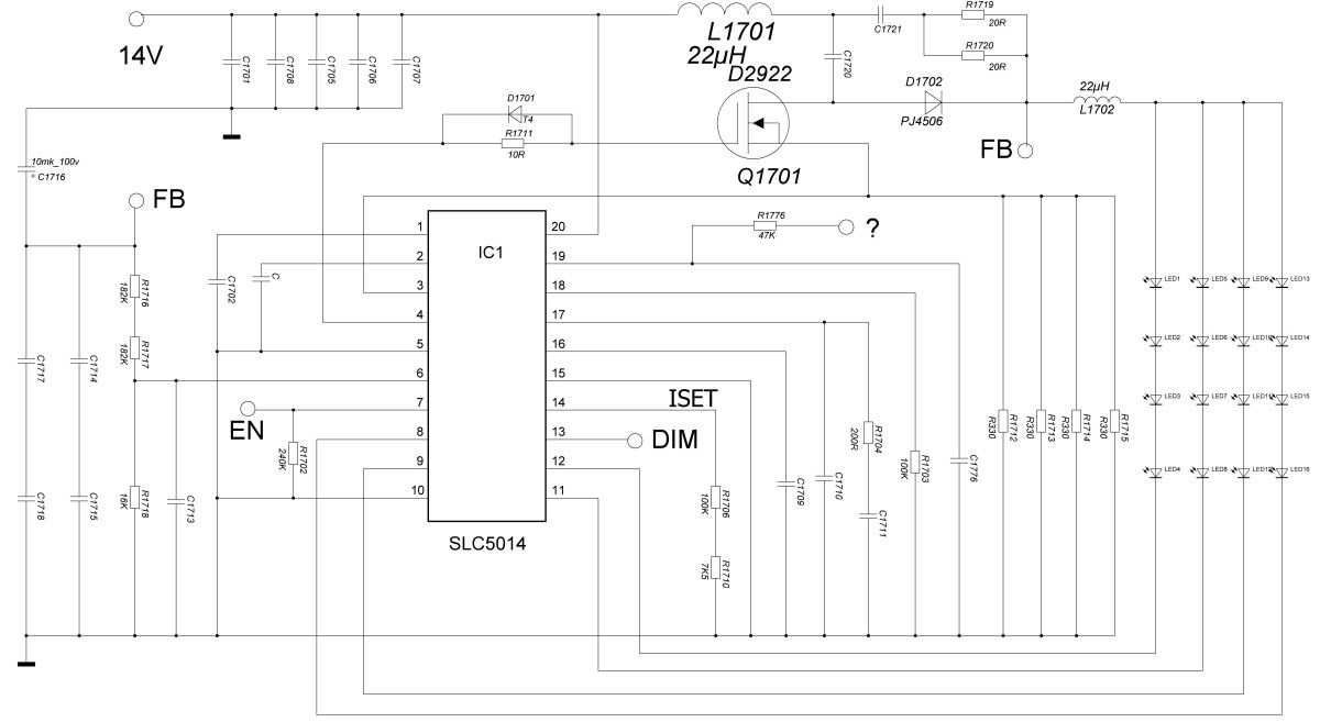

  • Backlight current reduced by increasing ISET resistance
    #3 21357687
    lisek
    Service technician RTV
    Posts: 39992
    Help: 6352
    Rate: 6883
    Check
    Samsung T24D390EX
    -main> pcb: BN41-02152 /BN94-07379M
    - matrix CY-MH236BGL
    - SPI 25Q40CLSIP
    Led driver SLC5014R.
    Electrical schematic of the LED power supply circuit for the Samsung T24D390EX monitor. .
    Reduce the backlight current Iled - proportionally increased the total resistance of the resistors relative to the housing on pin 14 of the SLC5014R IC ISET
