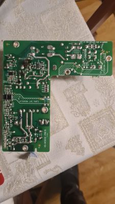

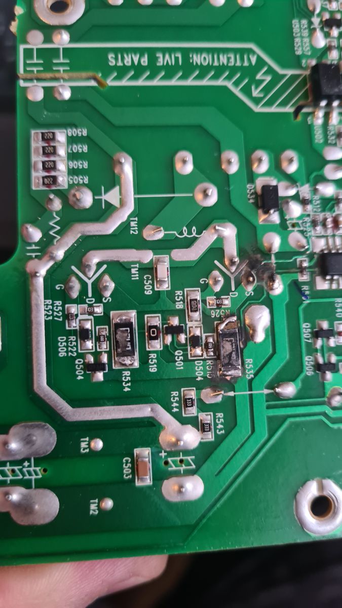

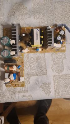

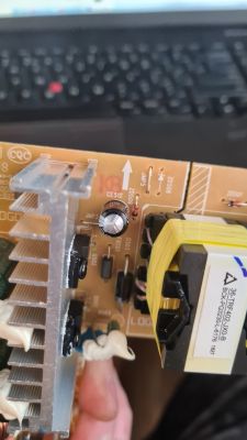

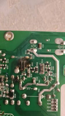

    It was playing and suddenly it roared and went out. It's about the subwoofer itself. I unscrewed it and it looks like damage to the power supply system no. 40-N150SE-PWE1G. I noticed at least 3 damaged elements, one swollen CE512 capacitor and two resistors R534 and R535, but there is no way to read any values from them. Maybe more experienced forum members will be able to help something more (what resistors), whether something more could have been damaged and what could have been the cause. I have attached a photo of the damaged system.

    janach07 wrote:
    two resistors R534 and R535 but there is no way to read any values from them
    Try to determine their value after the DS of the system, their value will be fractions of Ω, e.g. 0.2-0.3Ω.
    Transistors and more to be checked, because burnt resistances are the effect, not the cause.
