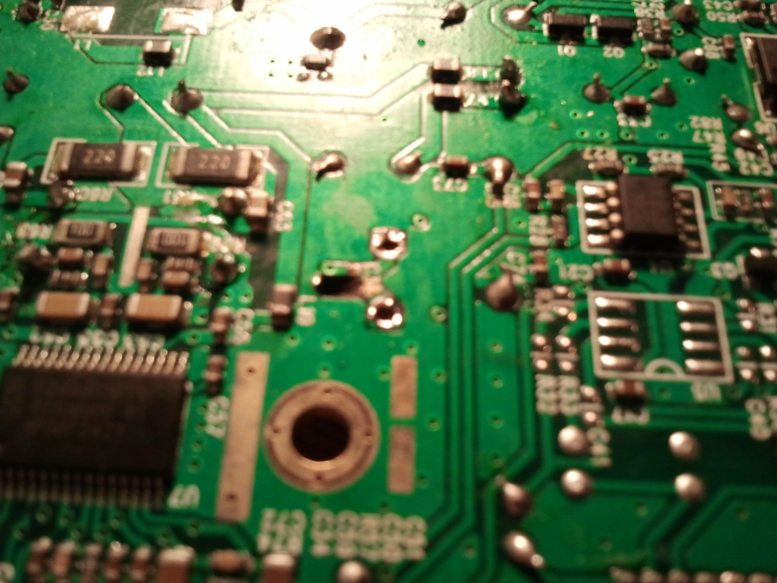

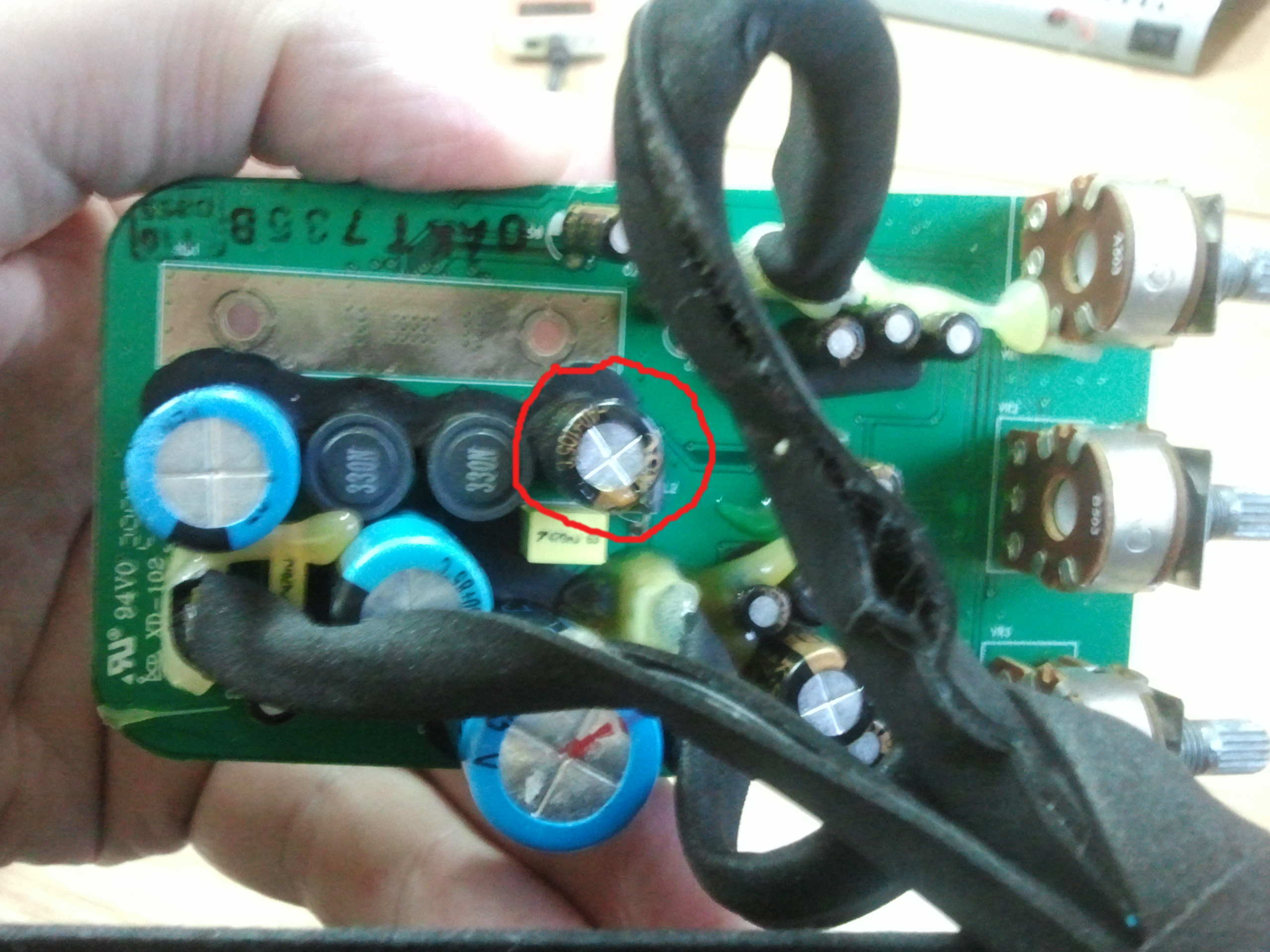

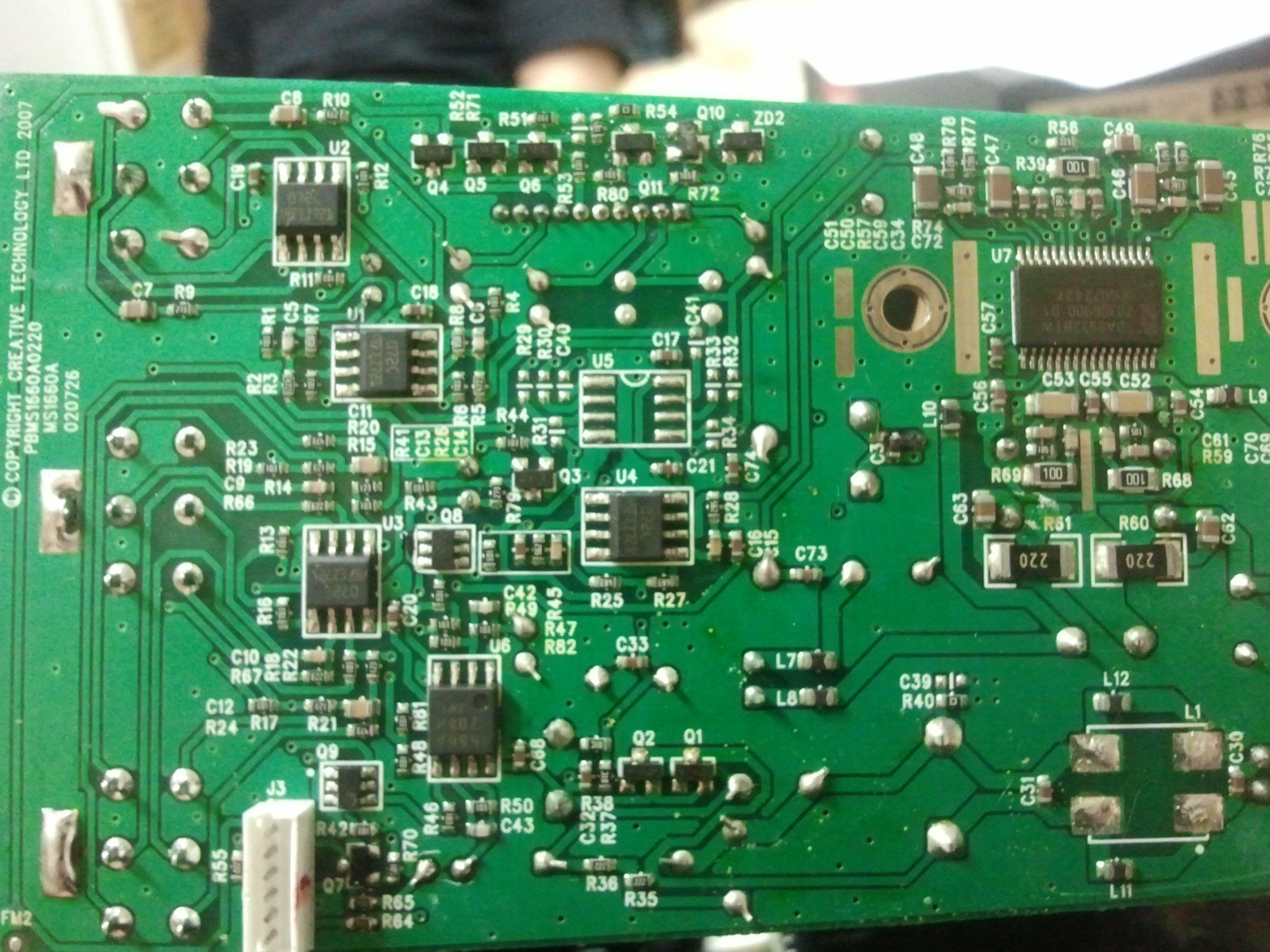

    In my set, one channel suddenly stopped playing (loudspeaker without an amplifier), while the other one started to make strange noise and interruptions.
    After opening the casing, it turned out that there is a sooty point on the preamplifier board, a trace of a small explosion. cleaned this place thoroughly with acetone. it turned out that one of the capacitors marked (C3 ??) has burnt, the second number is probably 6, so the number of this capacitor is 36.
    He is looking for a diagram or a photo of the board from these speakers to determine the parameters of this element and to recreate the part of the track that has been damaged as well. It looks like this element was connected in parallel and with the second capacitor, only electrolytic.
    Could the failure of one capacitor cause disturbances on two channels, because if not, then I have to look for further damage? Creative GigaWorks T40 Burnt Capacitor C36: Seeking Diagram/Photo to Identify Parameters

    I'm afraid something more has been broken. Show the photo of the plate from the side of this electrolyte. Measure the voltage on it. Without a diagram, however, it will be difficult to determine something.

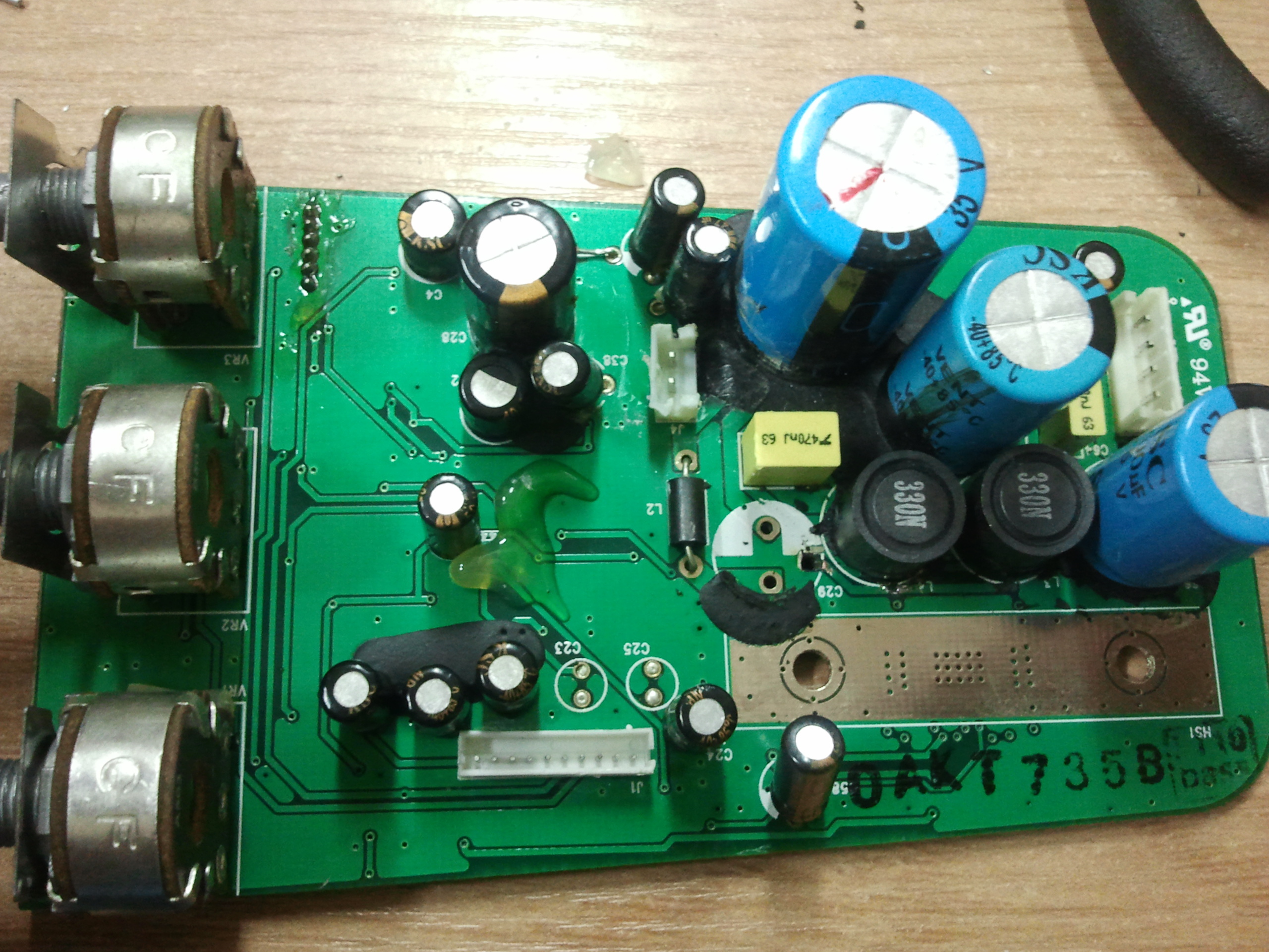

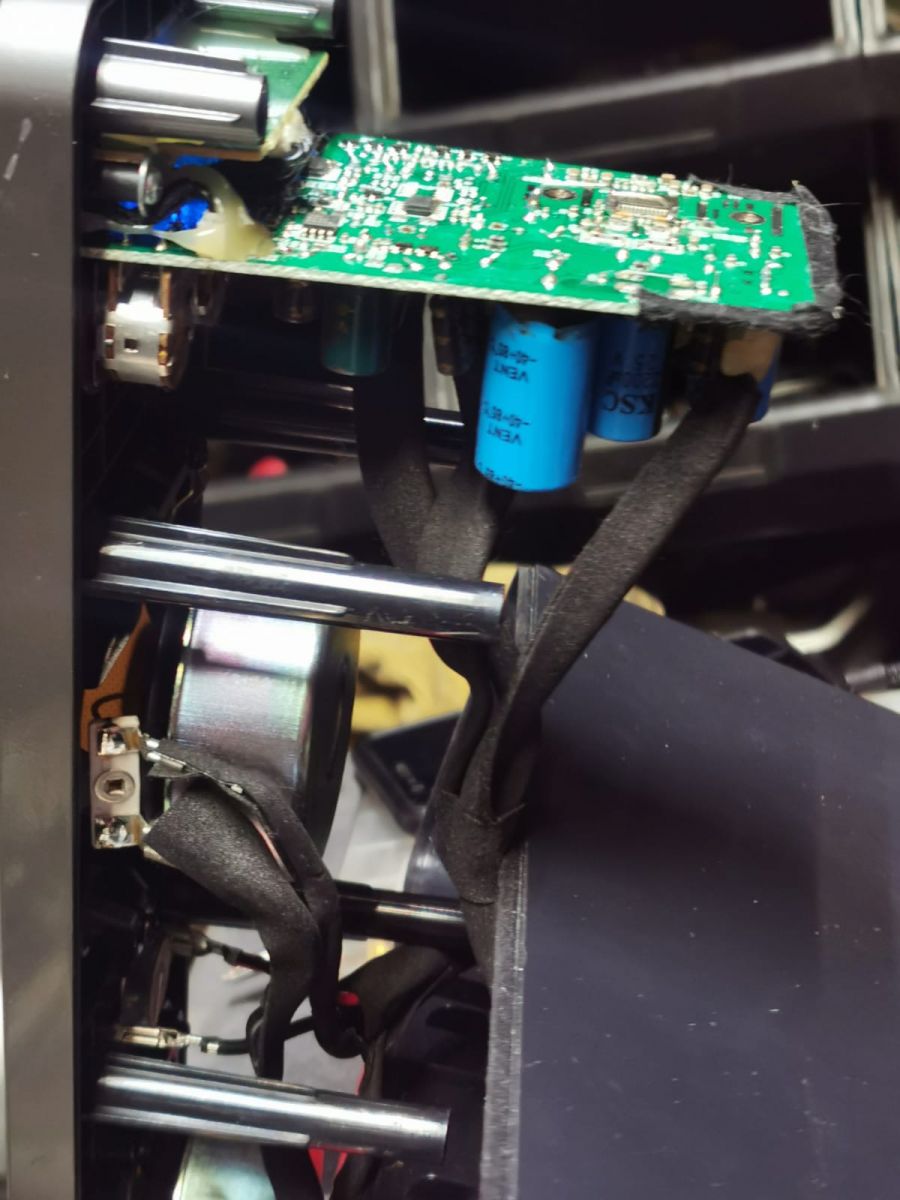

    On the other hand, you can't see anything. I wonder where these elements are connected to the rest of the system. in the photo I marked the electrolyte connected in parallel with this smd.
    The electrolytes were stuck with black mass making it impossible to see the paths on the other side. I have included a more detailed photo of the underside
    after a careful inspection of this place, I came to the conclusion that the paths go to the other side here.
    Is it possible to approximate the capacity of this capacitor ????

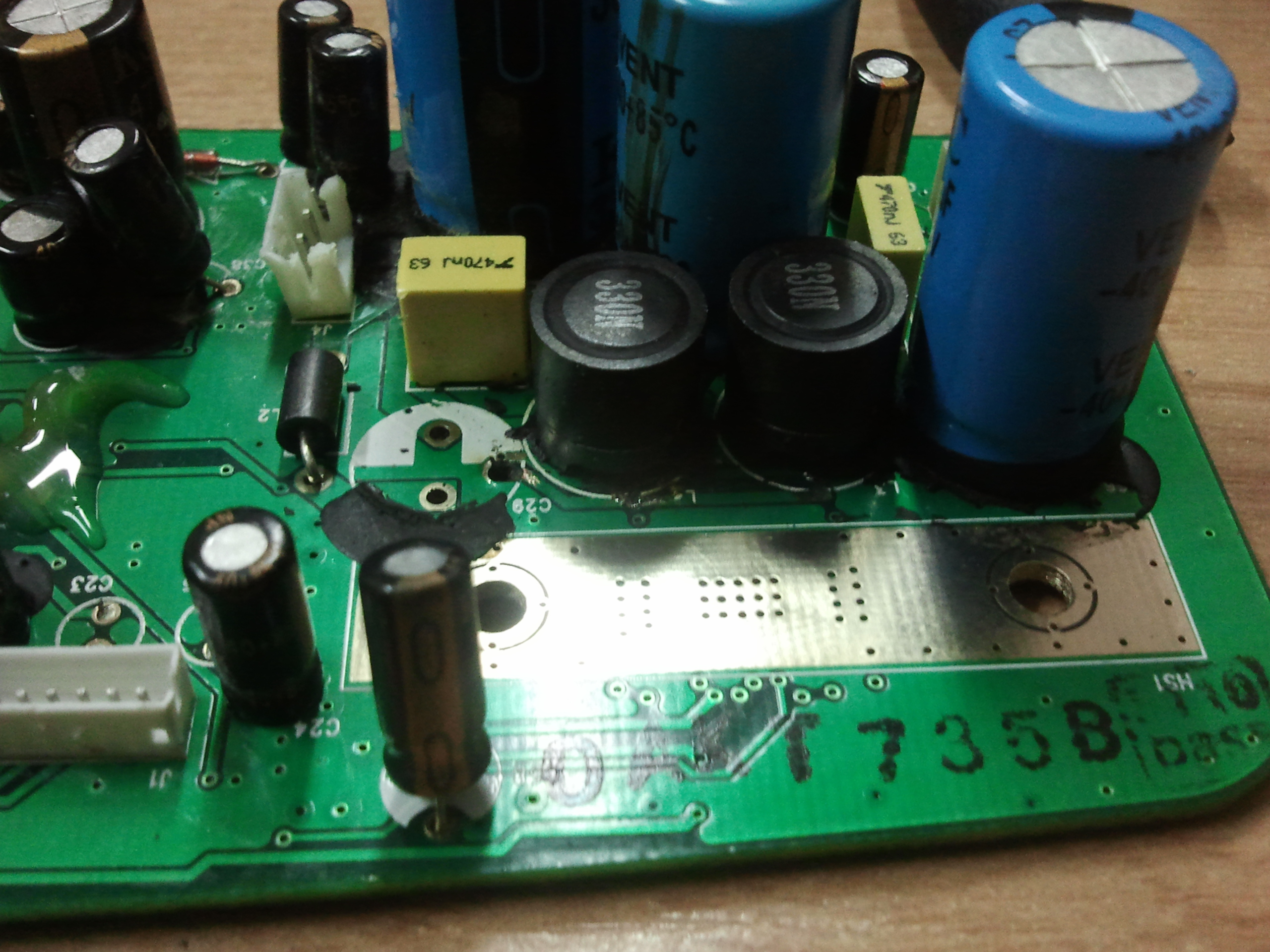

    I desoldered this electrolyte and partially cleaned the plate of this black mass. It turned out that the problem was more serious. The tunnel connecting both sides of the tile is completely burnt .. the tile itself has also suffered. the path leading to the damaged item is also broken.
    Repairing such damage is probably beyond my capabilities. Is it possible to repair it at all economically justified costs ?? Anyone want to repair?
    I am adding photos showing the damage
    Creative GigaWorks T40 Burnt Capacitor C36: Seeking Diagram/Photo to Identify Parameters Creative GigaWorks T40 Burnt Capacitor C36: Seeking Diagram/Photo to Identify Parameters Creative GigaWorks T40 Burnt Capacitor C36: Seeking Diagram/Photo to Identify Parameters

    Without a pattern it will be tough. This path can be repaired, but it is not known if something else is damaged. You need to start with checking the power supply.

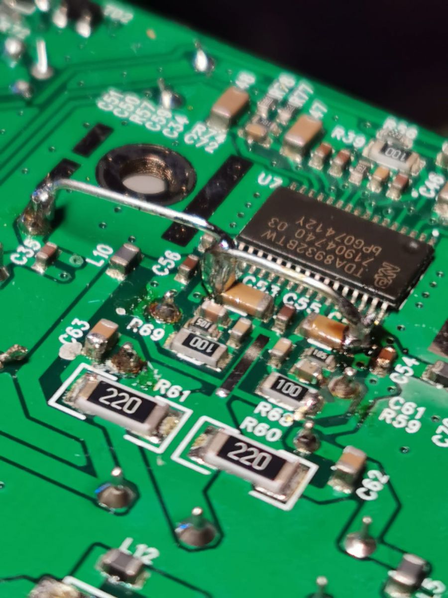

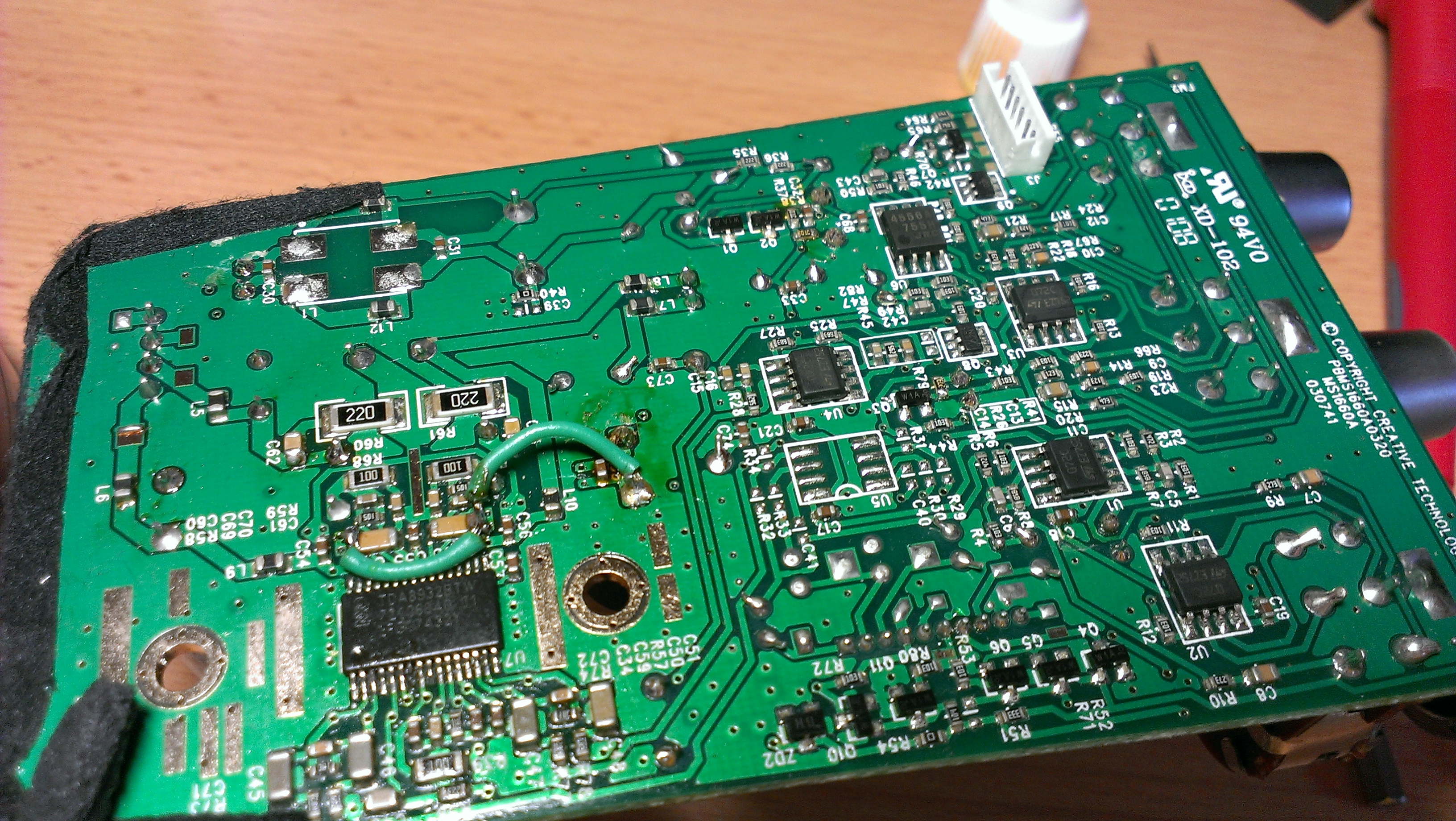

  • #11 14814792
    .bad.
    Posts: 6

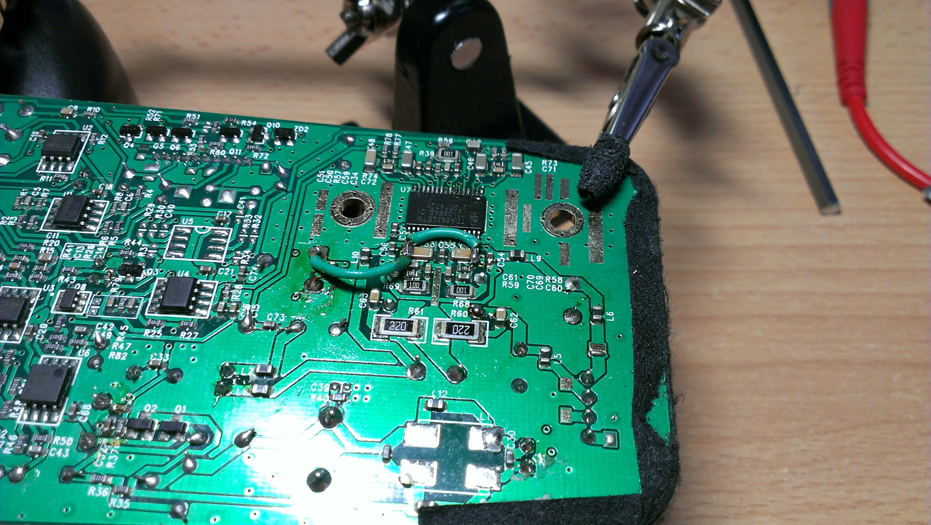

    In my case, the tunnel connecting both sides of the plate was also burnt (quite a common case in this model). It is enough to connect it as in the attached photos. After this operation, the speakers sound as before. The only difference is that this smd capacitor has not been damaged. Creative GigaWorks T40 Burnt Capacitor C36: Seeking Diagram/Photo to Identify Parameters Creative GigaWorks T40 Burnt Capacitor C36: Seeking Diagram/Photo to Identify Parameters
  • #12 15941248
    rymonides
    Maybe this is a layman question .. but did you leave the capacitor in its place?
  • #13 15941316
    .bad.
    Posts: 6
    Yes. There was no reason to desolder it.
  • #14 15941419
    rymonides
    I decided so before you answered and I made according to the attached photo. They come alive and play, thanks! :-)
  • #15 16160853
    rafal2893
    Posts: 57
    Rate: 14

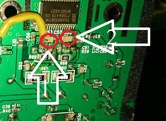

    hello in my speakers this path has also been interrupted
    I attach a picture
    I have a question about these two SMD capacitors 1 and 2 (photo below) what are their values and for what current?

  • #17 16466092
    SETTer24
    Hello colleagues. It was the same for me. The grommet has burnt under the C29 electrolyte. This could only be ascertained after desoldering the capacitor and cleaning it from the nasty black glue. I drilled a hole with a 0.5mm drill in the place of the grommet and soldered the wire for the through-hole. The speakers came to life. I bought them aledrogly for a hundred so that my joy is immense.
    Thanks to everyone for helpful posts and photos.

    wojtaso79
    I am definitely a layman
    but after 3 years of looking for among friends who supposedly know each other, I found this post on elektroda.pl
    I liked these speakers a lot. I reacted olewly to texts such as exchange, buy new ones for PLN 200, etc.
    I mean, of course you are right etc. I am very attached to them and as active monitors for listening with 1m on the computer I did not see an alternative. Right, it paid off to wait. I don't know much about electronics but I love broadly understood audio. Of course, there are two other devices for auditions and this is their purpose. These are great sounding monitors without a sub and it should be like that.
    I knew this post that confirmed my symptoms, the description without measurements confirmed the significance of what happened. Now they are playing like new and I feel like a child. Thank you all very much.
    Below is a report.
    Greetings
    Wojciech Creative GigaWorks T40 Burnt Capacitor C36: Seeking Diagram/Photo to Identify Parameters Creative GigaWorks T40 Burnt Capacitor C36: Seeking Diagram/Photo to Identify Parameters Creative GigaWorks T40 Burnt Capacitor C36: Seeking Diagram/Photo to Identify Parameters
