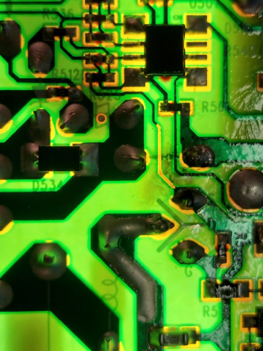

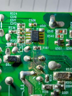

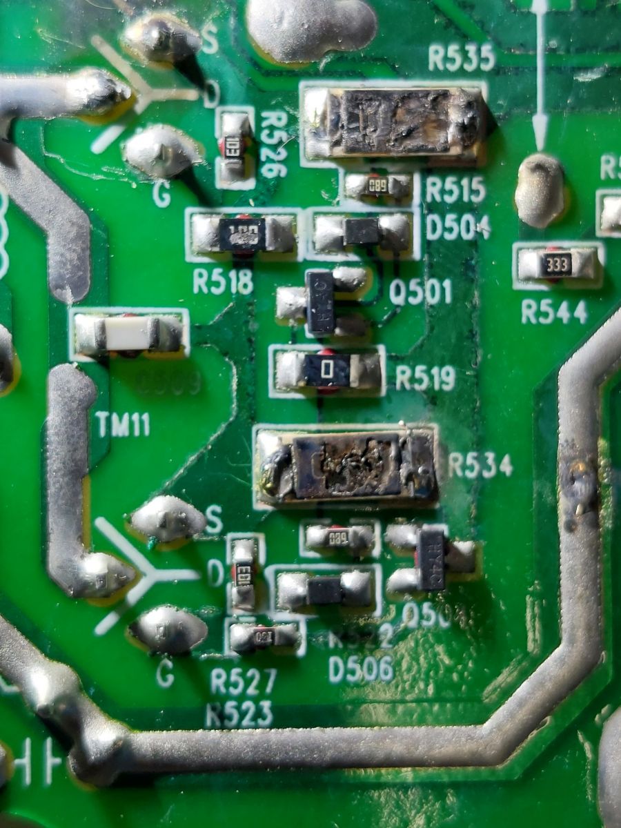

    I have a JBL BAR 3.1 subwoofer with a faulty power supply.
    Seems that there is a blown capacitor CE512 and 2 burnt SMD resistors R534 and R535 as per photos.
    Can't read SMD resistors values.
    Does anyone have schematic diagram?
    Please, has anyone encountered this problem or know the values of these resistors?
    Thanks for your support.

    I don't have a schematic, but I recommend finding the cause of the fault first.
    You can see in the picture that the capacitor is bulged, so it probably has a large ESR, it could have started with it.
    Check the mosfet keys and their surroundings too, because the damage can be much more than just these resistors and swollen electrolyte.
    It would also be good to determine what SMPS driver is sitting there, check its outputs for a short to ground, etc.
    Maybe having the circuit diagram you can get what the values of the resistors should be, the PCB looks like measuring resistors included in the transistor sources, used to determine the value of the key current, their value will be in the range of 0.44-0, 01 ohm and are high power for an SMD component (2512 ?)

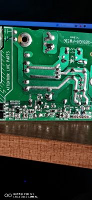

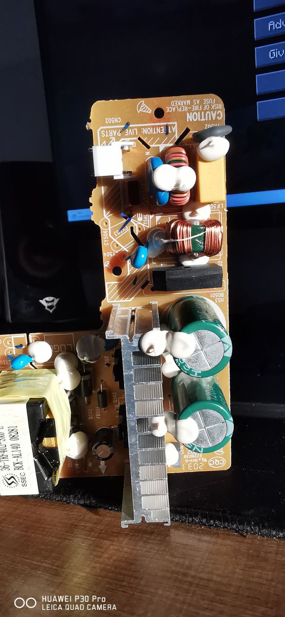

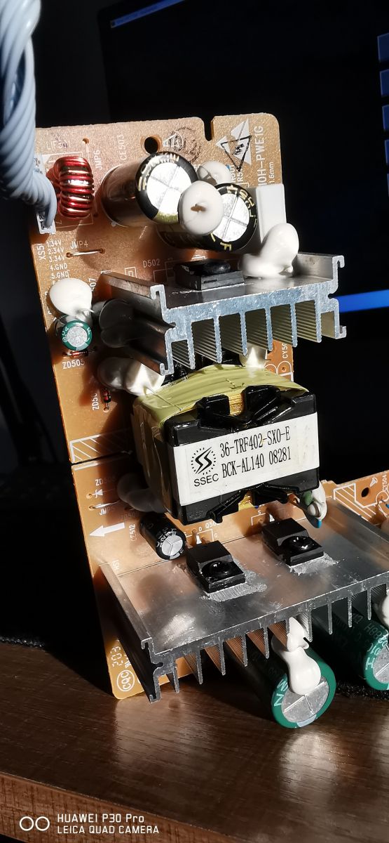

    I'm trying to repair such a power supply, mine looks much worse.
    Take detailed photos of the damaged piece.
    Maybe it will be possible to read the values of the elements, in mine all the semiconductors to be replaced, including the integrated circuit.
    This is probably a planned damage by the manufacturer, because they all break down exactly the same and it's strange that after the warranty.

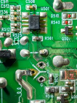

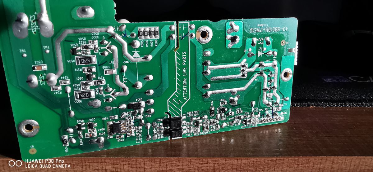

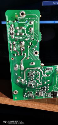

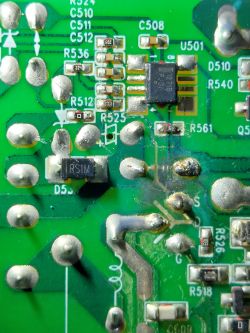

    Did some troubleshooting on board and found that:
    1) Both mosfets (smk1265) are shorted.
    2) PWM CONTROLLER IC 1271 has pin 4 shorted to pin 5, that is the mosfet drive is shorted to GND.
    3) Open track between mosfet source to Power IC current sense pin 3.
    4) Open 0 ohm resistor (R561) that is between GND and Power IC gnd pin 4.
    Including the 2 SMD Power resistors and the bulged capacitor.
    Here are some detailed photos.
    While browsing on the internet, managed to find a similar problem photos. Seems that the value of the two Power SMD resistor is 0.34 ohms (refer to photos)
    What's do you think?

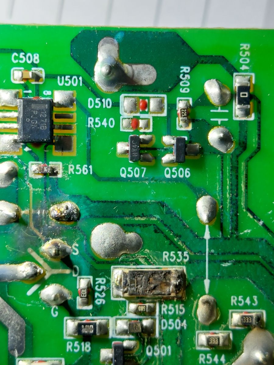

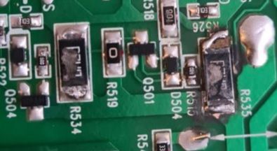

    These resistors are 0.240 ohms (R5345 and R535), check the SMD transistors, mine is also damaged.

    The layout is NCP1271 that's how it looks. I have not come across the designation R240 but 0R24. It may be correct for e.g. 1% tolerance.

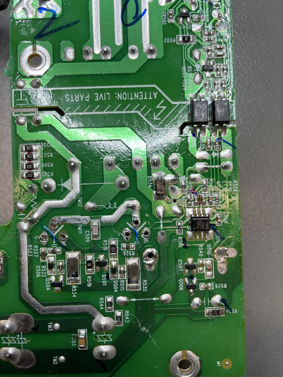

    Today we received the same subwoofer with exactly the same power supply, a hint for everyone - it's a regular 34V power supply without switching on.
    Regards.

    R534 and 535 are shunt resistors, used to measure the current through the MOSFET. For some reason the MOSFET went short, the current rose and the shunts were burnt before the PSU protection could kick in...
    Replace the IC, the MOSFET and the shunts. Also check with a multimeter for a short to ground on the input and output rail (before placing new components), also check the other components (resistors, if they show the value written on them), check capacitors for short.

    Reasoning error - SD transistors are not damaged, which indicates another cause of damage. transistors with a current of 12A are not damaged and blown up 0.240 ohm resistors. I think they are the cause of the crash.
    All subsequent damage is a consequence of these burnt resistors.
    I VERY wanted to fix this power supply.
    Repair in the service is PLN 350.
    A bit pricey for a power adapter. buying parts is also not cheap because everything visible in the photos needs to be replaced.
    Thanks to my friend "awcon" I found out that we need a 34V power supply.
    I gave up repair - it's cheap to buy a ready-made power supply.
    I bought a 32V power supply for HP printers with a power of 180W (I exaggerated a bit - 60 is enough) - everything works SUPER, the power supply has all the protections and will definitely survive this subwoofer.

    I bought one - HP 0957-2260 32V 5625mA
    It works, has protection against short circuit, overload.
    The only problem is no "stanby", almost not a problem for me.

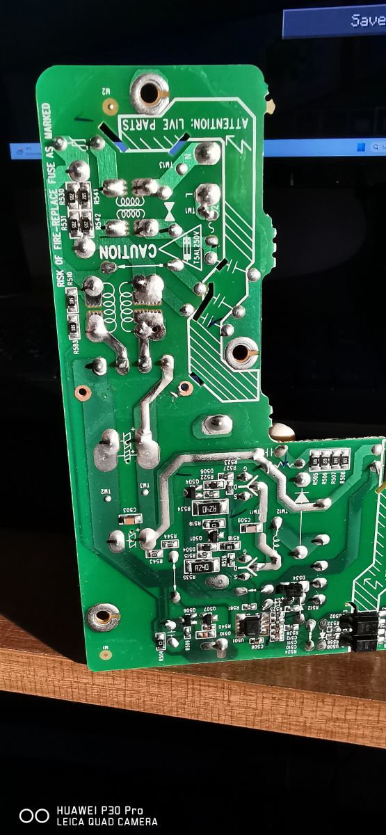

    Good morning, I have the same problem JBL 3 in 1 bass, can you buy the entire power supply module somewhere, I'm afraid it's a factory defect and will be repeated. I think my case is from the neighbor's photovoltaics and 253 volts.. JBL Bar 3.1 Subwoofer - SMPS 40-N150SE Board Faulty Power Supply, Resistor R534 & R535 Values
    you can see a few burnt resistors and of course the SMK1265 have a short circuit.
