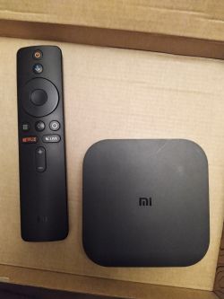

    Hello, I have a Xiaomi Mi Box that after hanging up during the update does not start eternal reset when going to upload Android I can't enter service mode because it can't even see the remote control (ok, backwards doesn't work). Please help if anyone had a similar problem.

    Exactly what model is it.
  • #3 19620123
    mirekpol1
    Good morning this is Xiaomi Mi Box S (MDZ-22-AB)

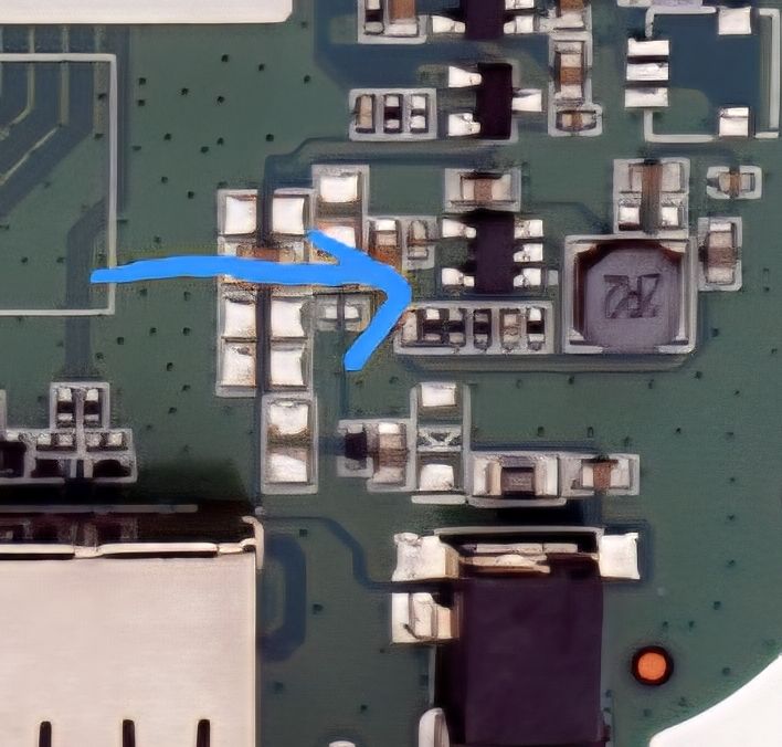

    Hello colleagues. I'm going to dig up the topic, can anyone provide information on which pins need to be shorted to flash the box?
  • Request for burned component identification on Xiaomi Mi Box
    #28 21613045
    gracus7
    Level 26  
    Posts: 1237
    Help: 37
    Rate: 201

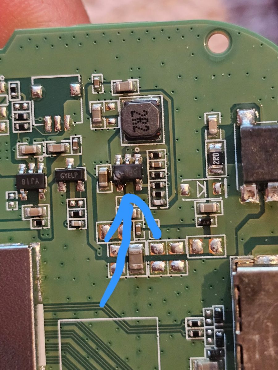

    As you are already taking apart these devices of yours so as to make a jumper for flashing, maybe someone can take a peek and give me the designation of one component that burned in this model.
    The marking on the component is something bP0 ... probably 7 but unfortunately it burned out

    Is no-one able to help? Opening the case takes a minute

    I also have the same one and it does short-circuit the power supply, however it hasn't ruptured it yet, it says bPBUP on it - I searched but couldn't find it. This one: SGM61020S SOT-23-5 https://www.sg-micro.de/rect/assets/95dbf04a-...access_token=JB0xlRQ-10F_vQg1XXqsnx8zy4iF65LO seems similar but I'm not sure, if anyone has checked if it's a replacement please let me know.
    Regards.
