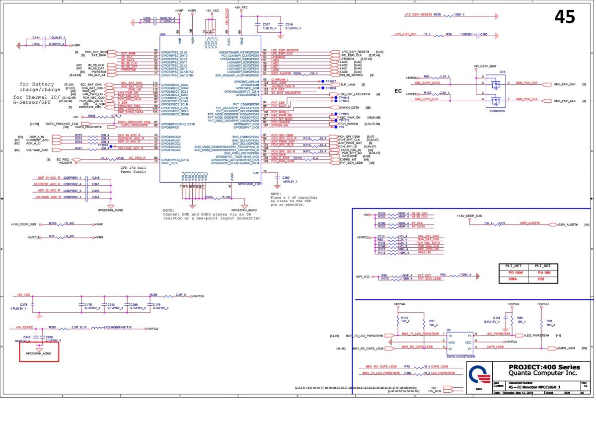

    I am looking for information on the layout Nuvoton about the designation NPCE586HA2MX.
    The main question is whether this system is programmable?
    I know it's mounted on boards DA0X8CMB6E0 REV E I found it on the CD DA0X81MB6E0 Rev E , but ending with DA0X8CMB 0MX .
    Are these chips interchangeable?
    What motherboards are they on?
    Can these chips on one board have a different pinout than on another?
    If anyone, I'll ask you something :D

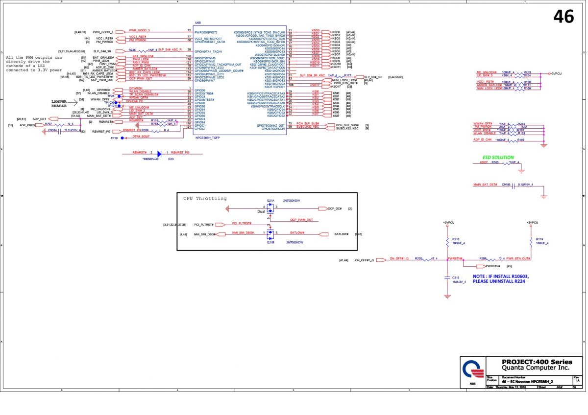

    NPCE586HA0MX pin comparison with HP ProBook boards
    #4 19732431
    lisek
    Service technician RTV
    Posts: 39995
    Help: 6352
    Rate: 6883
    It is about Nuvotn kbc npce586ha0mx qfp-128
    on HP ProBook 450 G3/ HP ProBook 470 G5
    board from Quanta DAX63CMB6C0 Rev:C
    There is SM and *boardview
    Compare pin"s
    Nuvoton NPCE586HA2MX: Programmability, Interchangeability & Compatibility on Various Boards Nuvoton NPCE586HA2MX: Programmability, Interchangeability & Compatibility on Various Boards
    :idea: in HP ProBook 455 G4 (Quanta x93A/ DAX93AMB6G0 ) there is NPCE586H
    There is SM and *brdv link

    The block diagram of the X8C, X93A, and X81 boards shows KBC NPCE586HA0MX, while the X63C shows as NPCE586H and they have identical pins.
    I wonder how the NPCE586HA0MX differs from the NPCE586HA2MX, because nowhere in the block I have not found the full designation of this model, which interests me.
