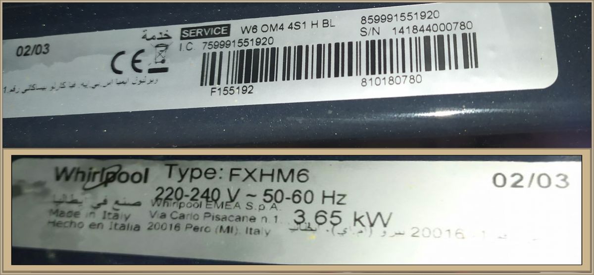

    Oven: Whirlpool 6 Sense model 2019.
    W6 OM4 4S1 H BL
    W6OM44S1HBL
    other marking - type: FXHM6
    - two stickers are visible after opening the door, on the right side, inside.
    After switching on using the touch button, an error is displayed F1 E1 oven failure and squeals loudly throughout the entire house.

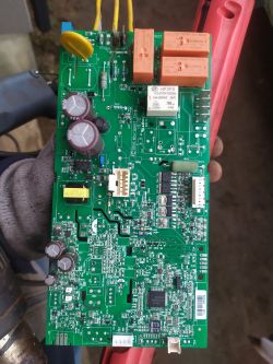

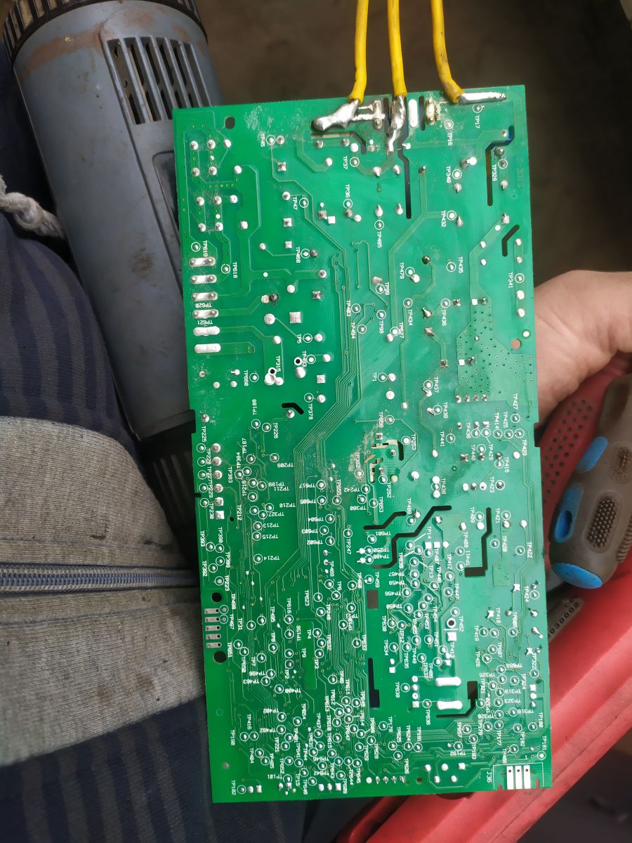

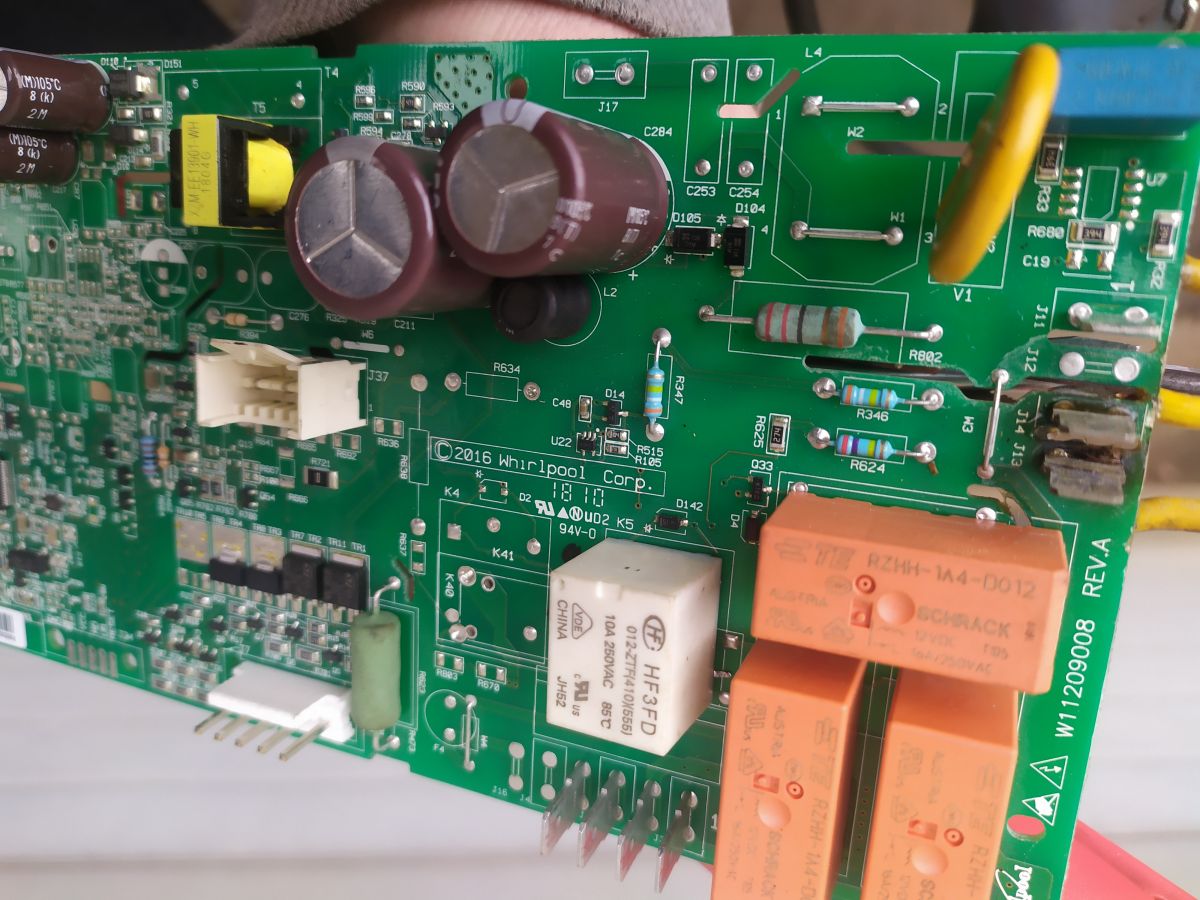

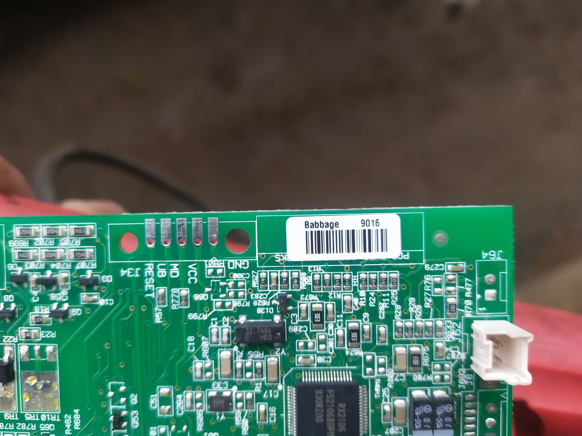

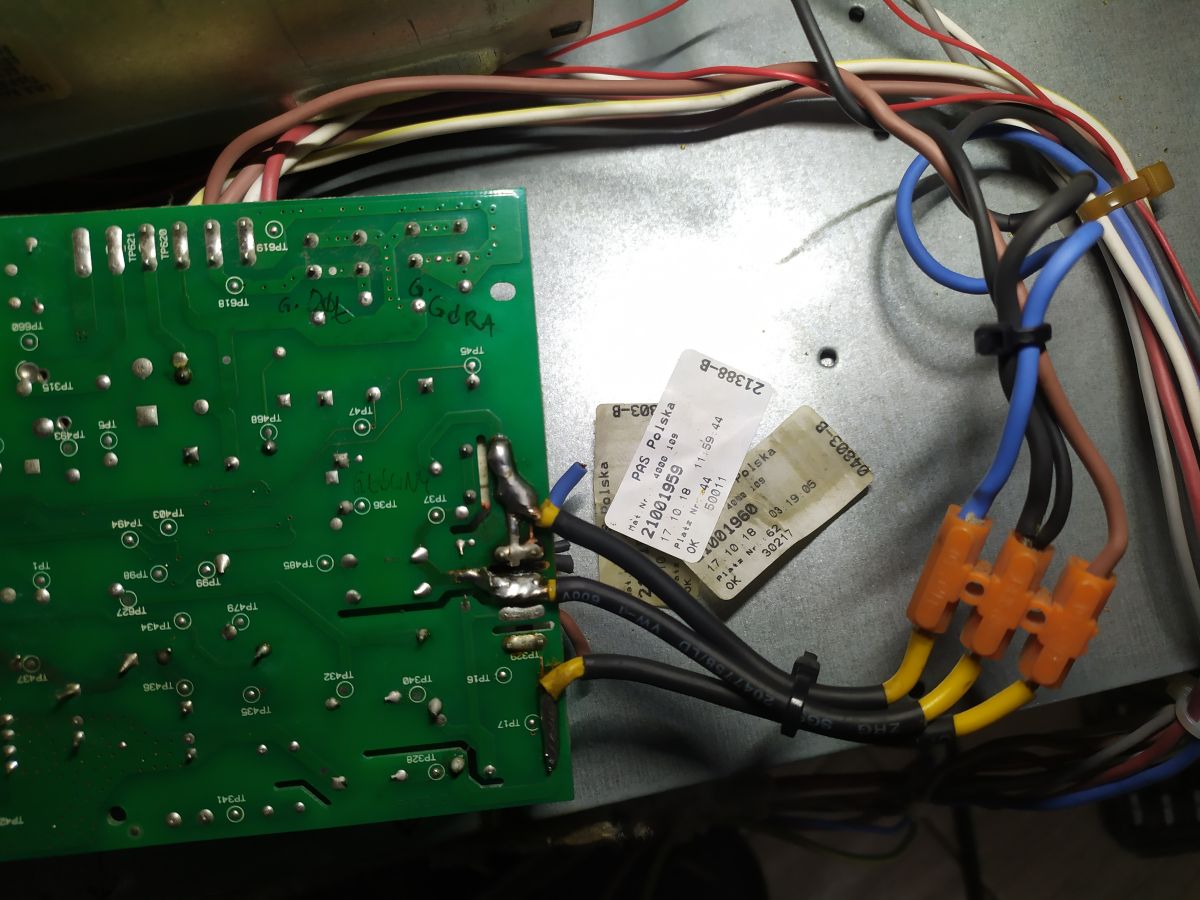

    Dismantled back and top, on top there is a plate with numbers:
    Whirlpool W11209008 REV.A
    Babbage 9016
    Whirlpool W6 OM4 4S1 H BL-(FXHM6 type) - error F1 E1 oven failure solution

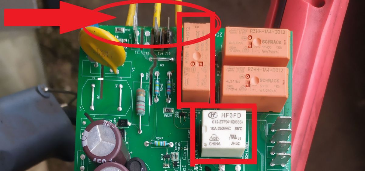

    Everything was soldered, the connectors were checked, it took many hours, finally: Two relays were replaced (white and red - marked) and the melted socket-pin was replaced with a decent ceramic connection cube (yellow cables) - works in a warm environment, there are small children at home - so, of course, you need to make sure there is no puncture to the housing in case the plastic melts :!:
    - everything works as it should :D
    Apparently the connections must be very solid, because it will display an error on the rack and will not start. I will add that turning on the function quickly sometimes allowed the oven to turn on normally, but the error returned the next time it was turned on "uncombined". And if someone was bathed in hot water and the repair didn`t work, I remind you:
    To clear the errors of this oven, disconnect it from the mains for at least 30 seconds.

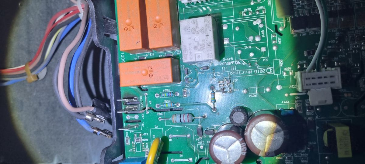

  • Burnt relay and lower heater caused F1 E1 error
    #6 20678261
    pruszek31
    Posts: 29
    Rate: 7
    I will refresh the topic. I had an identical problem and F1 E1 error . On the control board (the one inside the oven under the covers) 1 of the 3 relays was burnt (mine was orange). I replaced these 3 pieces and additionally 1 smaller white one, which is used to turn on the control. Additionally, the main cause of damage to this 1 relay was a burned-out lower heater. The front panel was functional. As a hint - I disconnected two wires from each heater and checked whether the error occurred, and it was determined that the lower heater was damaged - unfortunately my meter did not show a short to ground on this heater. Be careful, because the test was under high voltage. The cost of 4 relays in an electronics store is PLN 60, and the cost of a new heater in an online home appliances store is PLN 65. The oven works like new.

  • Heater resistance measurements and relay mapping for burnt plug
    #8 21815787
    Boleslaw666
    Posts: 264
    Help: 14
    Rate: 67
    If anyone needs the colours of the wires from the burnt plug and a description of which relay is responsible for what - it's all described with a marker on the PCB.
    PCB board with relays and marker labels for oven heating elements PCB with handwritten labels, wiring, and connectors of an electric oven
    Lower heater resistance 44 Ω, 1150 W (I do not know the number)
    Upper oven heater 2450 W, 22 Ω, 481010568824 part number
