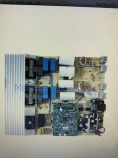

  • #3 19429766
    SergeyM
    Hello. I have the same error F40 and same model of the induction cooker. What kind of payment is shown in the photo. Which one is the power control board.

  • #4 19533148
    Barthezz1976
    Level 19  
    Posts: 254
    Help: 24
    Rate: 164
    Has someone managed to solve this problem? The fields on the right also show F40.

  • CPU crash causing right-side module fault
    #6 19533189
    Barthezz1976
    Level 19  
    Posts: 254
    Help: 24
    Rate: 164
    Moderated By TONI_2003:
    ? Quote selectively or not at all when you reply after the person quoted!
    When the CPU crashes, the meter will do nothing, and it looks like it, because the board becomes stupid after turning on. Turns the right fan on at full power and turns it off after a while. NTC sensors OK, the voltage coming from the left module that goes through the control panel to the right damaged module is also good. Sometimes the same error has completely different glitches.

  • IGBT and gate control are worth repairing
    #10 19533234
    Barthezz1976
    Level 19  
    Posts: 254
    Help: 24
    Rate: 164
    Piotr2608 wrote:
    I'm not going to lead anyone out of this mistake. The lion's share of these modules was salvageable and repairable.
    Now it's a bit more difficult because there are problems with obtaining the MCU.
    Rather, most of it is shit. Unless you want to replace most of the damaged diodes and transistors on the CPU board, including the CPU. When I find photos, I'll show you.
    Here, the only thing that pays off to repair is igbt and gate control.

  • F40 likely originates on the MCU board
    #13 19682873
    Amizaur
    Posts: 23
    Rate: 8
    If, after switching on, the board immediately starts the fan and the red diode on the controller board is flashing, the heat sink NTC may be shorted. To check it, it is enough to carefully shorten its legs with a screwdriver, which causes such reactions. Although the NTC error seems to have a different number. I have - "F-34 - NTC Heat sink short".
    The F-40 is described simply as "IPC damaged - replace IPC".
    I currently have an F40 error on the right fields of the Teka IR641 HAH-6000AB-1 board and I have already eliminated both the heat sink NTC fault, the communication error (works fine), faulty voltages (all except 5v slightly lower but rather normal), relay error, incorrect programming of the control panel .... I suspect that the source of my error F40 is on the MCU board because after transferring it to another induction module, the error "moved" with it ....

  • Processor-area fault on the top control board
    #15 19687510
    Amizaur
    Posts: 23
    Rate: 8
    Well, I more or less figured it out, because I'm stubborn.
    I made sure that the failure is on the top plate by simply swapping (soldering) the left and right plates. The error again went to the plate.
    Then I tried to freeze and heat various elements on the plate and when heating the center of the plate near the processor, the error disappeared for a while. For 15 seconds. Then it always came back. I sold it with a hot air and no changes (I had no hope, February was pretty good on the eye). In the end, tiring me, I came to the fact that the F-40 error changed into the F-47 - so now I have no communication, but it would be nothing ...
    I know that there are error numbers dedicated to a processor or EEPROM error and I was hoping for failures other than the procek, but probably not every failure can be classified so accurately by the system.
    The board goes for scrap or for parts, because modules for this model are not available. You can find the used, similar ones, but the upper plate will not translate, because it fell, and I do not know how much a similar version of the software would have to be for it to work ...
