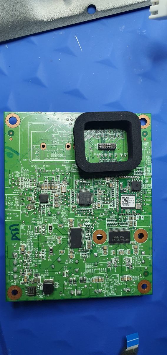

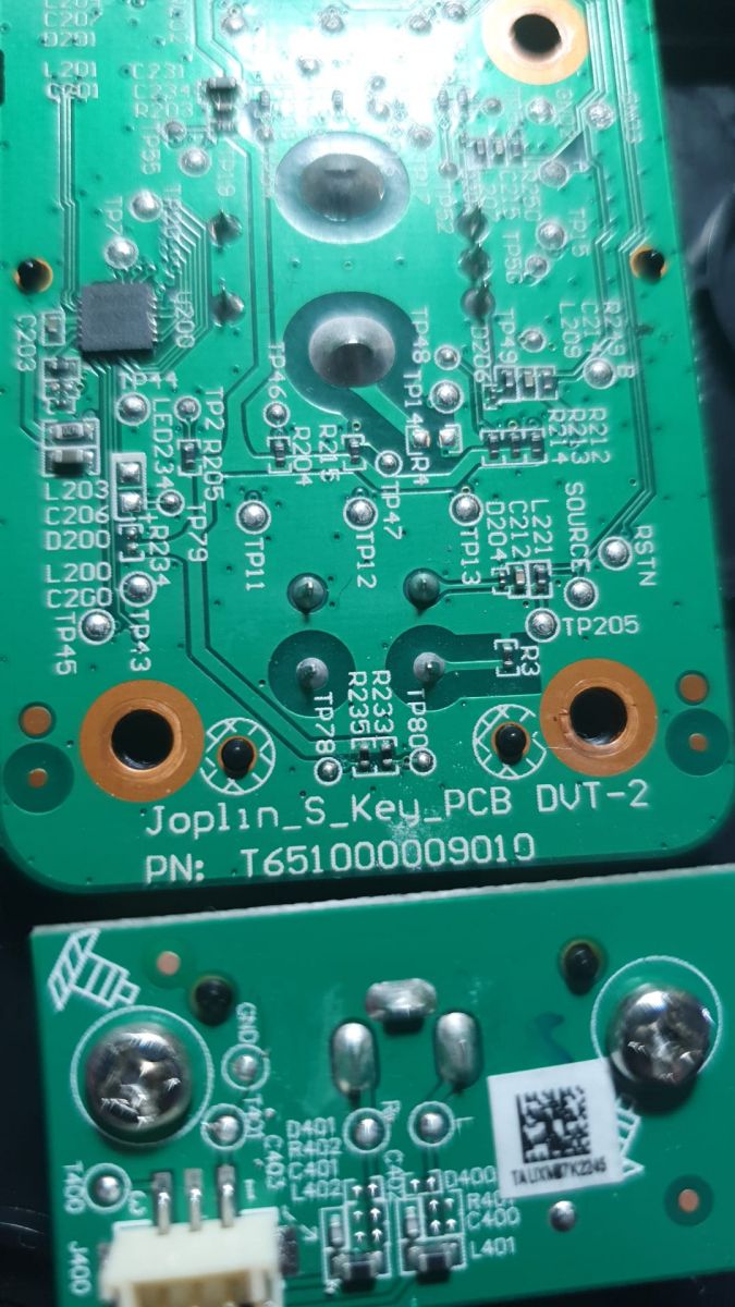

    I have Marshall Acton II column, it does not give anything, not even sound,

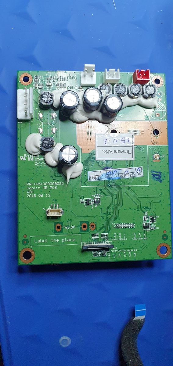

    without the LEDs. I've already disassembled it and I've been checking, it has 18V at the output of the power supply that connects the main board.

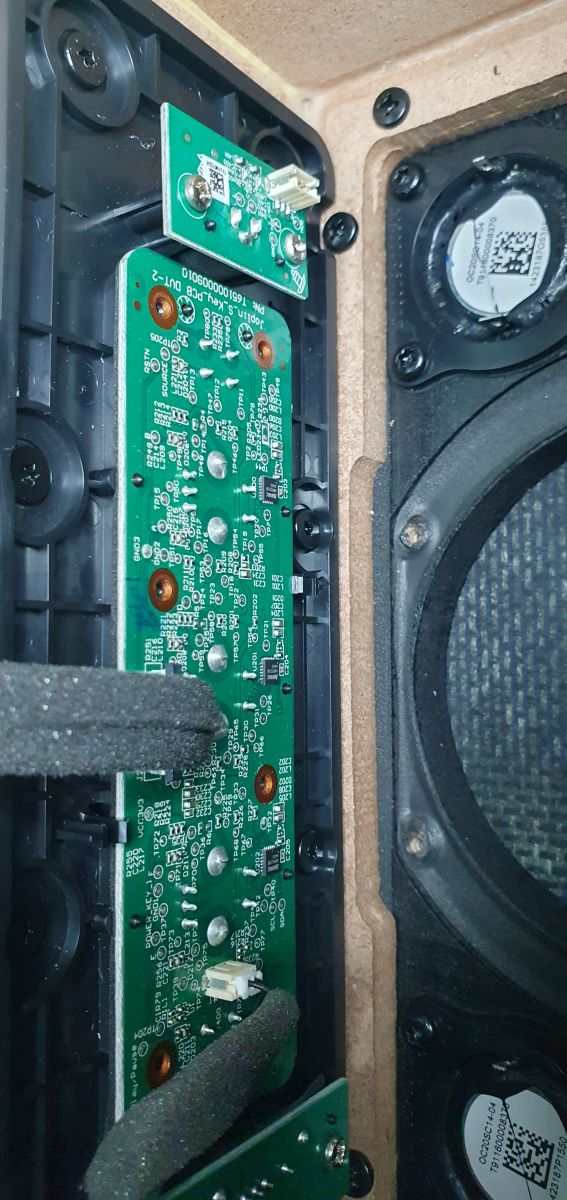

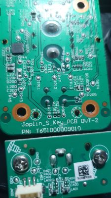

    From the main board connect the board where we have power button and sound control, bass, treble ....!

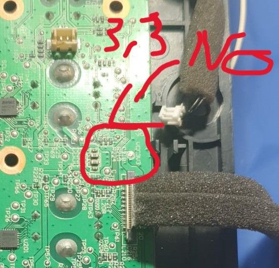

    And on that board there should be a voltage of 3.3 V at a point that comes from the main board and there isn't...
    I've tried to see voltages on the main board. The BT module turns on because I can detect it with the phone and turn it on but there is no sound (nor the LEDs on the top plate, as I said)
    Does anyone have any help? any schematics for this column? I'm desperate ...

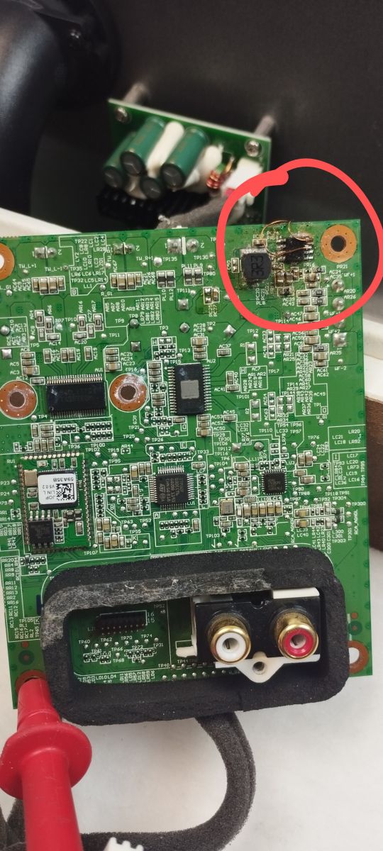

    Try changing the 3.3V voltage regulator TPS54335A. I have a short circuit on it. I replaced it, got 3.3V but it still doesn't work. Maybe you will have better luck!
    Close-up of a PCB with a marked area indicating a fault.

    3.3V worked but unfortunately I was unlucky, the processor had no life. I replaced the entire board because there was no time to look for a solution. The customer was demanding and didn't want to waste time.

    >>21502227 There is a small quartz crystal oscillator next to the processor that gives it a clock. Measure (best with an oscilloscope) whether it has a sine signal. I don't remember what frequency it was, but it has a label. In my case, there was nothing and the processor had a 3.3V power supply after replacing the voltage regulator. The assumption was that it was damaged due to a regulator breakdown. Oh yes, I forgot to mention that the problem is also possible in the firmware. As I wrote, I didn't have much time to investigate because of an impatient customer. Be sure to check that there is no other short circuit anywhere else in the second power supply if your 3.3V is active. The output amplifier can also cause a problem because it is most often damaged and the protection does not allow the device to turn on.
