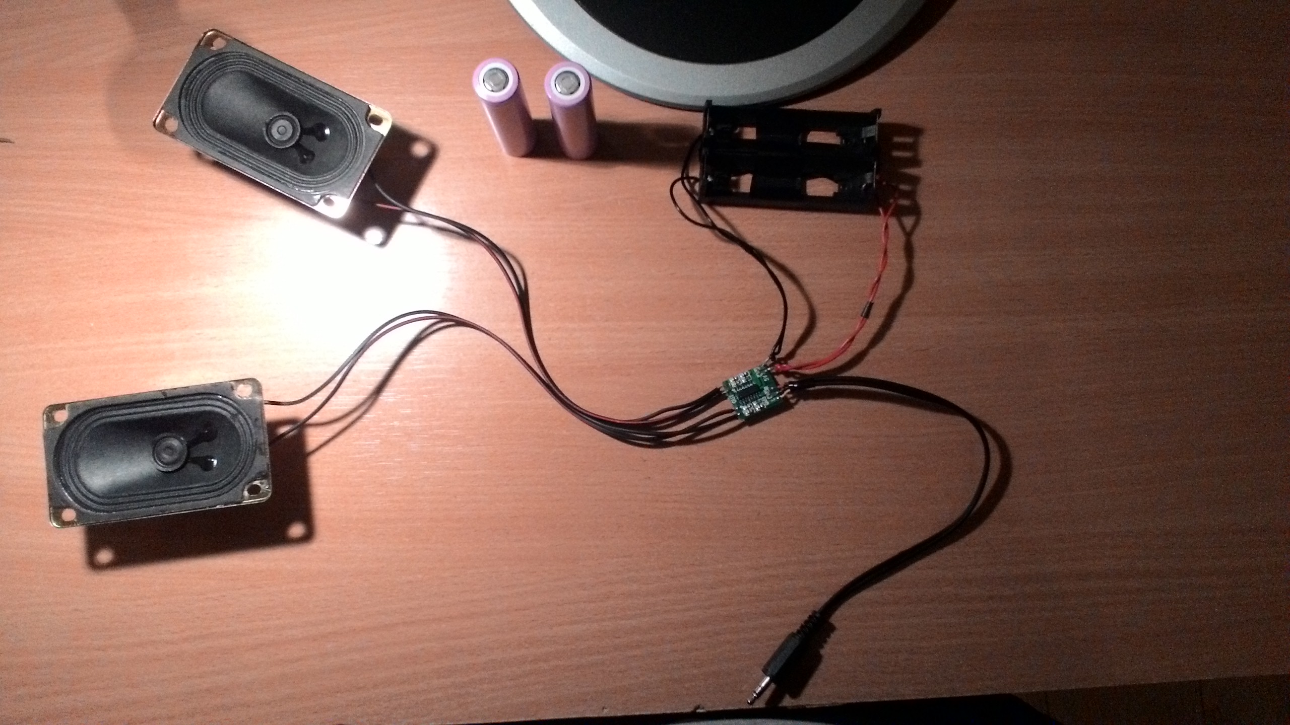

    I recently made a bluetooth speaker on the PAM8403 amplifier. Unfortunately .. there is a problem, namely with "tickling" speakers (I don't know how to describe it otherwise). I thought I was getting a "Mass Loop" so I modified the circuit in all sorts of ways. I have no idea what the reason is, that's why I'm writing here.
    Below I present a short video of how it all works after switching on. Unfortunately, I cannot record how the loudspeaker sounds, because it will disconnect my music while recording.
    [movie: a37dc16403] https://filmy.elektroda.pl/19_1501749043.mp4 [/ movie: a37dc16403]

    this amplifier is unfortunately like that .... bridge the input with a resistor, e.g. 10K and see /

    I suggest you to familiarize yourself with the catalog data of this system.
    You didn't include the schematic, but the image emerging from the video shows you may have a problem with the power supply.

    - The resistors did not help, and I have the impression that it is starting to twitter more. Instead of a relatively light sound "trr yyy yy" there's a little louder "prr yy", however it sounds.
    @krzysiek_krm
    - The PAM8403 amplifier is powered by two Samsung cells:
    Full name: AkumuIator 18650 ICR18650-26H Samsung 2.6Ah Li-Ion

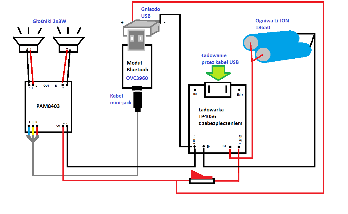

    As for the scheme, it looks like this:
    PAM8403 Amplifier Bluetooth Speaker: Tackling 'Tickling' Sound & Mass Loop Issues
    Added after 13 [minutes]:
    After desoldering the resistors, the speaker still squeaks.
    I guess it could be either BT's or Jack's fault.

    rnb_bolii wrote:
    The amplifier needs a 5V power supply.
    Not necessarily, the documentation of the system shows that from 2.5 V to 5.5 V, although at lower supply voltages, it may cut signals with a larger amplitude.
    The documentation also shows that the power supply must be blocked also capacitor with a larger capacity, it is nowhere to be seen on these boards, so you probably need to solder it personally.
    The power supply of such an amplifier should be connected with as short as possible cables with a sufficiently large cross-section , this spider of thin wires can act quite unpredictably.
    The problem may be the BT module, if it has a USB socket, it can be provided with a voltage of 5 V, the power supply from the cell (maximum 4.2 V) may be too low.
    What's that little rectangle in the schematic?

    Which exactly rectangle? the one at the bottom (red and black)? this is a switch

    Maybe first check that the BT module works properly with the supply voltage from cells connected in parallel. Connect headphones instead of an amplifier.

    Łukasz7929 wrote:
    I do not know if I understood correctly, I should connect the akku in parallel -> disconnect Jack from the amplifier -> connect the headphones with the jack?
    Originally you have two cells connected in parallel, they cannot be connected in series because the voltage will be too high for the amplifier.
    To determine if the problem is an amplifier or a BT module, eliminate the amplifier for a while and connect headphones to the BT module output. Maybe it needs a 5V power supply, you can get from 2.8V to 4.2V from the cells currently connected in parallel, depending on the charge level.
    If the headphones sound bad, just in case power the BT module from 5V via the USB connector. If it is still bad - the module is probably damaged. If it is fine with 5V and 2.8V - 4.2V it will be bad, it means that the BT module requires 5V power supply.

    I connected the headphones connected to BT to the charger from the phone and I will say that the sound is ok. There is no noise. On the first volume level you can hear a slight murmur, almost inaudible, and this is ok.
    This shows that the BT module is generally functional and undamaged.
    Now try to power the BT module with a single cell (or as in your original system with two cells connected in parallel, it does not matter, with a parallel connection it is still the voltage of a single cell). It would be best if you would charge this cell "fully" and test the power supply of the BT module while checking the voltage of the discharging cell, I hope you have a voltmeter. At a certain voltage of this cell, the BT module may stop working properly (or not), you will have another test performed - the range of permissible supply voltage of the BT module. When this is known, we will consider further.
