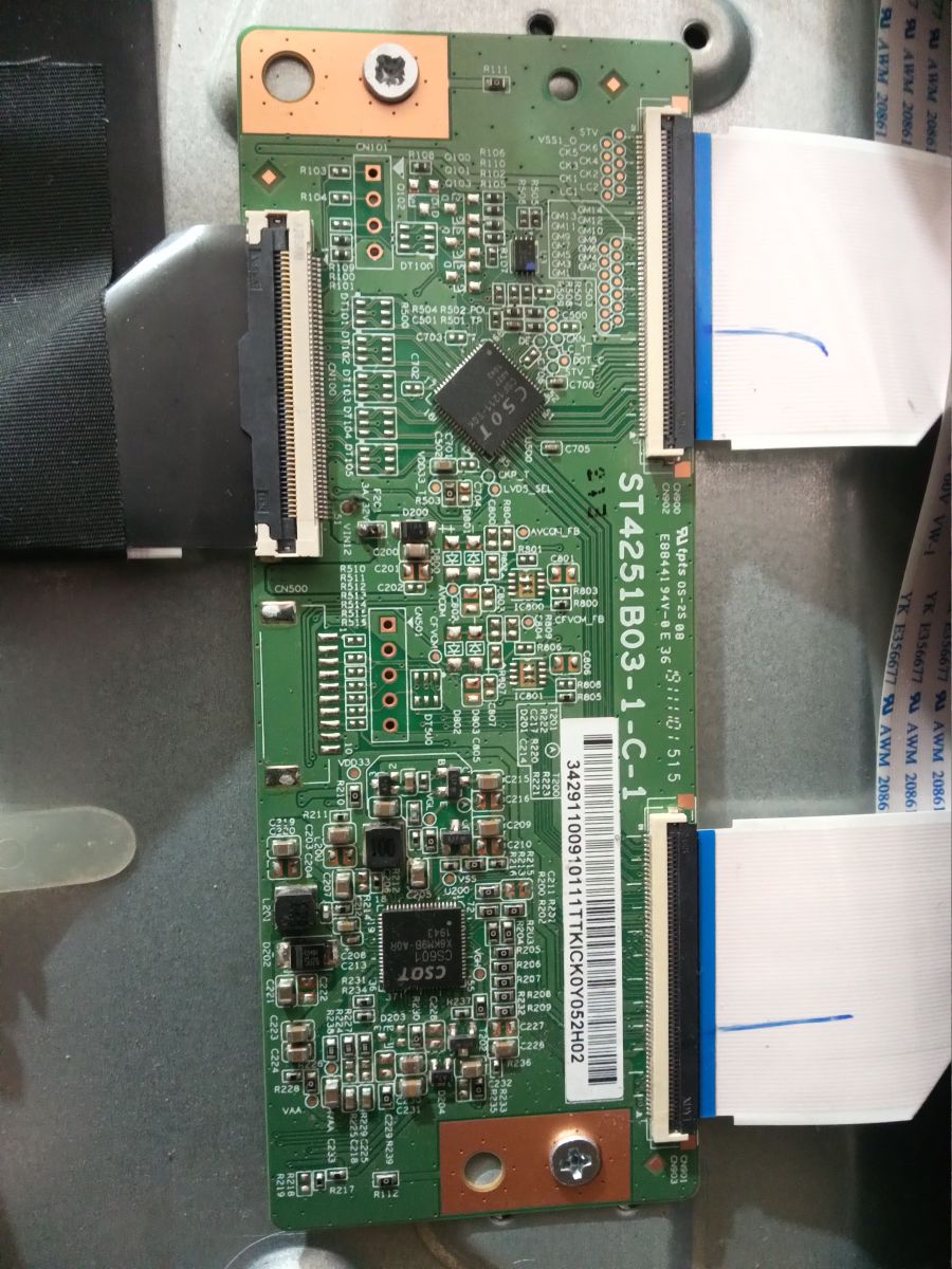

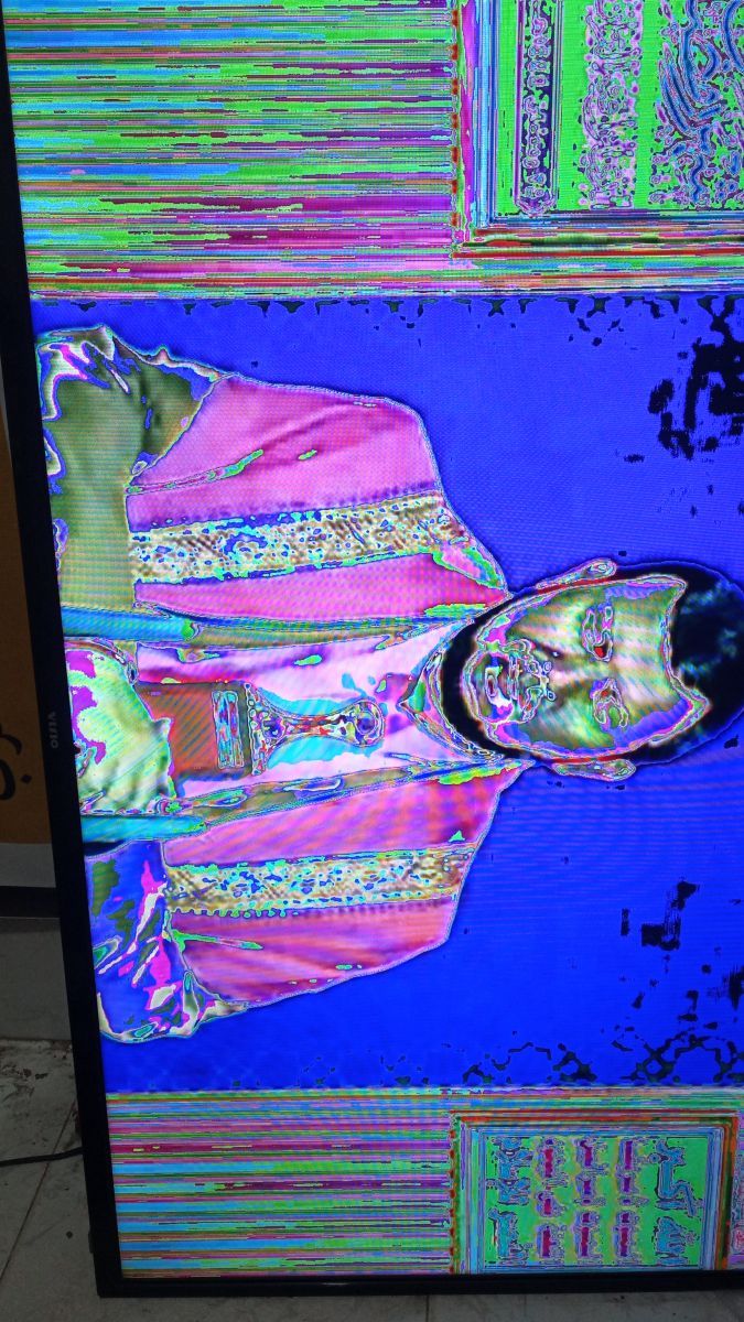

    Need Firmware for Visio 43k92fs (Bad Update) – 358M3C2 Motherboard, LK430WDD1 Panel Visio 43k92fs (Bad Update) – 358M3C2 Motherboard, LK430WDD1 Panel bad image

    Change the LVDS format to TCON.

    LVDS_SEL pin 9 determines panel voltage mode

    For this, tell me the matrix model. If you have 30 pins, then, as a rule, it is pin 9 of LVDS_SEL. If there is a logical unit on it, put it on the ground. If there is 0, then put 5 volts through the 1k resistor.

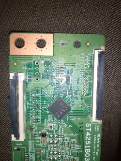

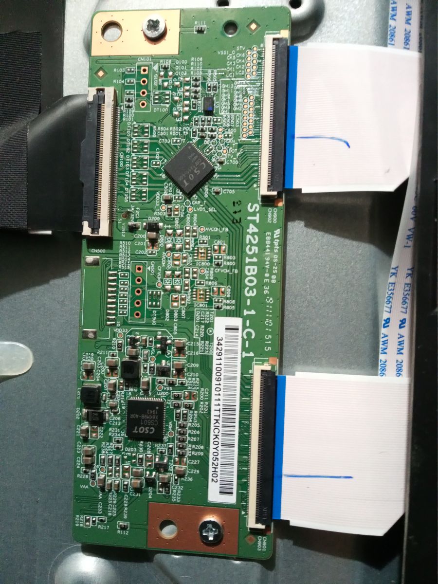

    Visio 43k92fs (Bad Update) – 358M3C2 Motherboard, LK430WDD1 Panel bad image Visio 43k92fs (Bad Update) – 358M3C2 Motherboard, LK430WDD1 Panel bad image Visio 43k92fs (Bad Update) – 358M3C2 Motherboard, LK430WDD1 Panel bad image hello dear
    thank you for your help
    I have 51 pins
    i sent tcon image
    my thanks

    I have matrix Visio 43k92fs (Bad Update) – 358M3C2 Motherboard, LK430WDD1 Panel bad image Visio 43k92fs (Bad Update) – 358M3C2 Motherboard, LK430WDD1 Panel bad image 51 pins
    I have matrix 51 pins
    i sent tcon image
    my thanks

    the problem not resolved !!!!!

    [tex:44b460acd3][/tex:44b460acd3]Here you have what you need, page 22,23 and 25.
    PANEL_ST4251B02-1
