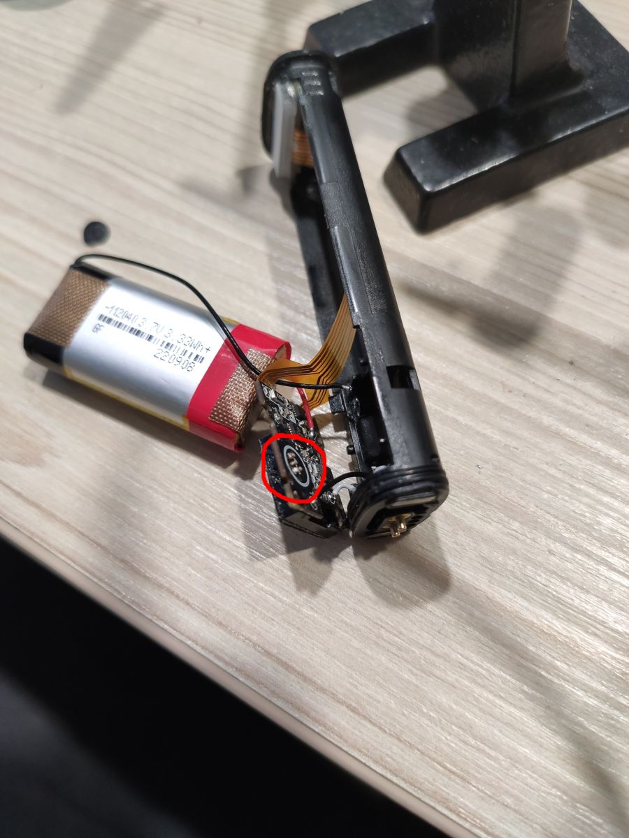

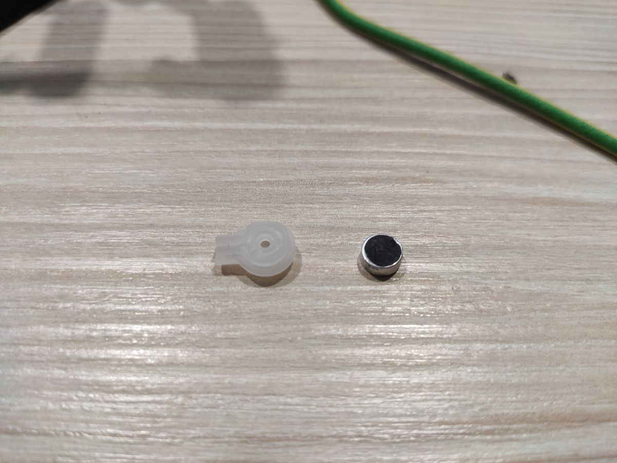

    This is caused by the liquid contaminating the inhalation sensor. I had the same problem, I took the equipment apart and cleaned the rubber band that is located there. Unfortunately this was not enough, so in my case the workaround for the problem was to remove this sensor completely and smoke only from the button. In addition, I sealed the hole from the sensor with hot glue so that the liquid would not run inside.
    A guide on how to take apart the hardware (not mine, you should help yourself with something very thin, such as a razor blade):
    Eraser and sensor:
    A rubber gasket and a sensor lying on a wooden surface.
    Equipment after "repair":
    Interior of a disassembled electronic cigarette showing the battery and the puff sensor, marked in red.
