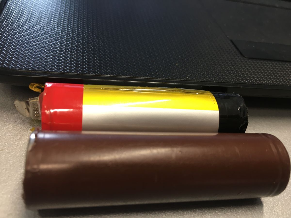

    Hello, I bought the drug in August of that year and it had no problems with it until yesterday. The battery started to heat up very much after charging and it was only enough for + - 30 bombs when fully charged, now it is completely dead and cannot be charged, hence my question, is it possible to replace the battery in drag s, if so, I would be grateful for your help.

  • #6 19379435
    Angixccx
    How to open it: You take out the plugs from the bottom, the ones that are used to prevent the bottom of the cigarette from scratching. There are screws under two of them, you unscrew them and pull out the bottom, you have to be careful, because you can break the cable connecting the battery with the panel
  • #7 19509477
    DADSADSAD
    Posts: 10
    Rate: 13
    Voopoo Drag S Battery Replacement: Overheating & Short Lifespan Issue - Can It Be Changed?
    there is a link 19600 if someone has a link to the store where I can buy such a link, please, I replaced it with another link that is smaller, so far it works, my problem is that it turns off and hangs the old link is swollen and the 18650 is a bit too long for some 3 mm

  • #12 19616580
    DADSADSAD
    Posts: 10
    Rate: 13
    the exchange gave so much that it charges and works, but there is a second problem that turns off and freezes by itself?
  • #13 19650641
    Mikiedbp
    DADSADSAD wrote:
    the exchange gave so much that it charges and works, but there is a second problem that turns off and freezes by itself ?
    It cannot work with this link, because the e-cigarette needs a minimum of 15A
