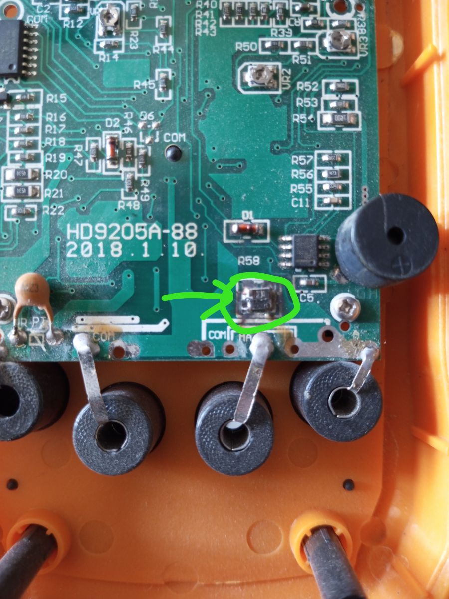

    Close-up of the DT9205A+ multimeter circuit board with burnt resistors marked in green. Hi.
    I have a DT9205A+ multimeter, in which two resistors on the current measurement path burned out and I wanted to replace them. Unfortunately, there are no markings on them. Could you help me find the right resistors that I could mount there?

    I've seen a very similar topic before HERE .
    The resistor numbers will probably be different, but just compare the diagram there with your own device and everything will become clear.

    Unfortunately, that's just the way it goes.
    The cheapest models of meters (if you'll forgive me for calling them meters) are manufactured by dozens of different companies in the so-called Far East, according to their own ideas. The designation may be a matter of coincidence, or what kind of housing you managed to buy cheaply.
    You can count on the lucky chance that someone owning EXACTLY the same meter will see this post and respond. But that's like getting a six in the totem pole. The chances are poor.
    If I were repairing this equipment, I would carefully remove the burned components and try to draw a piece of schematic around this "problem", and then look for analogies among schematics of similar meters. With such a simple patient, it should work.
    Tedious, thankless and unprofitable work - unless we are talking about gaining experience (then the time and effort spent is not in vain).
    This is why I suggested looking at the schematic of a SIMILAR device (because, after all, you can see that it is not the same).
    If you remove the burned components and carefully check what then in the meter does not work, then you may also be able to guess what should be there.
    Of course, if the fault is only one and it is caused exclusively by this burned component.
    All the time I mean didactically oriented activities, because serious repairs are not carried out in this way.

    This is the shunt resistance to reduce the ohm when you measure the current of the circuit. And it parallels a larger resistance. If I remember correctly, R010 Tomorrow I will open my multimeter and send you a picture of this section. The amp is 20 or 10.
  • #6 21158682
    sambagha63
    se sont les résistances R010 ET R018
