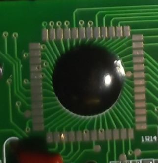

This IC has three sides of 12 pins (connectors) and the other three sides have 12 pins each. How is
Hot_Amir 4560 41
How can I identify a multimeter IC hidden under epoxy and find its exact part number and datasheet?
It is chip-on-board: the actual die sits under the black epoxy blob on the PCB, so the package/pins you see are on the board rather than on a normal IC body [#20875358] In this DT9205A-style meter, the hidden chip is likely an ICL7106 or a clone, and if it is damaged the multimeter is usually not worth repairing economically [#20876115] The replies also said that the exact variant can differ even for the same model, so you need the whole PCB, any markings or other ICs, and a count of the solder pads/pin pitch to match the correct board version [#20875358][#20877472]

    اضافه شده پس از 3 [ساعت] 55 [min]:
    This IC (Multimeter) has three sides (sides) of 12 pins (connection point) and the other three sides have 12 pins each. How is this possible? How can I find the number and datasheets?[/size]
  • #2 20875358
    Posts: 14754
    Rate: 12875
    This is called chip-on-board. The die is on the PCB without any case. It's practically impossible to tell what it does with the current information. Please show the whole PCB, along with possible markings/other ICs on it and also tell us what kind of device is that?

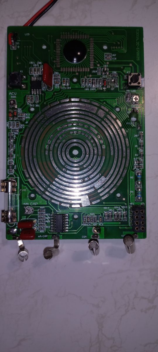

    What is this device with this system? and what do you want to do with it?
  • #5 20875693
    Hot_Amir
    Posts: 139
    Multimeter Repair
    Analog to digital converter IC.
    [پسوند] ۲۰۸۷۵۳۵۸[/پسوند]
    IC Multimeter DT9205a. I searched the internet, but the data is different. IC is an analog to digital converter. Why are the number of bases different?
  • #6 20876115
    sisko
    Posts: 1466
    Help: 307
    Rate: 538
    Underneath this black mud, there is the ICL7106 chip or its clone. If it is damaged, you cannot repair the multimeter. You have to buy a new one.
    This IC has three sides of 12 pins (connectors) and the other three sides have 12 pins each. How isDT9205a_sc..mat.png (118.08 kB)You must be logged in to download this attachment.

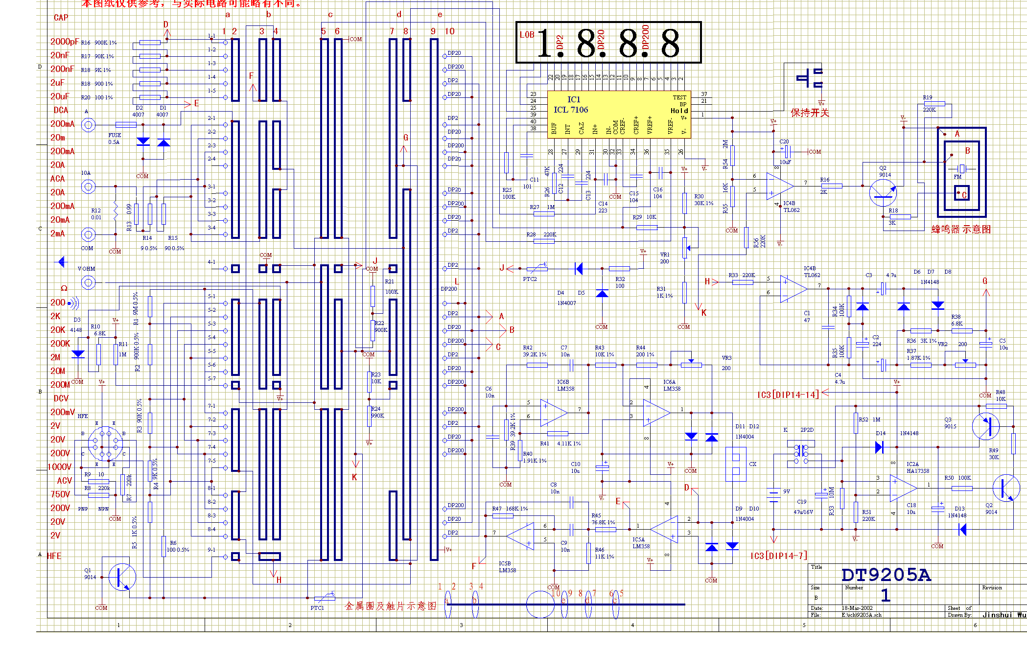

  • #7 20877073
    Hot_Amir
    Posts: 139
    Thank you. I found three Schematic DT9205A on the Internet, but they all differed from my multimeter. What guidance do you take?
    Added after 4 [minutes]:

  • #9 20877103
    ppc
    Posts: 203
    Help: 28
    Rate: 120
    Why not? If you insist, you can grind off the "glue" and solder the ICL7106 in the QFP44 housing, there are solder pads. It makes no economic sense, but you can have fun.

  • #12 20877472
    sisko
    Posts: 1466
    Help: 307
    Rate: 538
    Because this will turn out to be one big tinkering industry.
    First, count how many solder pads there are for the system.
    The size and raster of the pads will probably not match, and the pinout may also be changed relative to the QFP44 housing.

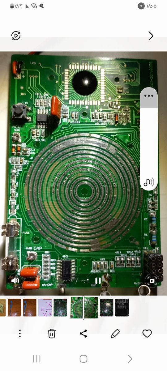

  • #17 20878011
    Hot_Amir
    Posts: 139
    [پسوند]20877472[/پسوند]
    Po policzeniu pola lutowniczego. Jak szukać? Dziękuję
    Added after 6 [minutes]:
    >>20877614
    @ElektrodaBot
    There are many datasheets of my multimeter on the internet, but they all differ, even though the number and model are the same.
    A member of the board suggested that I count the number of solder pads. Do you know how to help me find my multimeter datasheet after counting?
  • Counting solder pads to identify multimeter variant

    Can you use the photo and guide me?
    I can see the photo of your multimeter’s PCB that you've uploaded. It appears to be a fairly standard design with a central microcontroller, range selection via the rotary switch, and various components that contribute to the functionality of the device.
    From the picture, I can identify several key areas:
    1. Microcontroller: The large IC in the middle with many pins is likely the microcontroller, which is the brain of the multimeter, responsible for handling measurements, range selection, and display output.
    2. Rotary Switch: The circular pattern with a lot of solder pads is the rotary switch, which allows you to select different measurement functions and ranges.
    3. Input Jacks: At the bottom of the photo, we can see the input jacks for connecting your probes. These inputs are typically where the input protection circuitry would be located.
    4. Components: There are various resistors, capacitors, diodes, and transistors that all contribute to the measurement and protection circuitry.
    To guide you further, I would need a bit more context:
    - If you're looking for the input protection circuitry, focus on the traces and components connected to the input jacks. You may notice components such as larger resistors, diodes, or PTCs that are a part of this circuit.
    - If you need to identify a particular component like a transistor, you would need to provide its location or reference number printed on the PCB near the component.
    - If you are trying to track down a problem, describe the symptoms, and we can try troubleshooting together.
    Since the specific datasheet for this PCB is not visible from the photo, and the model number isn't provided, I can't provide an exact datasheet. However, if you describe what you're looking to do or find out, I can certainly attempt to guide you with the information visible in the photo.

    Interior of a PCB from a multimeter with spiral tracks. @ElektrodaBot @ElektrodaBot
    Added after 7 [minutes]:
    [پسوند]20878311[/پسوند]
    @ElektrodaBot The DT9205a is a multimeter. It is the manufacturer of Excel. I found some datasheets, but it was different from mine. IMPORTANT: My rotary key has 7 metal attachments or appendages. But in all the datasheets, they had 5 numbers. If I need to send you a photo from the back of the printed circuit board and the rotary key

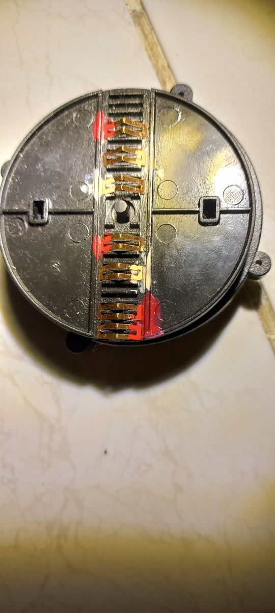

    View of the back side of a multimeter's rotary switch with metal contacts.
    Added after 5 [minutes]:
    @ElektrodaBot View of the back side of a multimeter's rotary switch with metal contacts. https://obrazki.elektroda.pl/7188772400_1703687598.jpg
    [size=9] اضافه شده پس از 5 [دقیقه]: [/اندازه]
    [size=9] اضافه شده بعد از 6 [ساعت] 1 [دقیقه]: [/اندازه]
    @ElektrodaBot چگونه می توانم مخاطبین کلید چرخشی چند متری برگه داده را جستجو کنم؟[/نقل قول]. @ElektrodaBot
