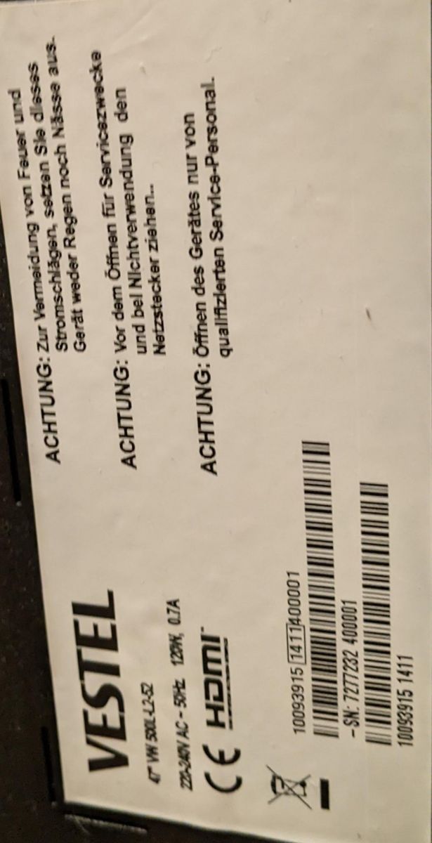

    Hello everybody,
    I got a defective Vestel 47" VW500L-L2-52 TV from a video wall. Label on a Vestel TV model VW500L-L2-52 with warnings and technical specifications.
    After I finished the repair of the power supply (One inductor for the 12V was not soldered correctly). I want to use that as a normal display not in a video wall configuration, because I only have one.
    Looked that TV up and found the RS232/LAN config description as PDF. This also has commands to set the video wall configuration.
    Link
    This TV contains a MB90 and I was able to access port 1986 with telnet.
    I tried a lot commands, but I only get answers on the 'TIME' and 'GET_VOLUME' command. 'RESET' works also, but 'rst' does not.
    Does this MB have different commands? Does it need a firmware upgrade to enable the command?
    Or does somebody know another way to use the TV as a single display.

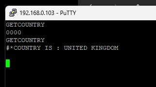

  • #2 21263297
    LOL1986
    I have to enter 0000 before any "Admin Commands" (from that URL link) would work.... i.e.
    GETCOUNTRY
    0000
    GETCOUNTRY
    #*COUNTRY IS : UNITED KINGDOM
