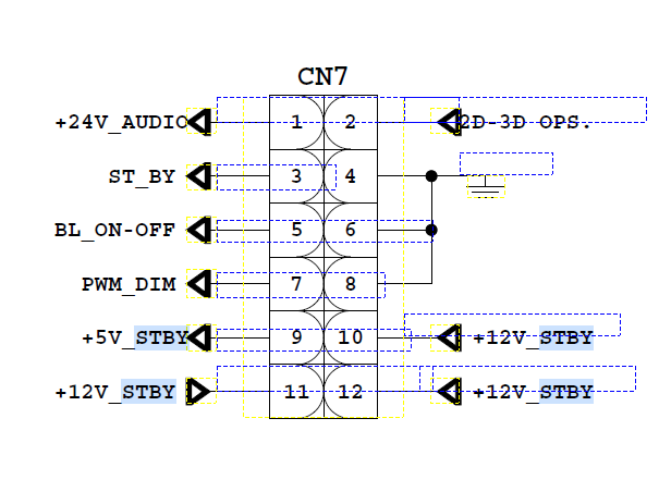

  • Measured motherboard rails and found no 5V standby fault
    #4 20996493
    matrosd
    Here is the further investigation of the problem.
    Sometimes I've managed to turn on the TV. It's just a rare occasion. But at least it does!
    I've checked the output voltages from the power board. All is ok and steady except 5V Standby. As I can see it's designed to have only 12V stnby, as there is no components to provide 5V. All conversion goes in the motherboard.
    CN7 connection diagram with labels for audio, standby, and voltage signals.
    1: 26.9-27.3V
    9: NC
    10-12: 12.18V
    The next step was to check all the conversion and stabilization at the motherboard.
    The input voltages stayed the same. As I said before there is no 5Vstby.

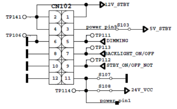

    Diagram of CN102 connector connections on the main board.
    Here is the diagram, that served me as a reference.

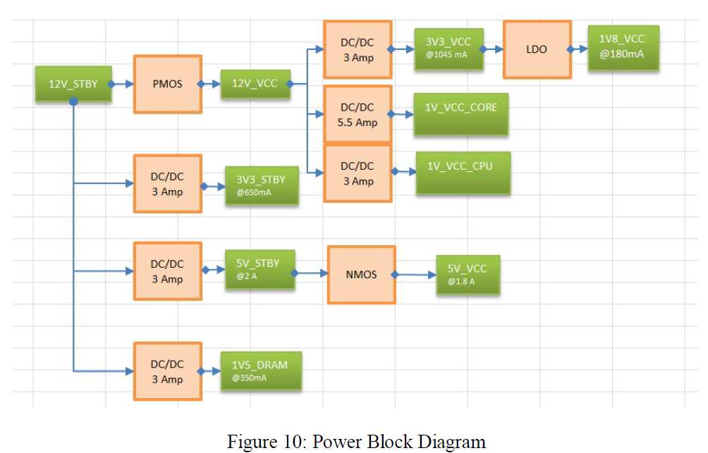

    Power block diagram with various components and voltage values.
    So I tested chips outputs one by one:
    Q101 - 12.15V then drops to 0 when T-con make a sound and goes back to 12.15V
    Q104 - 5.1V
    U101 - 5.15V
    U113 - 3.36V
    U105 - 1.54V
    U106 - 0.99-1V
    U102 - 3.37V
    U120 1.796V
    Didn't find U104 chip, even the numbers on the board. Not sure if it is necessary. For my understanding it is crucial to have CORE working.
    For sure there is no U110, found letters near an empty placement.
    There is a power diagram on the same paragraph. But I have no clue what to do with it since all outputs are ok.

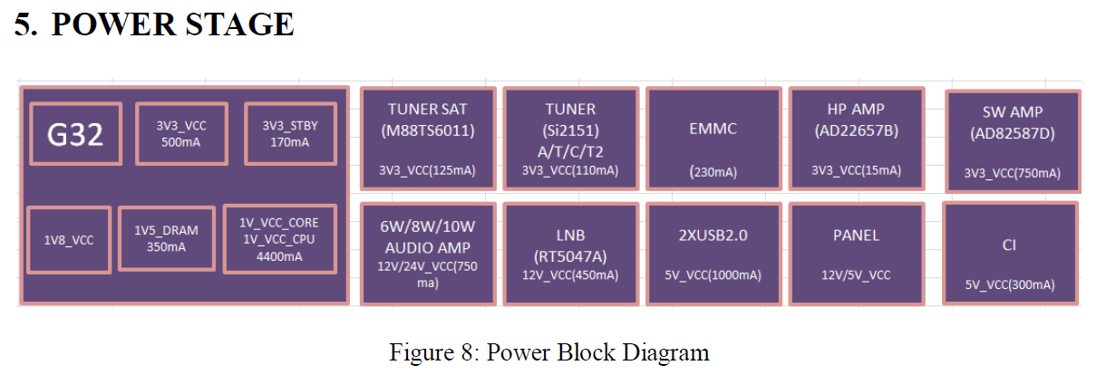

    Power block diagram with components and their voltages.
    Also they have mentioned a problem in the service manual. However I can't connect with UART device right now. Is it really that helpful?
