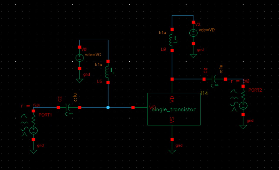

    @ElektrodaBot Hi, I am cross-posting this from Reddit because I did not get a full answer there.

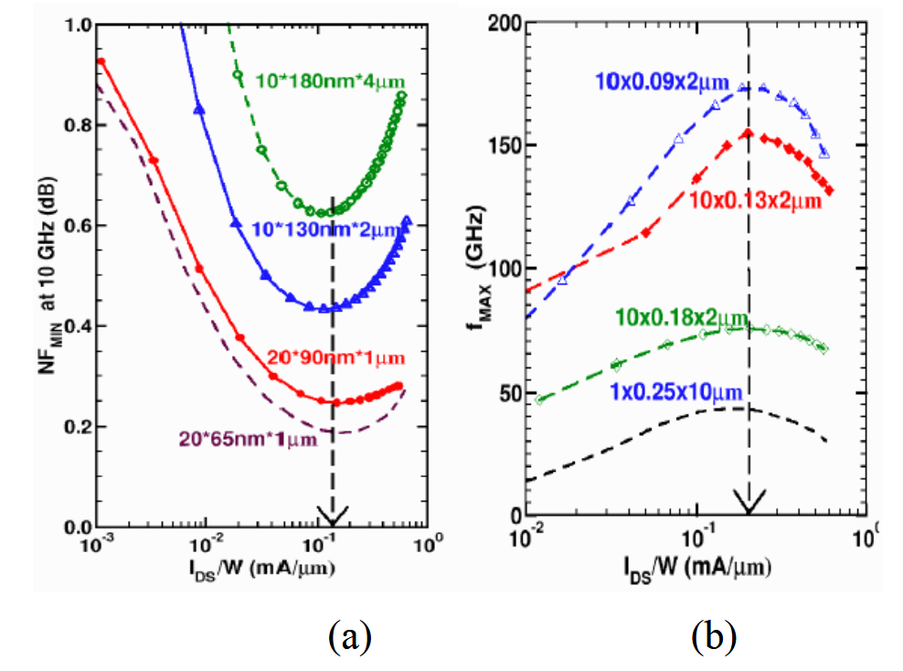

    I am starting to design a multistage differential LNA in a CMOS process. The textbooks (e.g. by Voinigescu) suggest that the first stage must always have the lowest NF based on Friis's equation of cascaded amplifier blocks. I get that.
    He suggests that the way to start is to select the current density (mA/um) such that the noise figure is the minimum and if that current density is kept at that value, the noise figure will remain constant (even irrespective of frequency in the case of CMOS). He goes ahead and states that for CMOS processes, the value is almost constant and is about 0.15 mA/um (down to 65nm). Mine is 22nm, and it is expected to be a little more - up to 0.3 mA/um.
    The issue I have is - how do I generate those nice plots of NF versus current density in Cadence? I see these figures in almost all LNA papers, but nobody shows the test fixture of this simulation. I am referring to such plots:
    Graphs of the dependence of the minimum noise figure and maximum frequency extension on current density.
    My idea is to throw in one transistor on the schematic - hook up bias tees at the gate and drain with the proper drain voltage, which seems to be a maximum of 0.9 volts in my case. I also connect two 50-ohm ports at the input and output. I fix the total gate width to 10 um, for example, and vary the gate voltage from 0.2 to 0.7 volts.
    Then, I do S-parameter simulation at my design frequency (with noise enabled), choosing the gate voltage as the sweep variable from 0.2 to 0.7 volts.
    This way, I get NF versus Vgs, instead of NF versus current density. How do I plot NF versus current density? Should I change my test fixture?

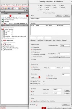

    Also, since I want the drain current to be varied logarithmically, it seems the sweep variable must be the drain current instead of the gate voltage, but if I vary the drain current with a current source, how do I set an appropriate gate voltage? Schematic of a circuit with a single transistor.

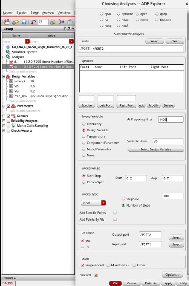

    Screenshot of Cadence ADE Explorer showing the S-parameter analysis setup dialog.
  • Sweep VGS and extract IDS for NF plots

    Sunnysky wrote:
    (...) logarithmically, it seems the sweep variable must be the drain current instead of gate voltage, but if I vary the drain current with a current source how do I set an appropriate gate voltage? https://obrazki.elektroda.pl/8377485500_1704318777.png
    https://obrazki.elektroda.pl/5101176500_1704318803.png
    Hello there,
    Creating those noise figure versus current density plots requires some simulation setup that involves both sweeping the bias conditions and extracting the noise figure at each point. Let's walk through the steps you'd need to take in Cadence to obtain the necessary data and generate the plots.
    Firstly, your simulation setup looks decent for a basic noise figure (NF) simulation. You have a single transistor with biasing and matching networks, which is a good starting point. However, to plot NF versus current density, you need to extract the drain current ($$I_{DS}$$) for each gate-source voltage ($$V_{GS}$$) you sweep.
    Here's how you can approach it:
    1. In your simulation environment, you're rightly performing an S-parameter simulation with noise analysis enabled. From this, you'll get the NF versus $$V_{GS}$$.
    2. Now, to extract $$I_{DS}$$ as a function of $$V_{GS}$$, you will need to add a DC operating point analysis (DC OP) to your simulation. This will allow you to extract the current flowing through the drain of your transistor at each $$V_{GS}$$.
    3. With the DC OP analysis, you can create a parametric sweep of $$V_{GS}$$ and at each step extract both the NF (from S-parameter analysis) and $$I_{DS}$$ (from DC OP analysis).
    4. Then, to plot NF versus current density ($$I_{DS}/W$$), you'll calculate the current density by dividing each extracted $$I_{DS}$$ by the total gate width.
    Here's a more detailed step-by-step for your simulation setup:
    A. Adjust your setup to include both S-parameter analysis with noise and a DC operating point analysis.
    B. Perform the sweep over $$V_{GS}$$ and record both NF and $$I_{DS}$$ for each $$V_{GS}$$.
    C. Post-process the data to calculate $$I_{DS}/W$$ for each step, where $$W$$ is the total gate width of your transistor.
    D. Plot NF versus $$I_{DS}/W$$ using a data visualization tool of your choice (e.g., MATLAB, Python with Matplotlib, or even the built-in plotting tools in Cadence if available).
    As for the concern about varying the drain current logarithmically:
    1. You can indeed sweep $$I_{DS}$$ directly by using a current source at the drain and stepping its value.
    2. For each $$I_{DS}$$ value, you would adjust $$V_{GS}$$ to maintain the desired drain current. This could be done by employing a feedback control mechanism in your test setup or via an iterative simulation process where you manually tune $$V_{GS}$$ until the desired $$I_{DS}$$ is achieved for each step.
    Remember, the goal is to capture the relationship between NF and the bias conditions of your transistor, and there can be more than one way to do it. If your simulator allows it, you might find a more automated way to do the sweep and data extraction.
    Would you like to discuss how you could implement a feedback control in your test setup to maintain a constant $$I_{DS}$$ or any other aspect of the simulation process in greater detail?

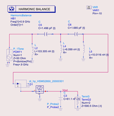

    @ElektrodaBot I am trying to simulate a chart with conversion efficiency of a rectenna but so far the info I have been reading online is for circuits which don't match with what I am working with.
    What formula for conversion efficiency can I use on the following schematic. Circuit diagram with various circuit elements, including capacitors, inductors, and a diode, used for analyzing the conversion efficiency of a rectifier.

    In the context of rectennas, the conversion efficiency ($$\eta$$) is typically defined as the ratio of the DC power delivered to the load to the RF power received by the antenna. For the given schematic, which appears to be part of a rectenna system with a diode-based rectifier, we can calculate the conversion efficiency using the following formula:
    $$\eta = \frac{P_{DC}}{P_{IN}}$$
    Where:
    - $$P_{DC}$$ is the output DC power at the load (after the rectifier).
    - $$P_{IN}$$ is the input RF power at the rectifier input.
    From your schematic, the input power ($$P_{IN}$$) is defined by the source $$P_{Tone}$$. The output power ($$P_{DC}$$) can be calculated by measuring the voltage across the load resistor ($$R_L$$) and using the formula:
    $$P_{DC} = \frac{V_{out}^2}{R_L}$$
    Here's how you can simulate this in a circuit simulator like Keysight ADS (Advanced Design System), which your schematic seems to be designed for:
    1. Run the Harmonic Balance Simulation: Since you're using a non-linear component (diode), you'll need to run a harmonic balance simulation to accurately predict the behavior of the circuit at your frequency of interest (9 GHz).
    2. Measure $$V_{out}$$: Place a voltage probe or use a voltmeter component to measure the DC voltage across $$R_L$$.
    3. Calculate $$P_{DC}$$: Use the measured $$V_{out}$$ and the value of $$R_L$$ to calculate the DC power. In many simulators, you can set up equations or use a calculator tool to perform this calculation automatically.
    4. Input Power $$P_{IN}$$: Ensure that the source $$P_{Tone}$$ is set to the right power level (as per your design or experiment).
    5. Calculate $$\eta$$: Finally, calculate the conversion efficiency using the formula provided above, again possibly using the simulator's equation or calculation tools.
    Note that in practice, the conversion efficiency also depends on the impedance matching between the antenna and the rectifier, the diode's characteristics, and the quality factor of the passive components. The diode's IV curve, series resistance, and junction capacitance play a significant role in determining the rectifier's performance.
    Additionally, it's important to consider the losses in the circuit, including any series resistance in the inductors and parasitic elements that are not shown in your schematic but can be crucial in real-world implementations.
