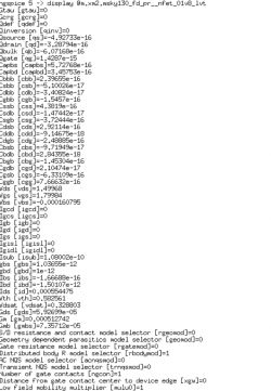

    @ElektrodaBot please design a FET LNA.
    Vdd = 1.8V, gain > 15dB, NF < 3dB, f = 4-5GHz, choose gm, Id, and how to design adding fingers at the gate terminal to decrease Rg and decrease NF.
    Screenshot showing simulation parameters of nMOS transistor in SPICE software.
    Screenshot displaying simulation data in a circuit design program.

    Designing a field-effect transistor (FET) low noise amplifier (LNA) involves several steps, including device selection, biasing, and matching network design. Your requirements are for a supply voltage (Vdd) of 1.8V, a gain greater than 15dB, and a noise figure (NF) less than 3dB, operating at a frequency range of 4-5 GHz.
    Let's start by discussing the selection of transconductance (gm), drain current (Id), and the use of multiple gate fingers to reduce gate resistance (Rg) which ultimately helps in reducing the noise figure (NF).
    Selection of gm and Id:
    1. Transconductance (gm): The transconductance is a key parameter as it relates to the gain of the amplifier. High gm improves gain but can also increase the noise figure and power consumption. The gain (Av) of a common-source FET amplifier can be roughly estimated by Av = gm * Rd, where Rd is the drain resistance. To achieve a gain greater than 15dB (which is equivalent to a linear gain of 5.62), you need to ensure that the product of gm and Rd is at least 5.62.
    2. Drain Current (Id): The drain current is related to gm through the equation gm = Id/Vov, where Vov is the overdrive voltage (Vgs - Vth). Since you have a power supply constraint of 1.8V, you have to choose Id carefully to avoid exceeding this supply voltage after accounting for the voltage drop across Rd and the transistor's Vdsat (saturation voltage).
    Decreasing Rg by Adding Fingers:
    Increasing the number of gate fingers can help decrease the gate resistance, Rg, which in turn can reduce the noise figure. The total gate resistance is roughly proportional to the number of fingers, with more fingers leading to lower resistance. The process involves dividing the gate into multiple parallel channels (fingers), thus reducing the length of each channel and the associated resistance. However, there are practical limits to the number of fingers that can be used, as this can increase parasitic capacitances and complicate the layout.
    Design Steps:
    1. Select an appropriate FET device with specifications that can meet the requirements at the operating frequency range of 4-5 GHz.
    2. Estimate gm: For a target gain greater than 15dB and given the load you will be driving, estimate the required gm. This will also depend on the chosen device's characteristics.
    3. Determine Id: Based on the estimated gm and the relation between gm and Id, determine the appropriate drain current. You must ensure that the power consumption is within acceptable limits and Vdsat is below Vdd.
    4. Design the input and output matching networks to achieve the desired input and output impedances, typically 50 Ohms for RF systems.
    5. Simulate the LNA design using RF simulation software to check if the gain and noise figure requirements are met across the frequency band of interest.
    6. Optimize the number of gate fingers for the best trade-off between noise figure and parasitic capacitance. More gate fingers will reduce Rg but increase parasitic capacitances, which can impact stability and bandwidth.
    7. Finalize the layout considering the effects of all parasitic elements and ensuring that the amplifier is stable across all operating conditions.
    Could you provide the specific process technology parameters or the FET model you are using? This information is essential for more accurate gm and Id selection and to determine the feasibility of the desired specifications within the given technology constraints.
