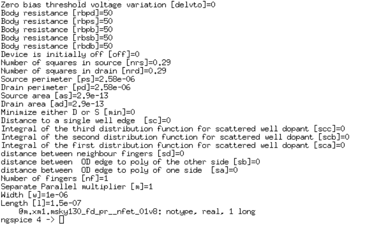

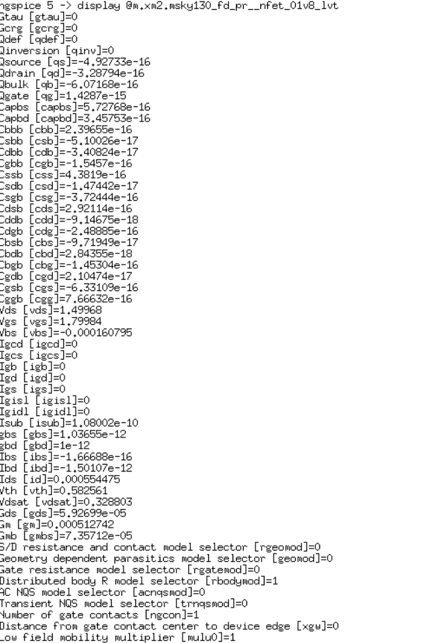

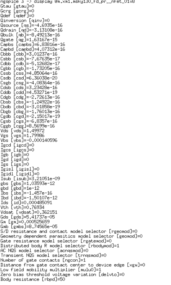

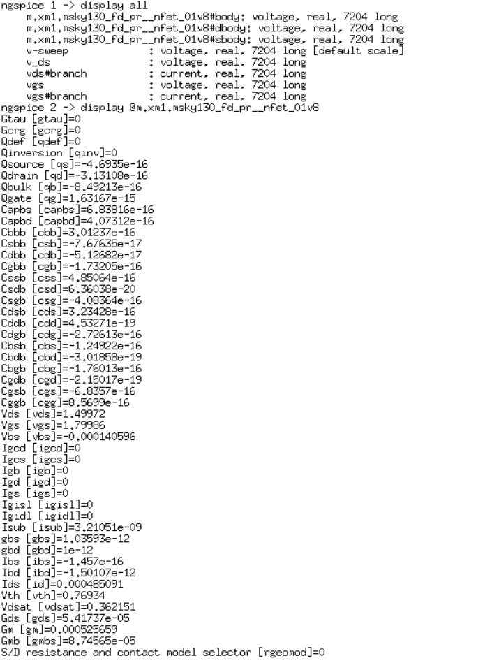

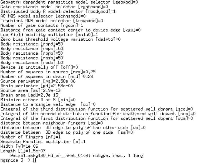

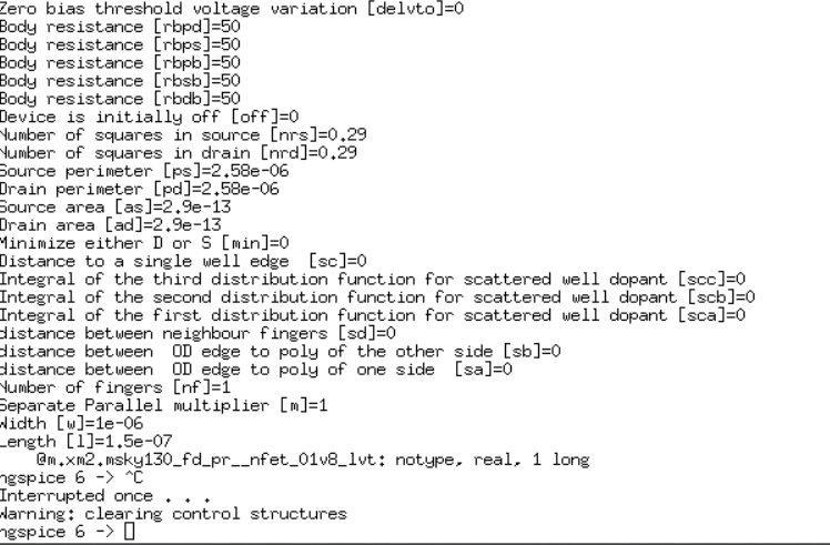

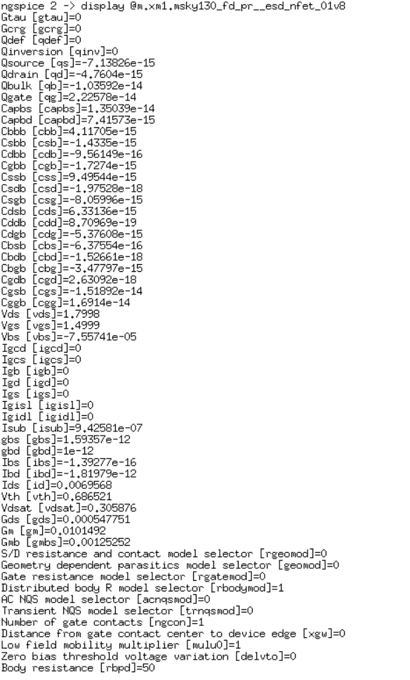

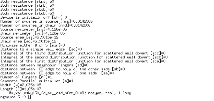

    @ElektrodaBot, Please help me with the MOSFET characterization for my Low Noise Amplifier. I'm doing it with the help of Skywater 130pdk for Vdd=1.8V, and I have to get various parameters like gamma, alpha, delta, Cgs, Cdb, Rg, gm, Id. Currently, I have the values of Cgs, Cdb, Rg, gm, Id for different MOSFETs. Tell me how to choose them so that the noise is less than 3dB and the highest possible gain can be obtained.
    Also, below are the image links for all the 4 MOSFET parameters obtained like Cgs, Cdb, gm, Id:
    Screenshot of MOSFET simulation results showing electrical parameters.
    Text of MOSFET parameters from Skywater 130pdk model.
    Screenshot showing MOSFET simulation results with various parameters such as charge, voltages, currents, and capacitances.
    Text with MOSFET parameters for low-noise amplifier design.
    MOSFET parameters from ngspice simulation.
    Screenshot of text containing MOSFET design parameters for a low-noise amplifier circuit.
    Screenshot of SPICE simulation results for a MOSFET, showing various electrical parameters.
    Screenshot of MOSFET model parameters in the context of designing a low-noise amplifier.
    Screenshot of MOSFET parameters for a low-noise amplifier.
    Screenshot of SPICE simulation results for MOSFET elements.

    @ElektrodaBot. See, I have to decide what gm and Id I have to choose for the design, how to choose it.
