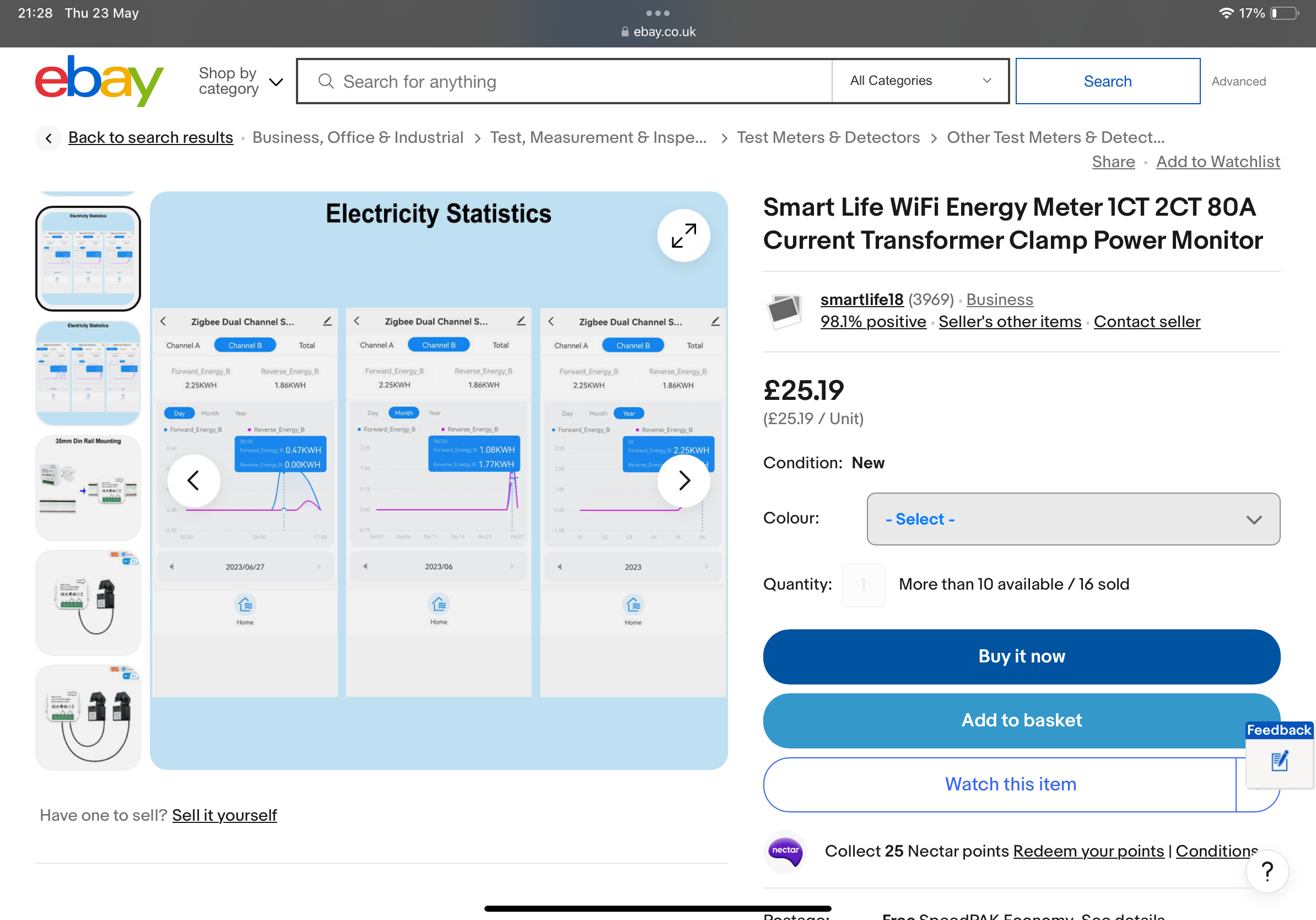

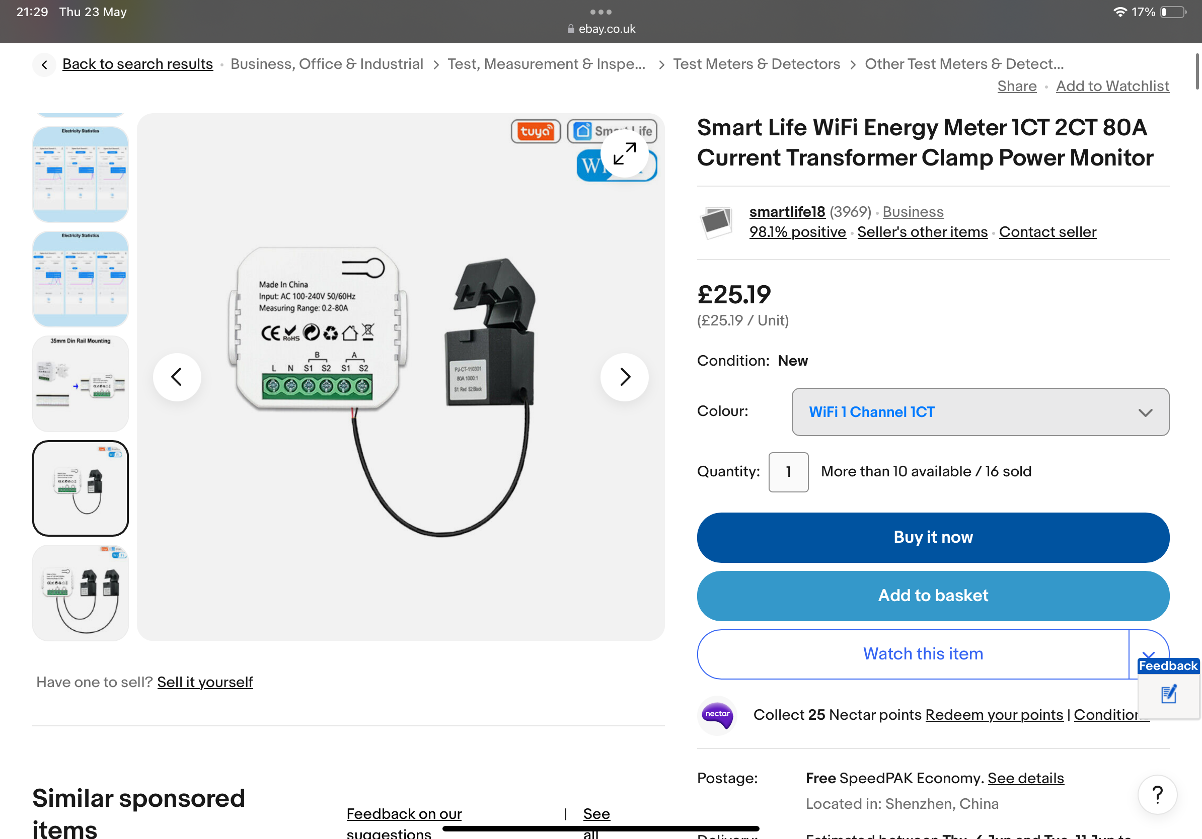

  • #4 21093860
    sanfran
    Posts: 9987
    Help: 962
    Rate: 3003
    Try this one, pal!
    eBay product page for Smart Life WiFi Energy Meter. Screenshot of a Smart Life WiFi energy meter listing on ebay.co.uk, featuring a transformer and clamp.
