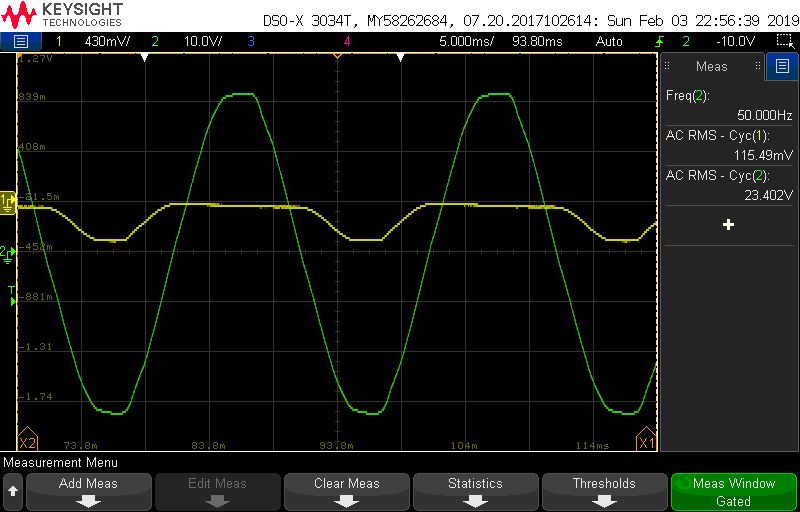

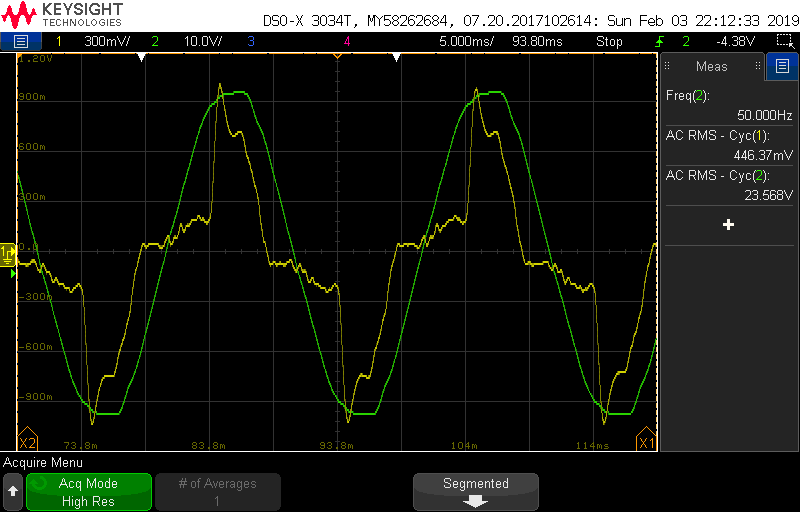

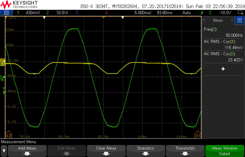

  • Measured loads show nameplate wattage is overstated

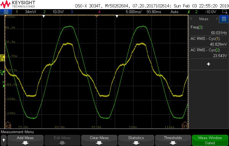

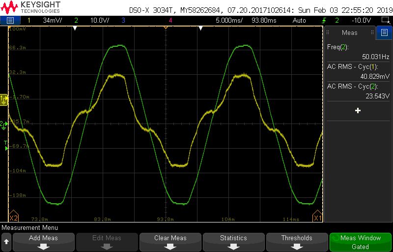

    #15 17751874
    zworecki
    Turns out the meter is OK, and the overcharged power consumption is the light in the basement that someone forgot about ... for a month
    Immediately improve the post above, because I went after the producer and I should not.
    Yes, out of curiosity, I measured:
    Curler "50W" current graph:
    /// 100mV -> 1A ///
    CORAX 3 Energy Meter: Investigating Rising Consumption Trend in New Apartment (Month/kWh)
    During heating, the value changed, but I tried to take a drop along with the meter reading.
    So the 50W according to the oscilloscope is 96W. The counter showed 87W. It is possible that I did not read at the same time.
    45W straightener:
    Calculated 270W. 260W counter.
    The whole house in one phase with all lamps, computers, water pumps turned on:
    Calculated 1.05kW. Counter: 970W
    I have yet done the LED illuminator test no name but I have not saved a screenshot from the oscillation. The massacre is more heater than a lamp.
    Generally, the conclusion is that the values given on the rating plates are some fake ....

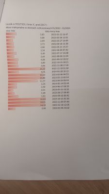

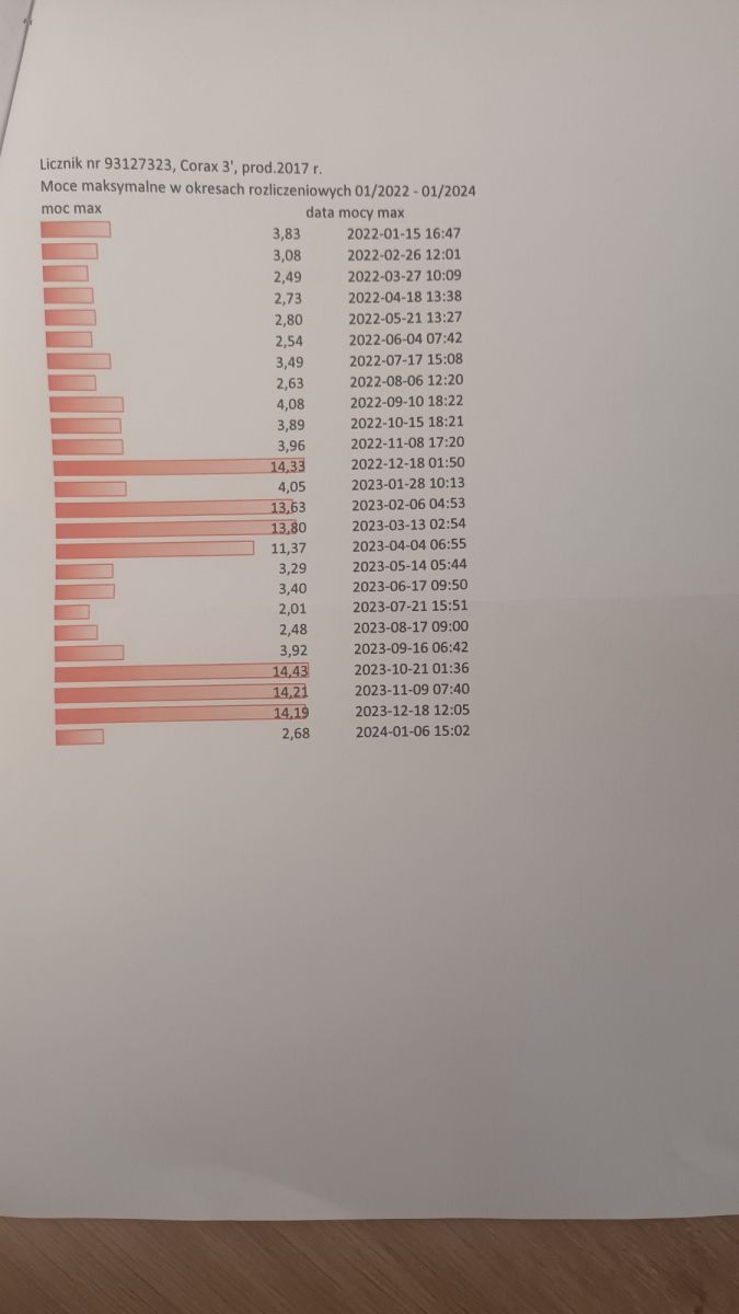

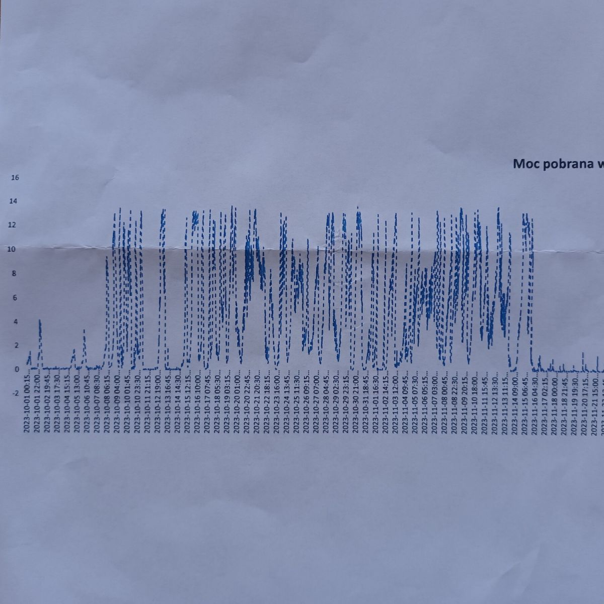

    #25 21240988
  • Recommend external meter verification before reporting fault
    #26 21241509
    ronwald
    Posts: 876
    Help: 85
    Rate: 68
    Before notifying the 'District' that your meter is not working, you should have your electricity measured by an external company that provides electrical metering services. Of course, they should have a class A meter, e.g. FLUKE 435, and have a current calibration of the measuring equipment. For your information, I saved a farmer from paying PLN 72,000 to ENERGA. The energy meter was charging 10 times energy consumption. After 6 months, ENERGA recognised the complaint and checked the energy meter at its own expense. One more remark, when replacing the meter, draw up a protocol, in which the state of the meter with the date and its serial number is written down by a commission.
  • Meter replaced after PGE detected abnormal readings
    #27 21242127

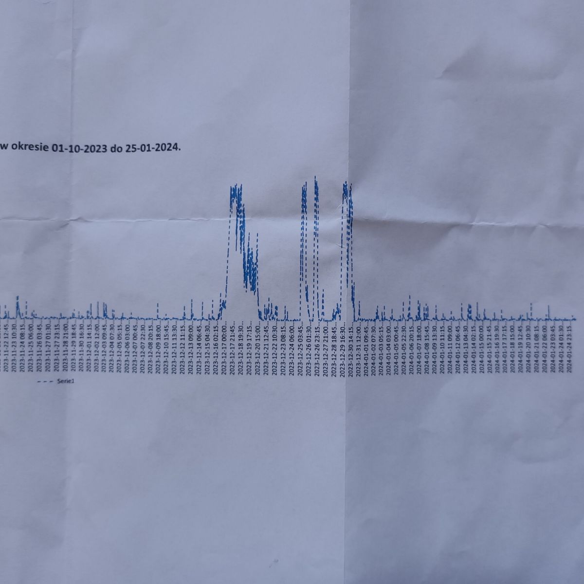

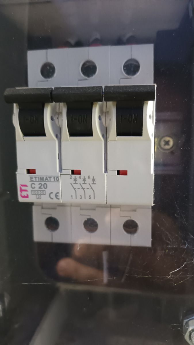

  • Sustained 14.63 kW draw explains high readings
    #28 21242496
    =Grzegorz=
    Level 26  
    Posts: 729
    Help: 73
    Rate: 445
    Mass replacement of counters with remote - this is true.
    Using 15.8.0 registers interchangeably with 1.8.0 registers - this is also true and common practice just needs to be done well.
    The use of used counters is also a practice.
    In your case there is some doubt about the contractual power of 11kW with 20A protection (behind the meter probably max 16A per circuit) and according to the letter you provided on PW you were drawing for a long time (more than an hour) almost 15kW (14.63kW) non-stop with short breaks for many days.
    To your detriment is the fact that this was during October/November/December.
  • 14.43 kW peak nearly trips 20A fuses
    #29 21243591
