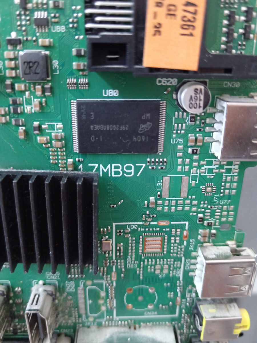

    bogipan
    Posts: 18
    Rate: 16
    I agree! Probably IC U80, containing SW records, is BAD!
    Close-up of a motherboard with visible integrated circuits and USB ports.

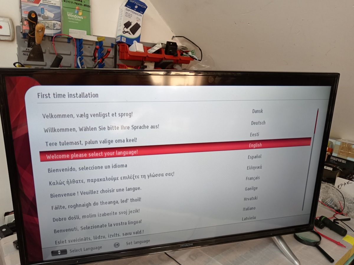

    Added after 33 [minutes]:
    Good news, I found USB software in another service forum, and successfully solved problem! Jeee! TV screen displaying language selection during initial setup.
  • #8 21148865
    bogipan
    Posts: 18
    Rate: 16
    Thanks to original Sw, downloaded from forum "fanzo.org", the problem is solved!!!
