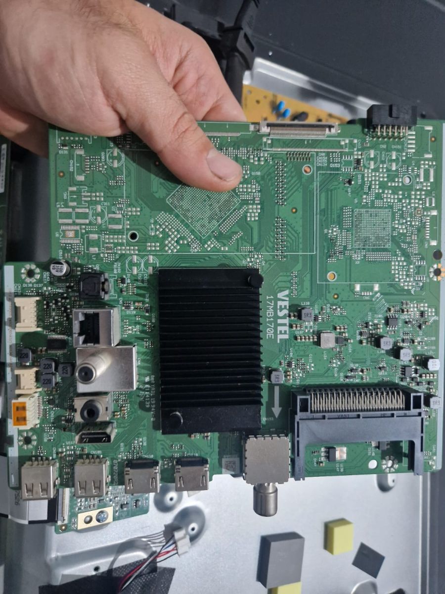

    Good morning, do you have the software for this TV with a 17MB170E motherboard, Hitachi TV model 43HAK5353? Thank you very much. After an update, the screen is black, and the LEDs are working. Thank you.Mainboard VESTEL 17MB170E from a TV held in a handInformation label on the back of a Hitachi device

    Hitachi 43HAK5353 main 17MB170E panel VES430QNDB-N2-N42 ???.

    Level 4  
    Yes this is VES430QNDB-N2-N42Label with model VE540QND8-N2-N42 on the casing of an electronic device

    Thanks. Just put the file on the USB stick? Signed in FAT32 and connect the stick to the TV. Will the update start automatically?

    The update starts when you plug the TV in. After it's finished, turn off the TV and remove the stick.

    I updated it, but it still doesn't show an image. I can hear the audio from the first boot after the reset. The panel shows that the LEDs are working. What could it be?
