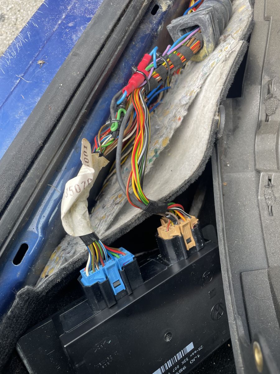

    Hello!
    I have a problem with my CCM I think
    My power windows stopped working and when I tried the door lock button I only heard the relay go off but it didn’t work.

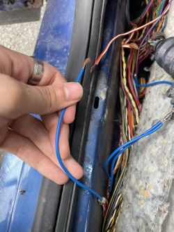

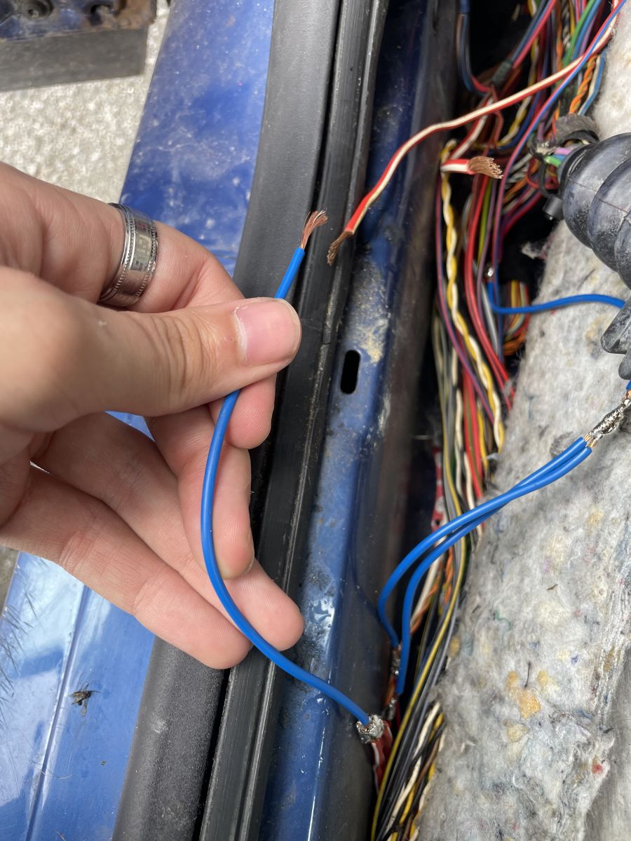

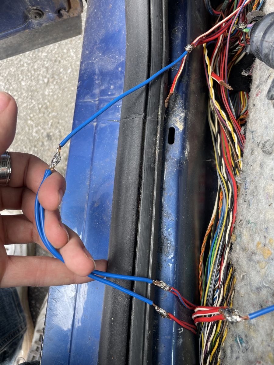

    I dug through the wires and found that the red/blue and red/white had corroded really bad. I cut and soldered the red/blue wires at first before I found out the red/white had corroded but after I did that the windows didn’t work and now the door lock relay didn’t switch.
    Then I saw the red/white and did the same thing and nothing happened. I found out that the metal 30 Amp thermal fuse can also corrode but when I checked that it seemed perfectly fine.
    If you check the images you can see for yourself.
    (Have in mind that I rushed the soldering and and have joined the red/white wires by hand)
    Can someone (if anyone even active) help me out with this problem!?

    Are you still having the problem?
    I think you should join the cables individually, even if they are the same color, and insulate them appropriately. Now the problem is knowing how to pair them.
    Then I would check all the fuses.
