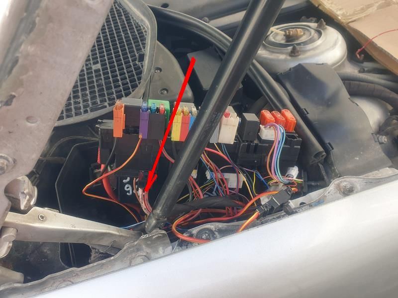

    Hello, vin: WDB2200651A019279 (w220 s320 99r benz + lpg)
    Fault: when replacing the compressor I wanted to replace the relay in the right SAM module, by mistake I took out the motor electronics relay (K) instead of (N), so everything went out in the car (the car was always connected to the AKU). In the main fuses from the modules under the passenger's feet (the so-called cartridge) it fuses and burns the plug of the brown cable (attachment), I replaced the right module with the same number [A 027 545 45 32] and the whole cartridge and the car came alive, almost everything works, clocks , displays gears, reads the key, however, it DOES NOT DUST. Something terribly sypi on the CAN bus, after the first attempt to fire, the key is blocked, the fan is turned on to the max and the ignition can not be turned on until the battery is unplugged. After this you can re-insert the key, the steering wheel leaves and you can only turn the ignition once, then lock the key completely but each time after inserting the ignition key the steering wheel leaves. I thought that "I do not read" the new SAM module, but inserting the old original SAM tape does not change anything.
    symptoms:
    1. The clocks are lit, the airmatica compressor works, everything inside works normally.
    2. Displays the position of the transmission.
    3. When attempting to start, the radiator fan turns on, the temperature from the board disappears, then locks the key and it can not be turned again.
    4. The connected SD sees low battery voltage (7-8V while the battery has 12.3V) so I have to have charged SD batteries to do anything.
    5. SD is not able to communicate with the device when all plugs are plugged in, it freezes while the ignition is on.
    Interestingly: Disconnecting the plug from the right SAM module marked with a red cable and white with a red stripe (photo) allows normal turning of the key in the ignition, however, the gearbox position disappears on the dashboard and the car does not start, however, in this situation the SD is able to communicate and make a short test. A lot of mistakes are poured out on the test. The voltage on these two cables is 12V, the same disconnection of the brown cable does not give anything, must be disconnected these two thick cables (probably go to the ignition?) And then the car "functions normally"
    Any suggestions? Please help. Soon I will try to do a "clean short test", i.e. remove all the trouble codes, connect the plug - I will try to start the car, disconnect the plug and run a short test again to see which trouble codes are there.
    A photo of this unfortunate plug (goes to the red relays, I'm not sure but the brown goes probably to the starter relay)

    Somewhere you probably do not have mass (scorched, stitched)

    That's exactly what I think, however, the brown cable visible in the photo has mass, I bet there is no permission to start because some module lost mass and sheds a lot of errors on CAN, I will be doing a communication test in SD and put a log in the forum. In general, how do you think this brown cable burnt in the picture can be taken elsewhere? I can not find it in wis or epc

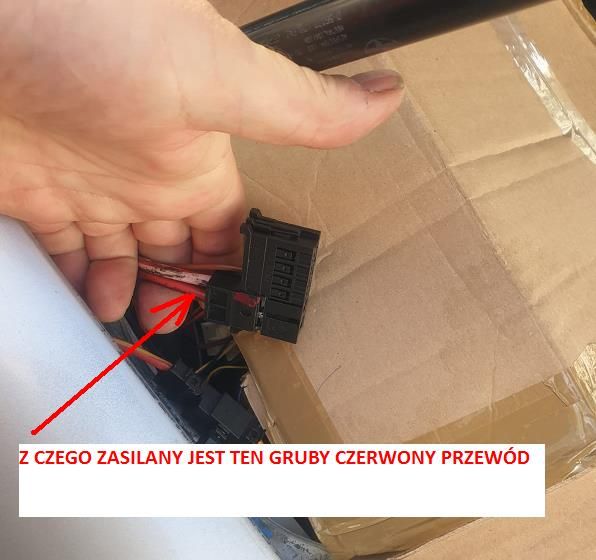

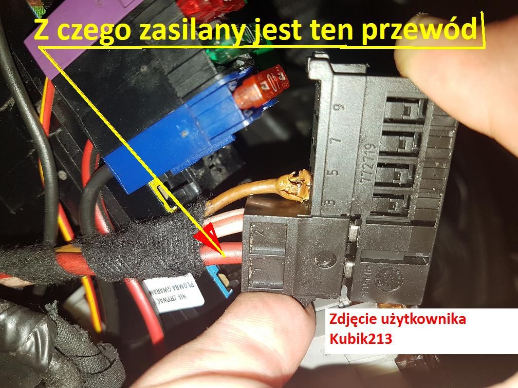

    Same module and car. No voltage on the thick wire marked in the picture borrowed from this topic from Kubik213 (hope you don't get angry for using it) Could someone give me a hint where this wire is fed from? The plug in the front right SAM
    Thank you. Regards.

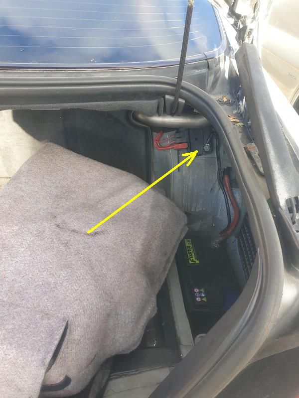

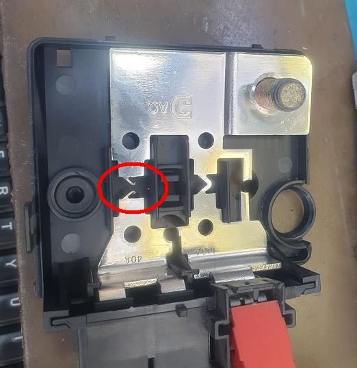

    Maybe this kind of information will be useful to someone, as it's spoiled some blood for me :D
    The power goes from the magic box in the boot on the right side behind the upholstery.
    There are two fuses integrated inside. A 40A burned out
