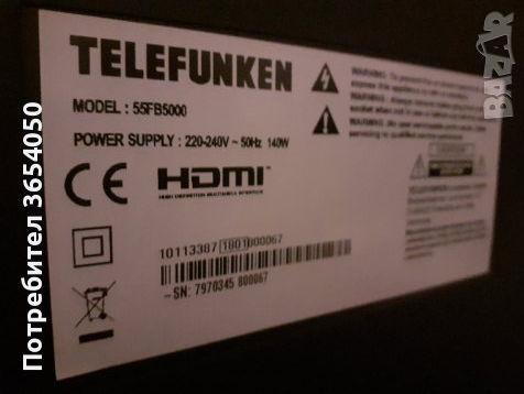

    Mark: Telefunken
    Model: 55FB500
    Chassis (main board, components): 17MB211S
    LCD Screen/Panel (if exist): VES 550 UNDL 2D N11
    More information: https:

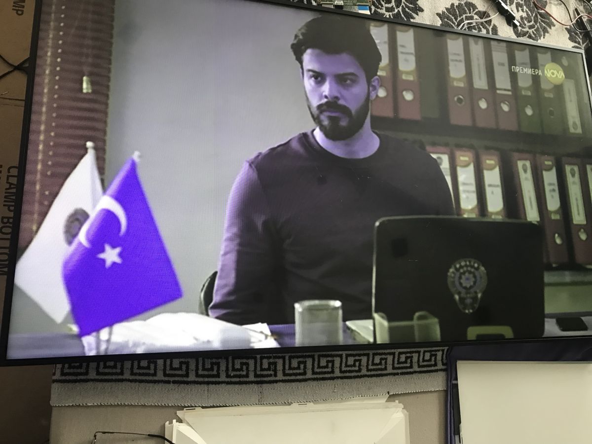

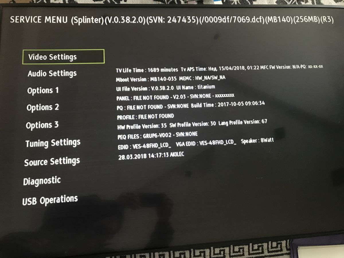

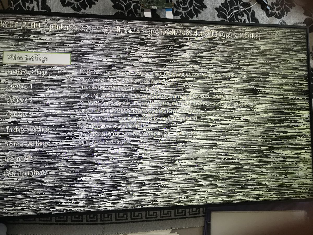

    Hi all I am looking for a dump for a ves550undl -2d -n11 panel. The original board is 17MB211 but it is dead now I have two options to put 17MB82 or 17MB140 (I don't have 211) Both boards need software as the colors are polarized and the picture is inverted. I prefer to put 140 which is from 48 inch TV with panel ves4800unds -2d -n12. I modified the dump with vestel panel editor, but the picture is purple and there is no red color. Apparently it wants an exact dump I will be glad for your help Label of Telefunken TV model 55FB500. Telefunken TV service menu showing video settings on the screen. Telefunken TV screen with image interference. Image of a man on a TV screen with distorted colors.
