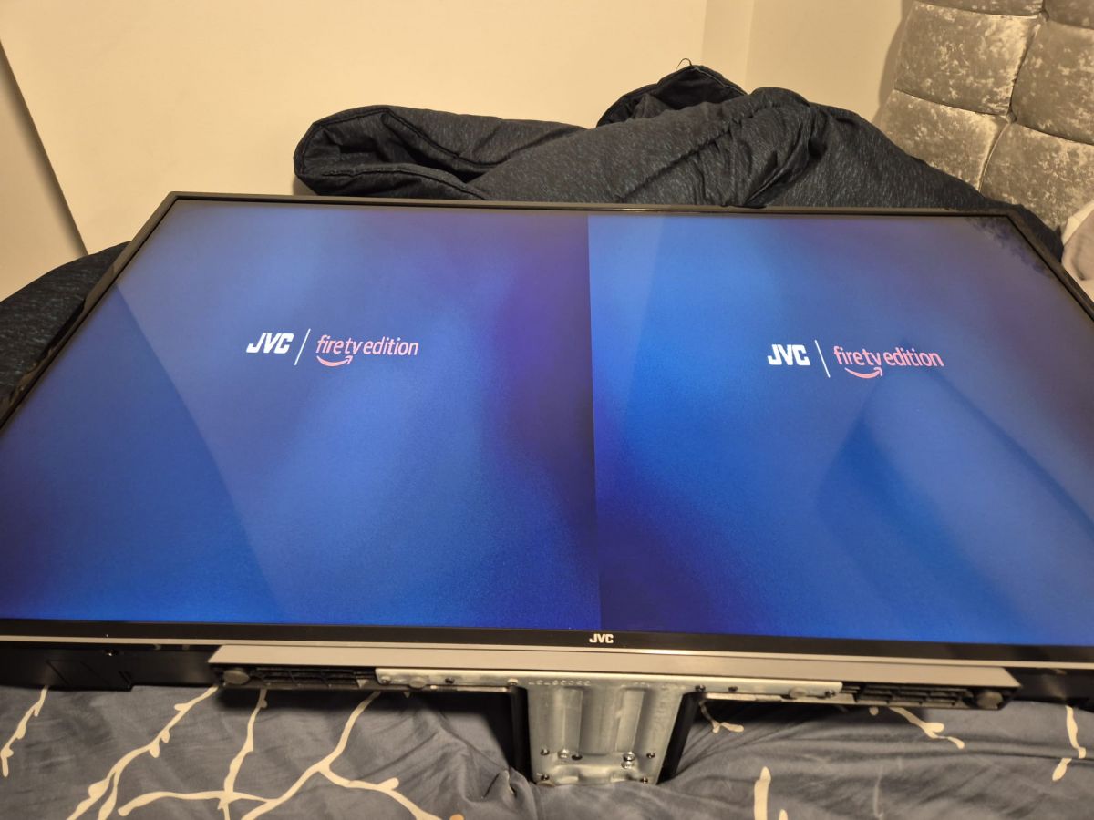

  • Firmware mismatch causing boot loop and duplicated screen
    #3 21355715
    jacox1234
    I've replaced the board with a working 17MB170 board, but now it's stuck in a boot loop and the screen is duplicated. Attached pic.

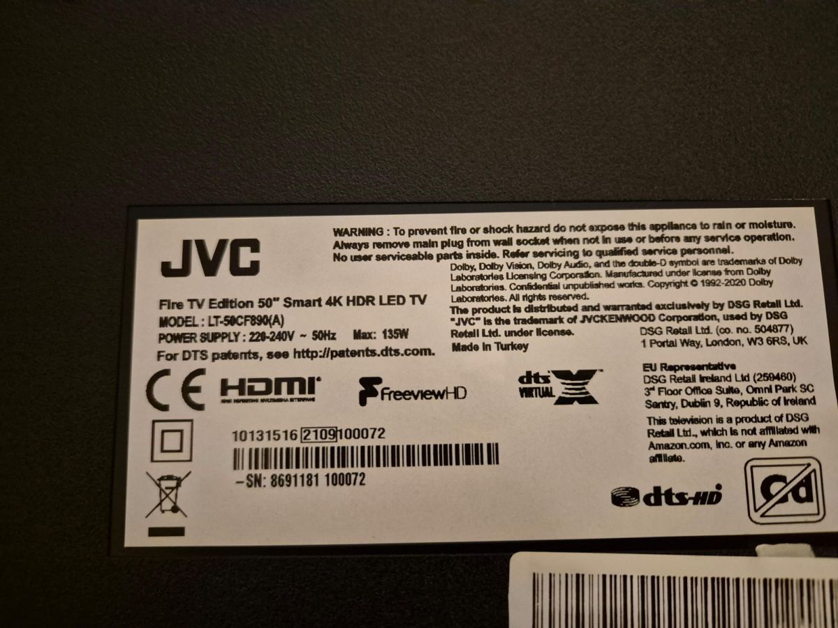

    The donor TV, a JVC LT-50CF890(B) - and the TV I need to repair LT-50CF890(A)
    So I'm assuming the firmware is incorrect? I'm guessing I don't need to change the power board as well??
    Any help appreciated.

  • Vestel barcode identifies matrix type and software
    #5 21355833
    lisek
    Service technician RTV
    Posts: 39954
    Help: 6344
    Rate: 6872
    For the replacement of Vestel plates > the so-called BARcode (8-digit) is important.
    - used to be a sticker, now QR code
    - tells you the matrix type and software
    Not the description of 17MB170
    - is a description of the chassis, pcb (bare board) which changes its "purpose" after adding RC, circuits and jumpers ..and FW (firmware)
    Power supplies for models, under matrixes (their lighting) are described similarly
    Probably in both models different matrices
    - please write which one in (A) and which one in (B)

    This is the same subject Link
    - you can see the barcode on the power supply and main boards
    Or look at the board descriptions / different matrixes Link_ LT-50CF890 main
    JVC LT-50CF890 50" TV 17MB170 (23708791) SCREEN: CV500U2-T01
    JVC LT-50CF890(C) , TV 17MB170 (23741628) Screen: VES500QNDP-2D-N43
