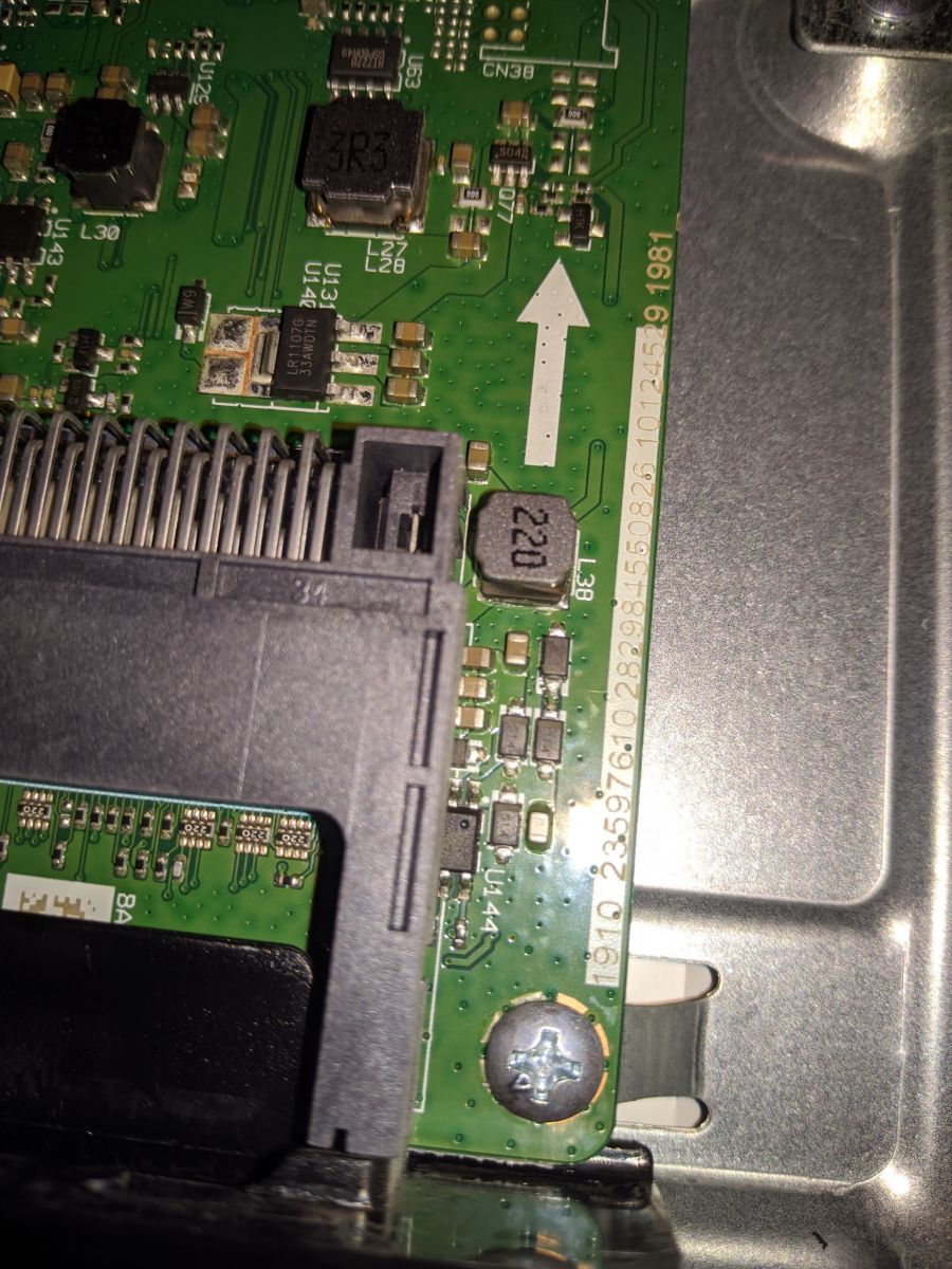

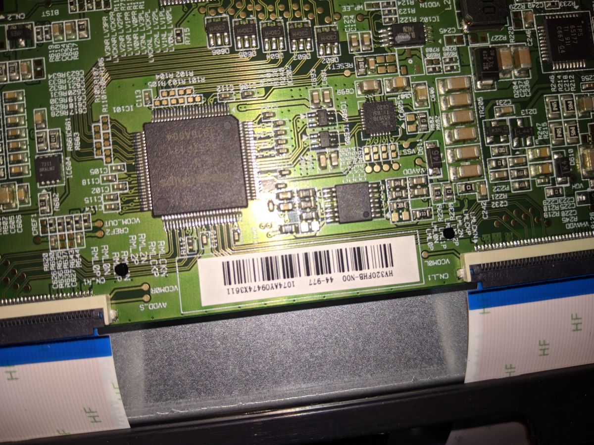

    Please provide the matrix model and insert a photo taken from the TV, not from the Internet.
  • TV identification numbers from posted photos
    #3 19994688
    janek0113
    Posts: 9

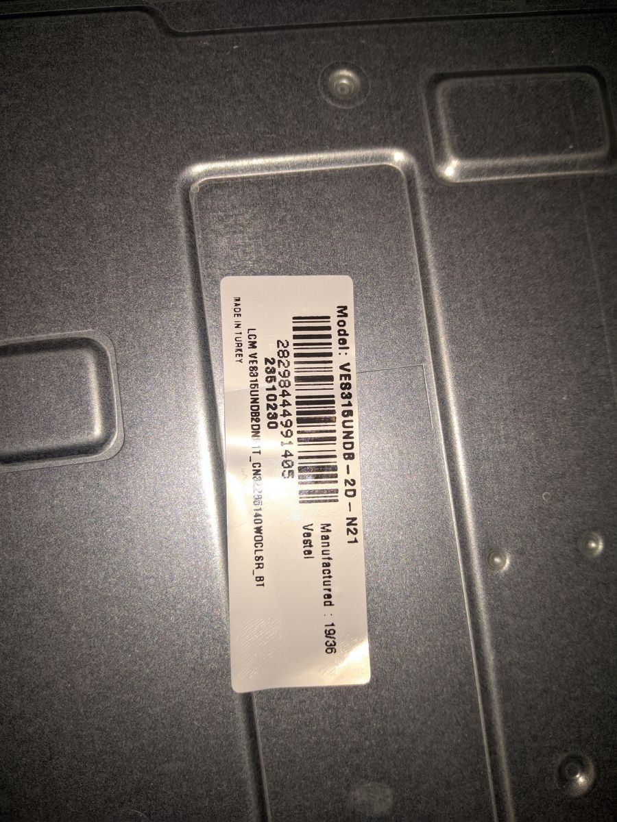

    @ elmo071 thanks for letting me know. Here are pictures of the TV. The number should be 1910 23597610 282984550826 10124529 1981

    @elmo071 tutaj VES315UNDB-2D-N21
