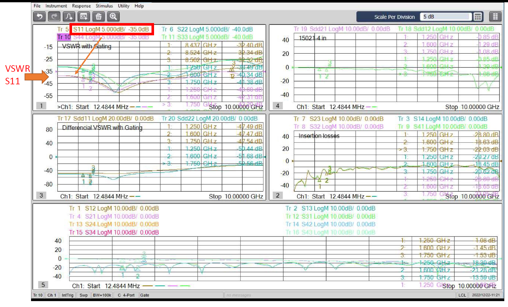

    I got VSWR(S11) measurement from a molex flat cable 4 inches long and I want to obtain S11, so I do : S11 = (VSWR-1)/(VSWR - 1) but the result I got is not consistent...
    Molex cannot give me the S-parameters files so I want to extract data from graphs.
    My aim is to obtain S11 and then use FFT to get TDR response on it so I can after get TDR of impedance along the line.
    My experimental data are the one below :
    Screenshot showing VSWR and S11 charts for a Molex cable across the 12 MHz - 10 GHz band.
    I import the value to Matlab using a tool to extract the data :
    Graphs and data of S11 and VSWR for Molex cable

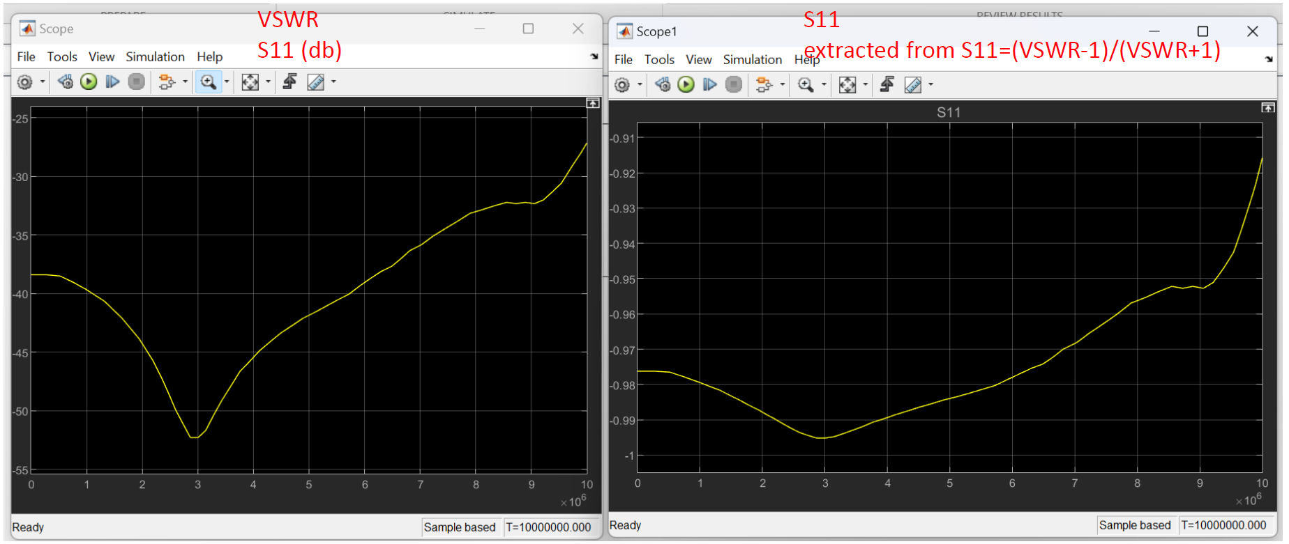

    and after extracting the magnitude from the db and done the math in Matlab and I got this :
    Comparison of VSWR and S11 extracted from VSWR plots
    Normaly S11 would be something periodic along the frequencies like the one below but it is not the result I got ...
    Graph of S11 parameter measurements on a frequency scale from 12 MHz to 10 GHz.
    Any idea ? Thank you !

    WSWR is S11 and not VSWR
